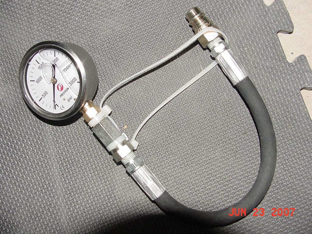

You should install a gage in the hyd system and monitor and trouble shoot the hyd system.
Check your relief pressure for sure.
Hyd hoses are tested at 4 times the operating pressure when new. Old hyd hoses could burst at any pressure depending on the condition of the hose.
It would not be to hard to twist the loader arms trying to lift something from one corner or edge.
Someting like this.
