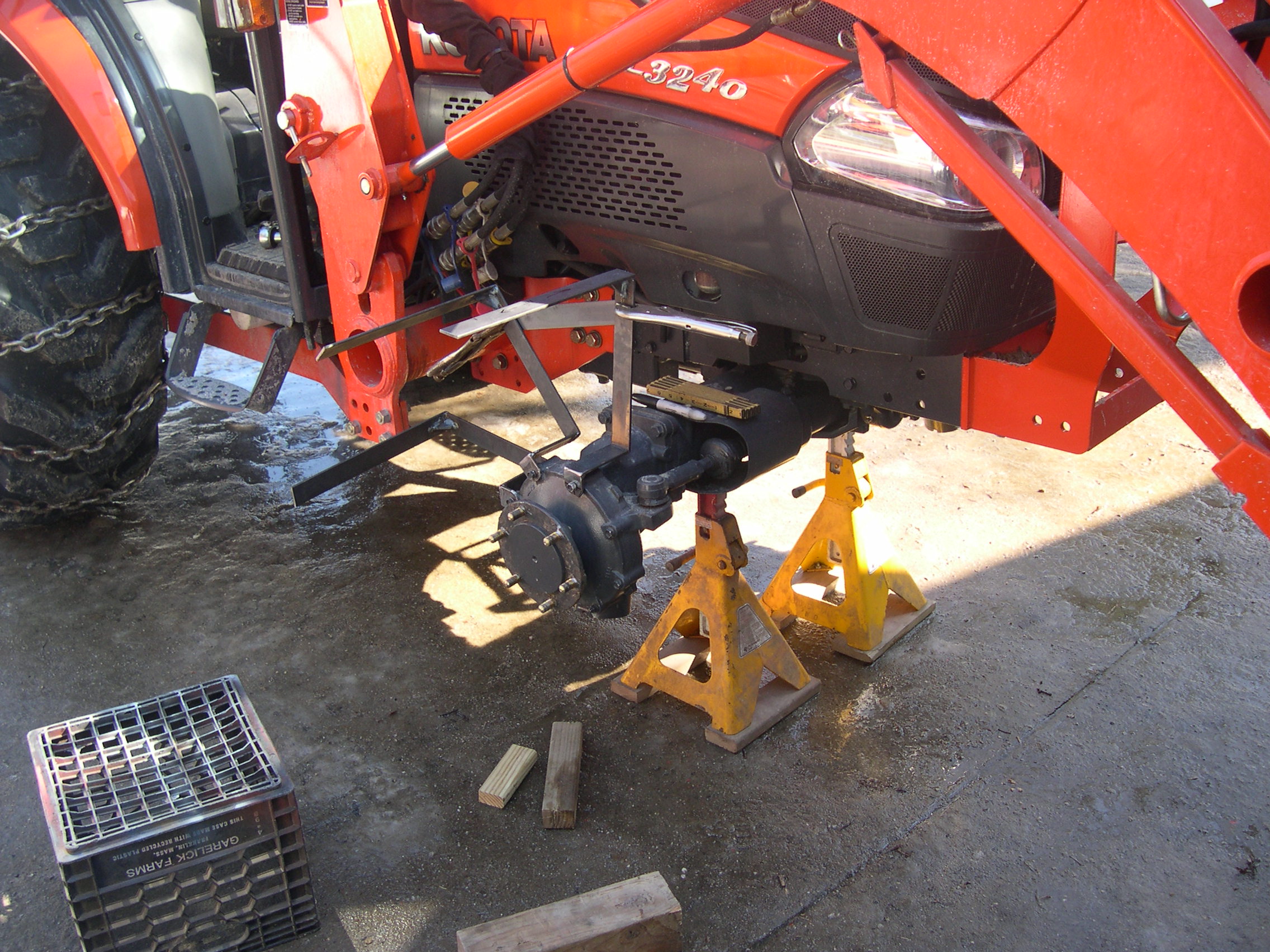

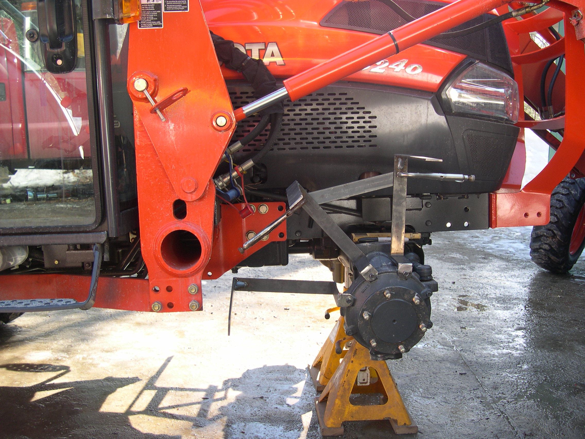

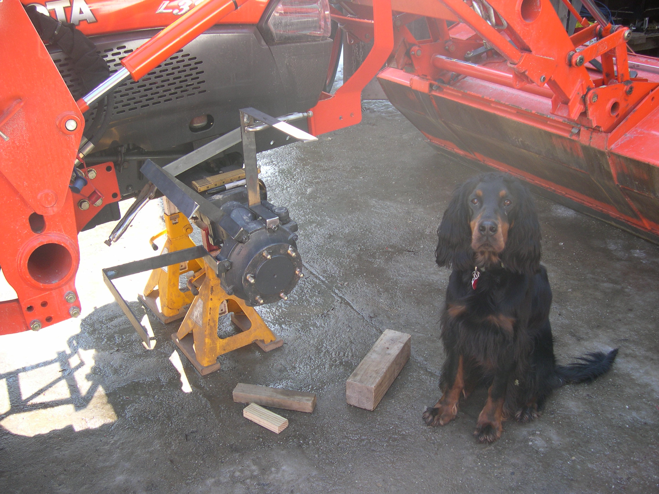

Thanks for all the pictures and comments. Attached are some pictures of what I came up with

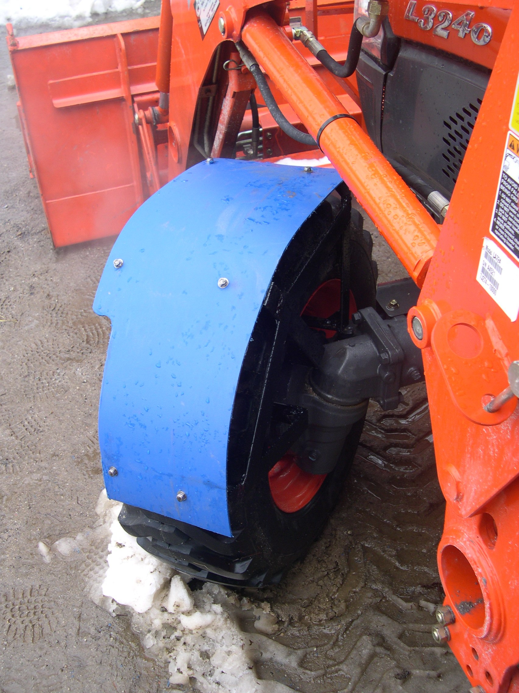

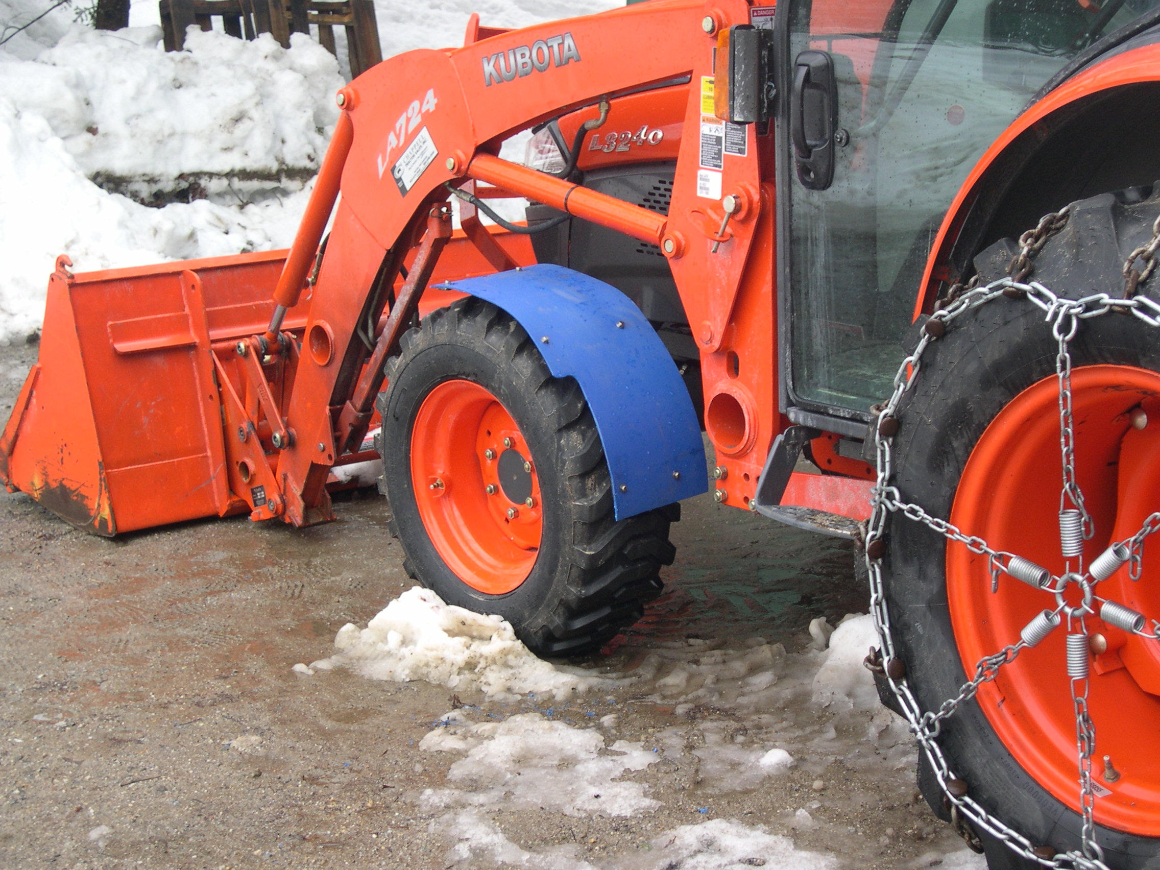

A couple more pictures. Come spring I will have to do something about the color.

Shouldn't have done it!
Nope. Your dog stole your thunder:D. He or she is beautiful.:cool:
OK now that I said that I'll add you did a very nice job on the fenders. Good idea to use the plastic barrel. Get some plastic shaker can paint and you'll think they came with the machine. Nice work!
   / Kubota front fenders #15
Good lookng job. Cute dog. Life is good. Congratulations.
   / Kubota front fenders #17
The color is fine for my NH! Wouldn't have to worry about the color changing as they got blasted with mud. Nice idea..Looks like the same sort of notch would be needed for mine to make sure the loader had clearance. Thanks for the pictures...oh yeah I should probably worry about getting a cab first! :)
