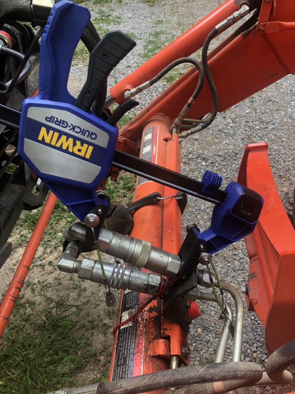

Hi, my Kubota M7060 has flat faced hydraulic connectors for the front loader hydraulic hookup. I have a lot of different implements, and EVERY time I go to change them out the hydraulics in the attachment are so pressurized I cannot connect the hoses. It does not matter how much I try and relax the pressure by working the thumb switch and the front loader hydraulics there's always pressure in the lines. When I disconnect something I'll just for grins reconnect it and it always goes on easily but by the time it cools down then I get back the next time no way I can reattach it. I have to back out the hydraulic lines and bleed off pressure then put everything back then I can attach the implement. It takes an hour or more to do something that should take 5 minutes. Does anyone have experience with this? What are my options here because this is intolerable and it's affecting my work day. Thanks!

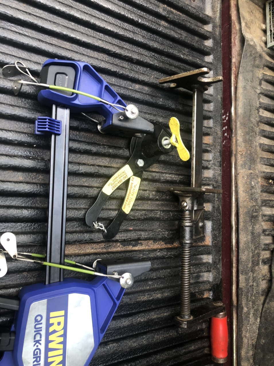

3 options
1. buy one of them clamp tools
2. Change them out to AG style (iso 5675) couplers that you can manually relieve by popping the poppet or ball
3. Change them to flatface that are designed to connect under pressure.
Its not a lack of bleeding the hydraulics thats causing fits. Its likely the temperature change pressurizing the fluid

That's why I'm suggesting that inducing a little air before disconnecting might alleviate the high pressure fluid buildup.

Are your front remotes activated with a manual valve or push button?
I shut my tractor off and relieve the pressure on the loader with the valve buttons prior to hooking up too. I can hear the solenoids activate. Try this - put a re-useable sip tie or strong rubber band to hold the button in when you reconnect the new implement.
I have a hydraulics flow ON switch wired into my circuit for running some constant flow attachments. I just toggle it on (with engine off of course) prior to hook up. The quick connectors work 99% of the time this way for me unless my attachment has been sitting outside on a hot sunny day.

Always connect the couplers together when removing any attachment with flat face couplers. A change in temperature is enough to pressurize the system.
