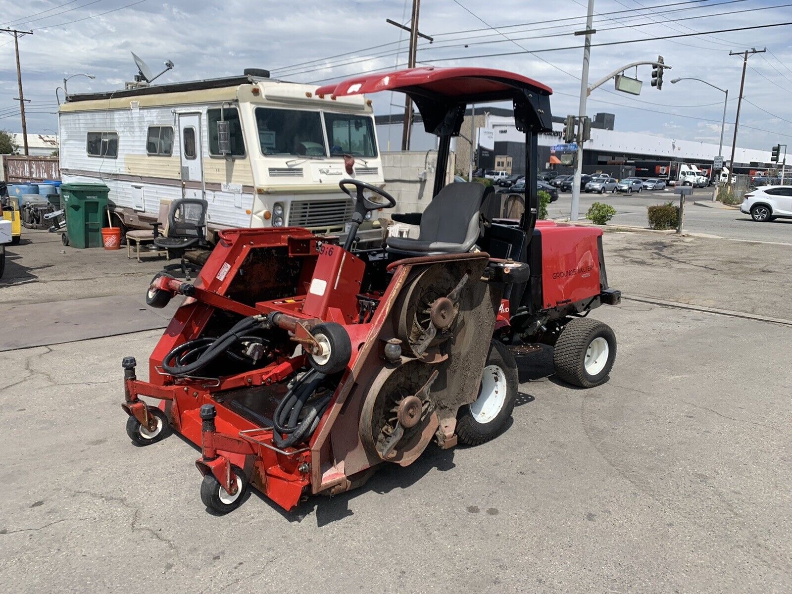

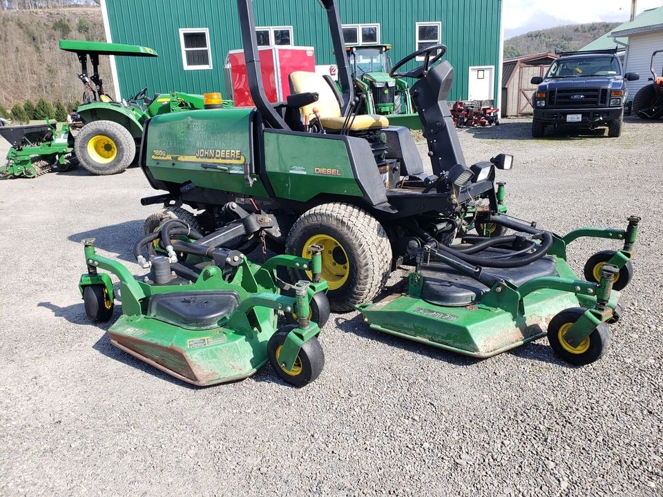

Why? I see them used on steep banks round here. 4WD and wide tires.
Heck, the Kubota WAM was my F-3680 with a 100” tri-deck.
Ain’t no big deal.
This JD WAM has really big leading & trailing wheels/tires that would fare much better on holes & bumps than a Kubota F’s tiny wheels.
Same with this Toro.
Looks like they both have air ride seats, too.
Even the Kubota F-3680 WAM 100” has bigger leading edge front wheels/tires…..

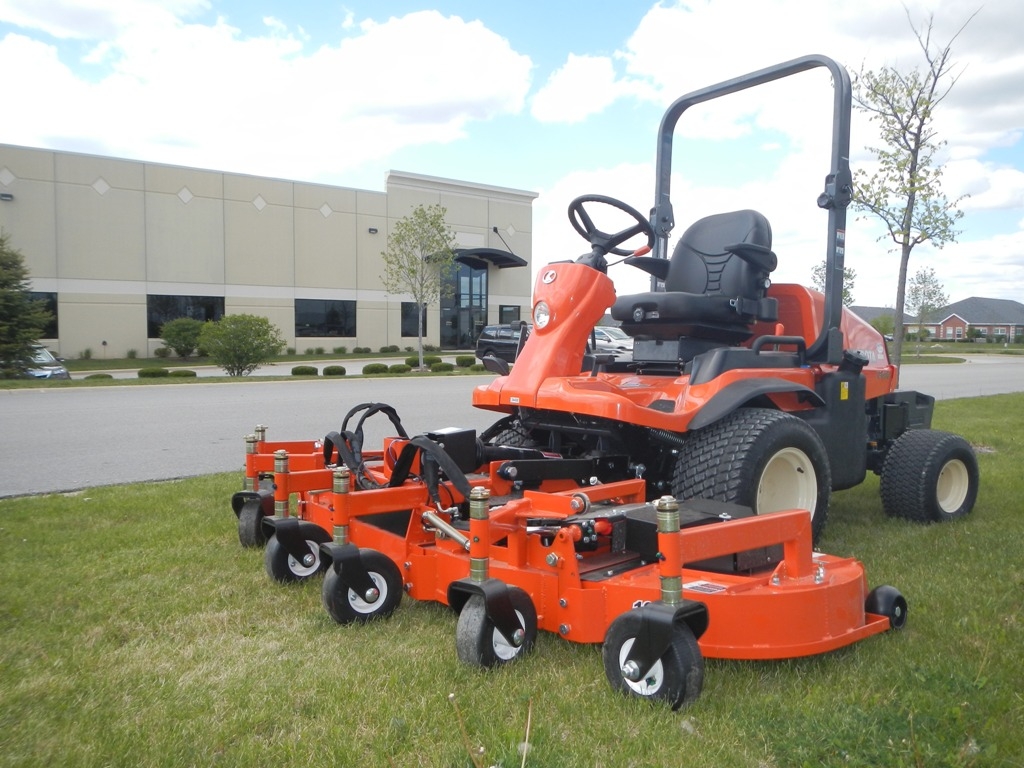

I sure wished that 100” Kubota deck was still available.
It gave trouble tho evidently.
IDK why Kubota got away from those Big Heavy Casters & deck wheels like came on 100”

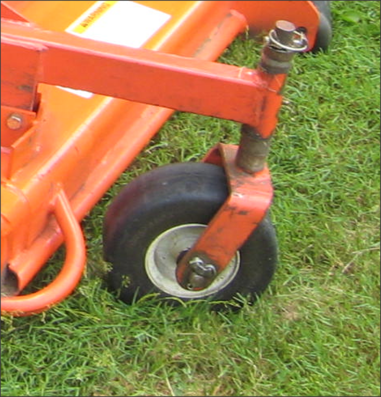

The gauge wheels in my F3060 72" Rd deck are 9" outside diameter.
Would you know how large are the wheels in the three mowers shown in you photos?
Yeah but there’s only 2. They are very small. Rear wheels are small plastic rollers.

My front deck wheels are so small, I’m surprised they’re inflatable.

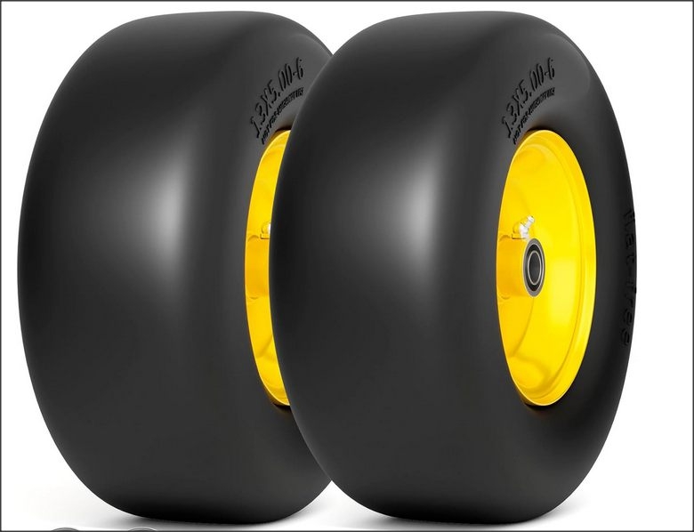

Yes 15" should do it, but the dealer price on those is almost $300 each and so far I have not found much competition in that size.
Still looking.
Aftermarket zero turn 13" solid rubber tire front wheels are easy find at around $100 each.
At least they look pretty good in a photo...
Anyway I am in no hurry and am fine with 9" Gauge wheels for now - many much more important projects to finish first this year.

Those tiny little wheels would be ok on a smooth golf course or a manicured lawn :LOL:
Definitely Not on rough ground.
