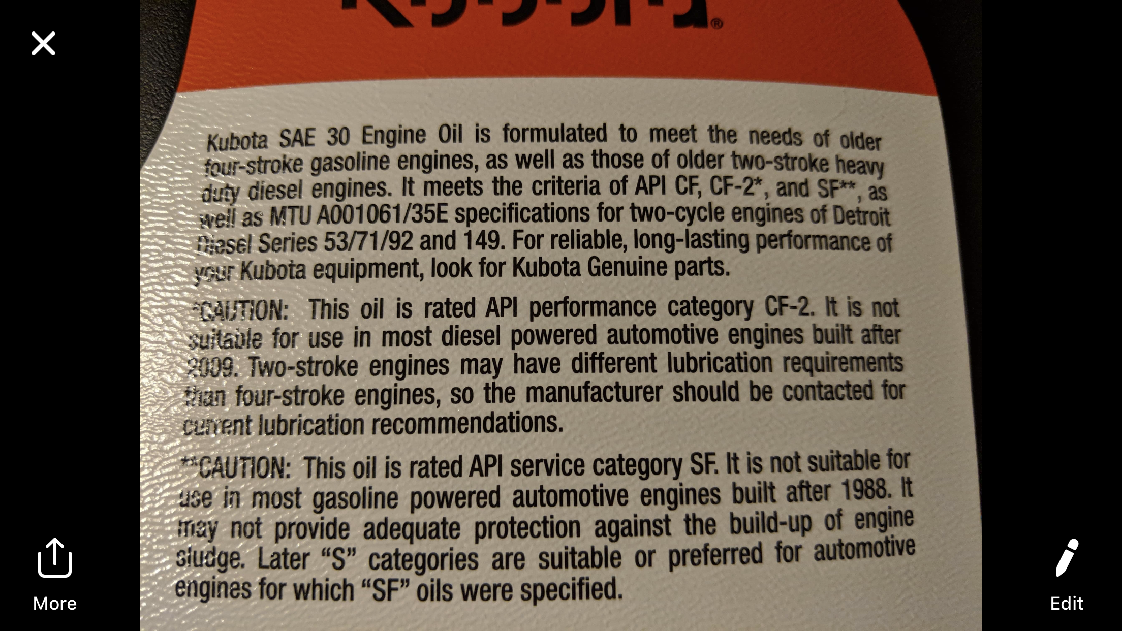

Went to the dealership to get everything for the 50 hour service on my L2501. The guy at the parts counter said Kubota changed the oil from 10w30 or 10w40 to Sae30 now. Both are Kubota brand oil. I have been getting the 10w for the m7040 for a few years now and that痴 all the dealer I use to go to had. I don稚 have the manual on the tractor handy and was just wondering in this is a new change.

I just checked the bottles and it is cf-2 for use in older engines (not what Kubota recommends). Supposedly this is all that dealership sells and that is all they had on the shelf. I also asked for super UDT and the had to go in the back to get it because I was like the third customer that has ever asked for it. I just find it odd that the parts counter would tell me this when I had everything written down that the book calls for and I bought the tractor from them. BC222634-E8B0-4883-9407-54A2CFAF27C1.png

Like others have said, pay no attention to Kubota. Even the owners manuals are outdated. What the dealer sells you in the Kubota jug, is something your manual tells you not to use, LOL
I run either Shell Rotella T6 or Petro Canada Duron-E synthetics. Only thing you need to look for is you want the one that is labelled CK-4. It is backwards compatible.
Some new emissions motors (that don't apply to our emission motored tractors) call for a new oil category....called F-4. It is not backwards compatible and you don't want this for your tractor.
These will be shown in the little donut symbol on the oil container.

Scook - the first line on that bottle reads " for older four stroke gasoline engines and two stoke diesel engines". Looks like your dealer is clearing out some old or slow moving stock.
Like others here have stated, there are better options for engine oil. But not for SUDT I think.
