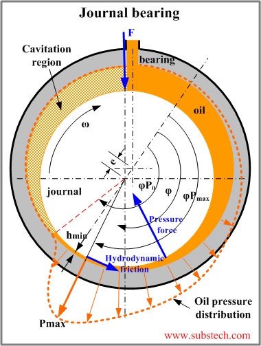

Remember this is a Caterpillar engine oil recommendation. Oil viscosity requirement depends on the bearing to journal clearance. Wider clearance, higher viscosity oil. Auto engine shift to 5W-20 and 0W-20 oil came with improved machining capability allowing them to reduce bearing clearance. My M7 workshop manual gives the factory specification crankshaft journal to crankshaft bearing clearance as 0.0012 to 0.0029 inches. An engine built to the tighter clearance could have cold start issues at 0.0012 clearance with heavier oil. I use 5W-40 synthetic in mine. My Cat mini-excavator has a very loose engine and gets 15W-40.
What I am trying to show is what a really good viscosity chart looks like, and this Cat chart does just that. I am confident using that chart for all high speed diesel engines, clearances and loads are similar between manufacturers. My point is that Kubota's chart in my manual is archaic, and flat out wrong. The Kubota manual still list the use of single weight 10W, 20, and 30 weight oils! And as I stated earlier, the Kubota manual approved use of 15w-40 at temperatures below 32F, inclusive of -10F! That is wrong and poorly written. Philip.

Okay, having helped create the Cat SEBU referenced, it’s intended for Caterpillar equipment. Cat, selling equipment everywhere in the world, has to contend with availability of lubricants everywhere, including extensive sales to the US military who has a set of lubricants they stock and dictates you will use these or you won’t do business with us. I fought some of the specs that went into that SEBU for my equipment and with my crew discussed saying compartment lubed for life rather than change factory fill to the lube available in many parts of the world.
Having said that, the Cat SEBU would be more appropriate for Kubota engines than what Kubota publishes. After all the Cat C3.8 is the very popular Kubota 3.8. And the Cat SEBU does cover Cat by saying to use an oil with the low end viscosity required for your temperature. That was the important point I was trying to stress. In my climate where winter temps are often below 0°F, 15W-40 will not fill the small gap on the loose side where the oil input hole is located. I’ve seen cold start test bearings comparing 5W-40 synthetic (no wear) and 15W-40 mineral oil (extreme wear) and know I don’t want 15W-40 in my 3 important Kubotas. The RTV and GR2120 get 15W-40 like my Cat mini-excavator and the Cummins engine in my Case combine.
