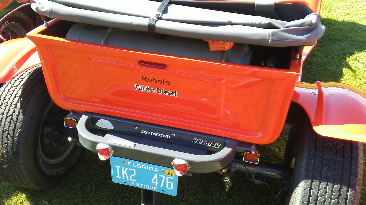

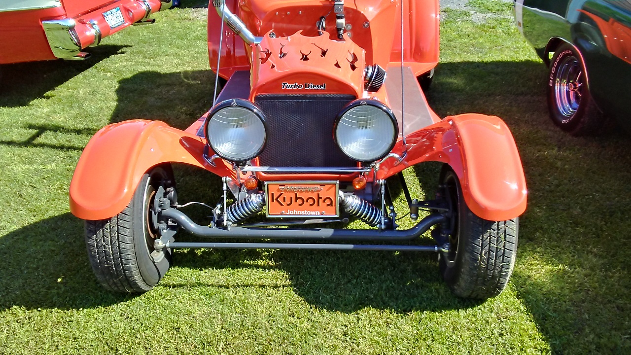

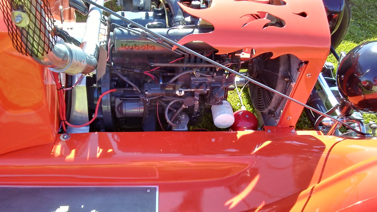

Went to a local car show today. About 270 cars made the show but I saw one really RARE car. It is a street rod made with a Kubota diesel engine mated to a 5 spd. manual trans. The man that built it lives in FL. but the owner has residence in FL and NY and brought it to the show. Claims to get 50 MPG with it and has a top spd of about 75. I thought it was very unique. Here's a few pics.

Definitely a conversation piece but I wonder what the drivability is like. Engines designed for constant speed operation often have poor or inconsistent response at different rpms and typically don’t perform well in an automotive application. Mainly due to governor setup/ design and cam profile which are not easy to change.

The owner claims it drives very well at highway speeds. It is mated to a 5 spd. manual automotive trans with a custom made adapter plate and a narrowed ford rearend. I didn't ask what clutch it has but I will take a few more pics and ask more questions if I see him at another show. Claims at highway speed RPM's stay around 2500. Someone put a lot of time and effort into building it.

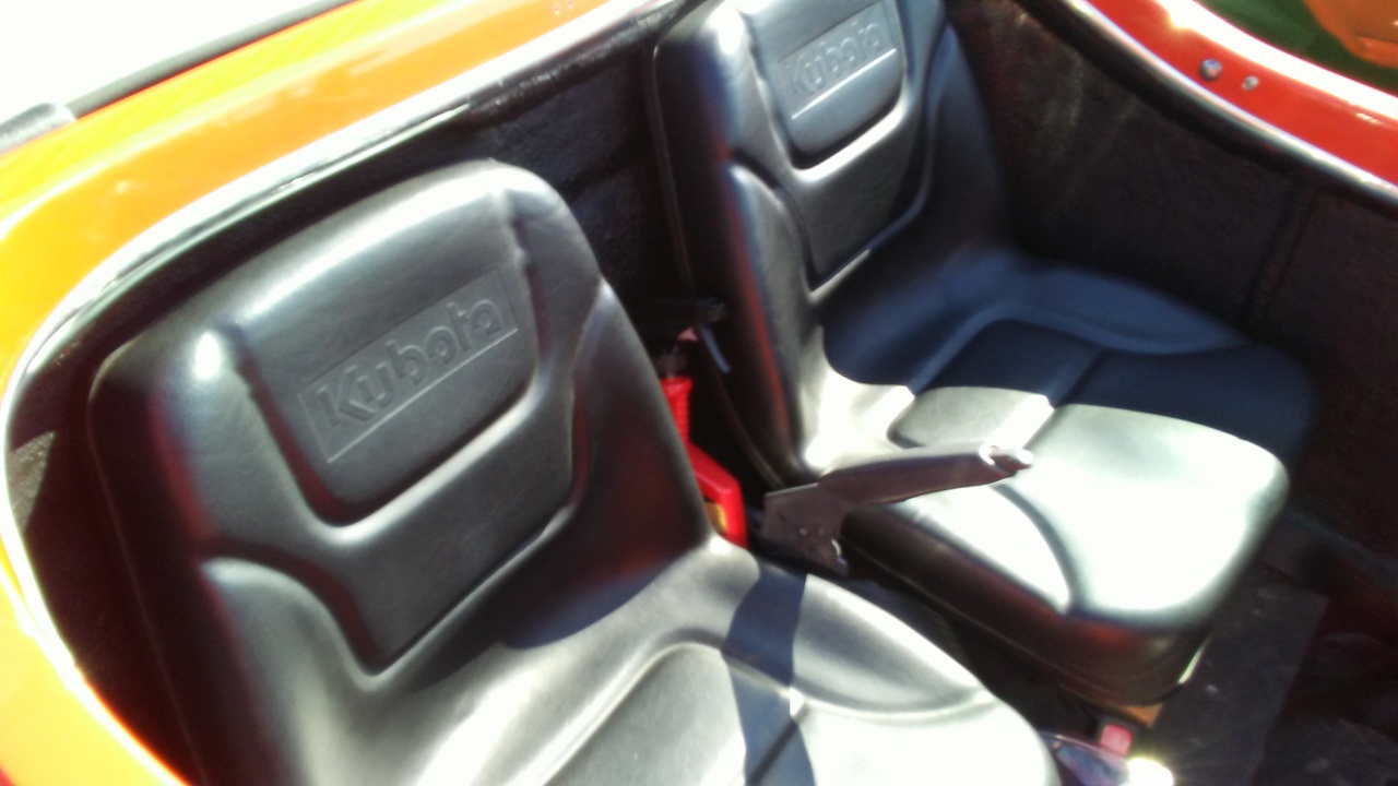

The seats made me laugh. Any pictures of the entire car?
/ Kubota Car #6
I wonder if they are tipped forward so you are constantly sliding off.
/ Kubota Car #7
And looks like he used those "fine" Kubota seats. Your ***** would be hurting after 100 miles in that thing. But love the car.

Where it was parked I couldn't get pics of entire car but I'm sure I will see it again and get some. Today was the second show where I've seen it. Didn't have a camera or my phone last time.

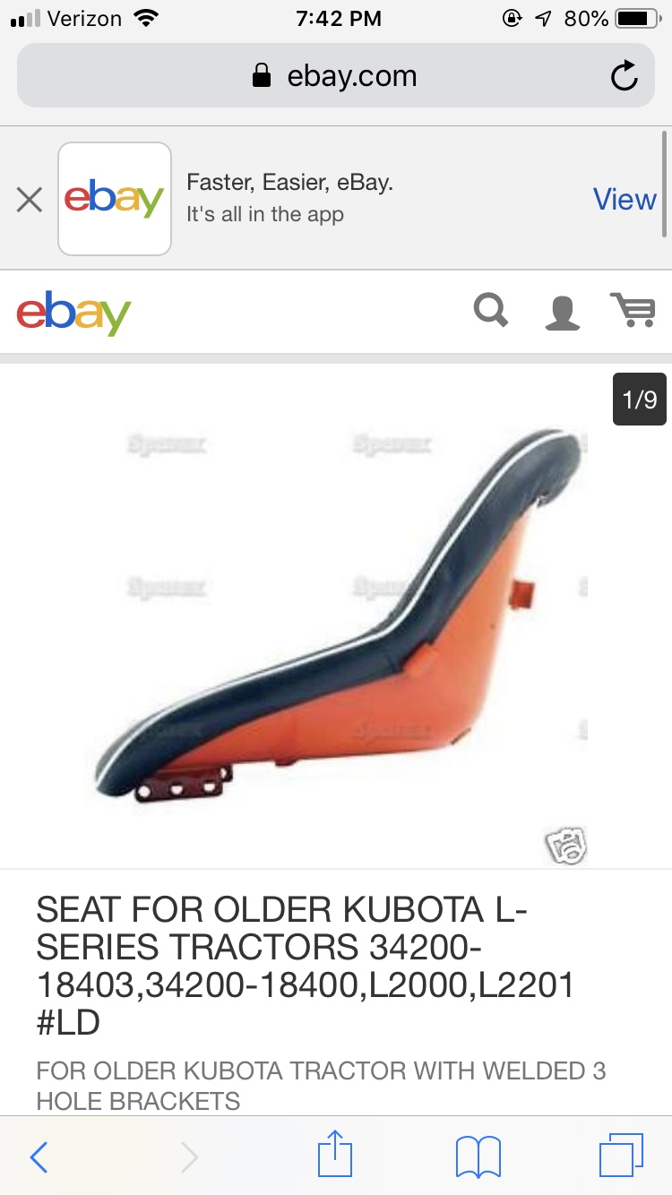

Those seats don’t look bad. They’re nowhere near as bad as these were. IMG_6908.JPG

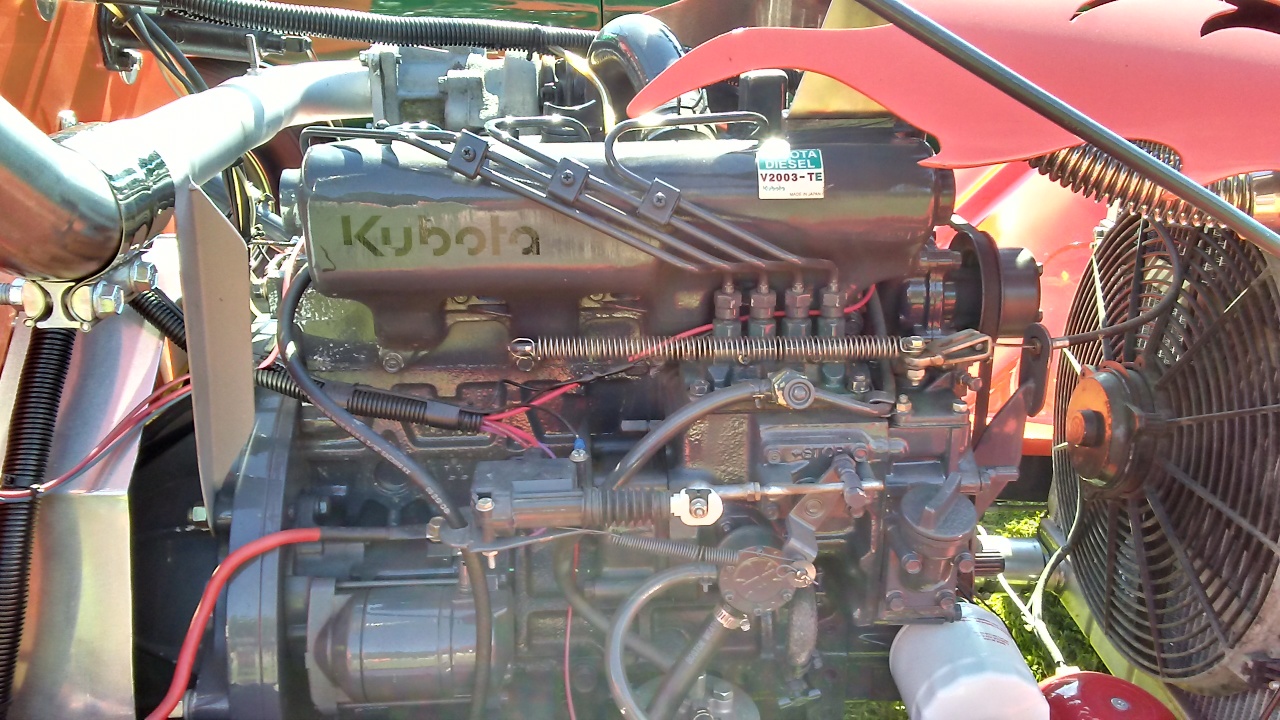

What is the horsepower of that engine....something like 40hp?
/ Kubota Car #19
Probably. It’s a 4 cylinder so it’ll be upwards of 30. Equipment engines don’t make good car engines. A car engine in equipment swap would be even worse. There’s a huge difference in the continuous duty hp equipment has and the very brief HP cars and light trucks have.
