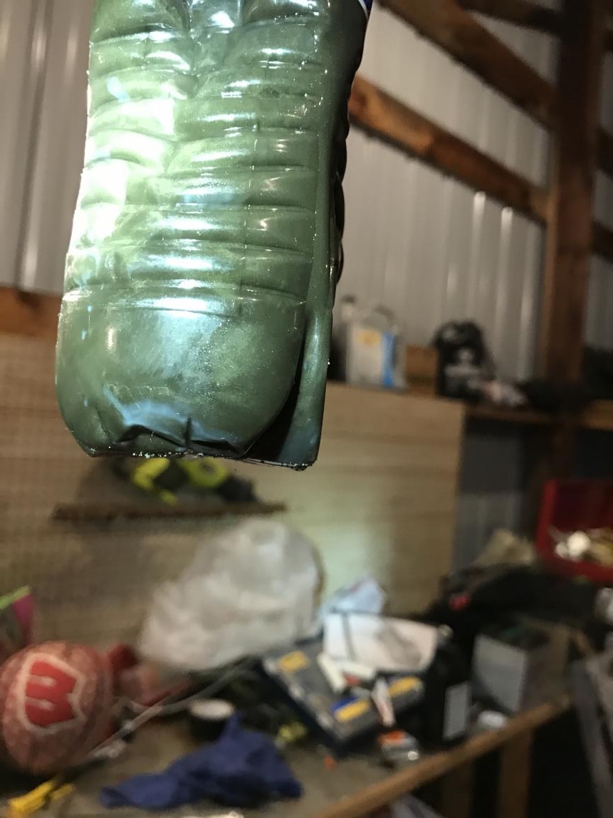

while checking the reduction box and gearbox oil levels on the blower I noticed that the gearbox oil looked brown and milky which I figured meant there was water in the oil. So today I changed out the gearbox oil, I will attach a picture of the oil that came out.

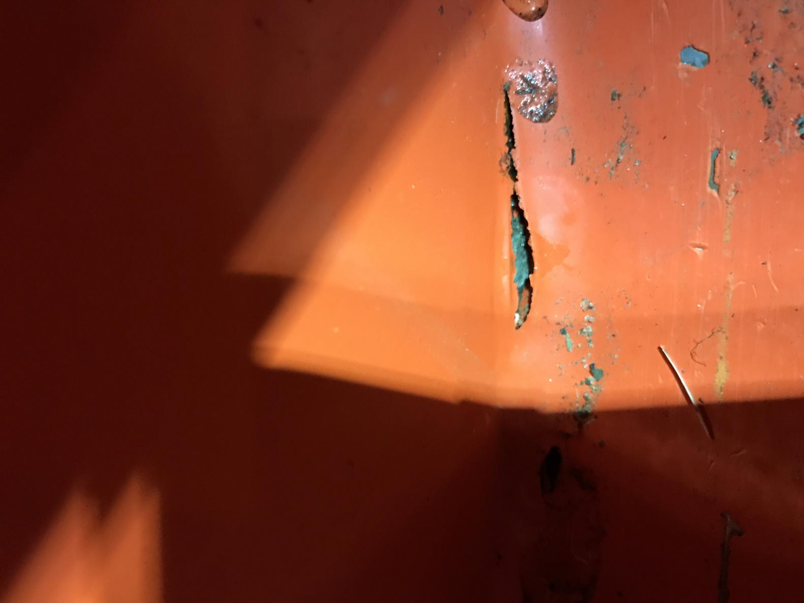

While changing the oil I noticed a defect in the weld on the fan housing and I'll attach pictures of that as well.
The snowblower was new this winter and probably has 5 hours on it. I'm going to give my dealer a call but wanted to post here also and see how concerned you guys would be about this.

That broken metal should not be there, where EXACTLY is it???
Is the middle image of the point where the scraper lip on the impeller paddle
meets the rear wall of the impeller housing??
About the oil its hard to tell or see what you have there, no offense.
Yes the crack is where the rear wall meets the impeller housing.
It's hard to get a good picture of the oil but it is a different color than the gear oil that went back in. With only 5 hours on the blower i figured it must be contaminated.
