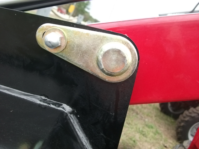

I'm specifically referring to the application where a pin is supported only by a thin (3/16" for example) piece of material. Sure grease will help here too, but with a bushing, you have a much more effective surface area to hold grease. w/o a bushing, grease won't have much chance of staying put.

Pins are fixed and do not need grease between it and the housing bushing. The pivot area does and this is the cylinder rod end and the loader arm bushing. The pin bushing gives a larger surface area to absorb the forces incurred when using the bucket/loader. Not having a bushing there invites premature wear. Mahindra may have seen it unnecessary because they have a 3 point pin mount and concentrate that force on one side of the loader bracket. Probably a cost cutting measure, how I am not sure, seems to be a more costly pin to make.

You get one point for using a cool word, "obviates". But the pin does not rotate in the bucket, so it only needs to be able to stay in place, hence no need for replaceable bushings or grease between the pin and the bucket. The cylinder rod end rotates around the fixed pin and that is where we need grease.
On the ML205 for the Max 28, the pin is drilled, then cross drilled, so there is a zerk in the end of the pin making it super easy to grease. On the ML202, the rod ends are drilled, which is more traditional. I prefer the ML205 sort of pin as it allows really quick greasing without raising or lowering the bucket trying to get a straight shot at a zerk as you have to do on most loaders.

OK, I see what you're saying- the pin I was looking at don't rotate in the plate. Thanks for clarifying this for me!
