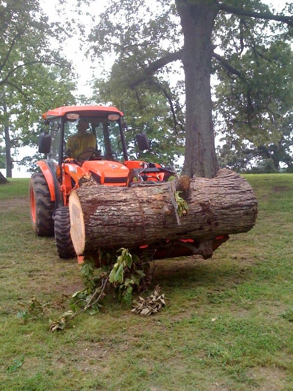

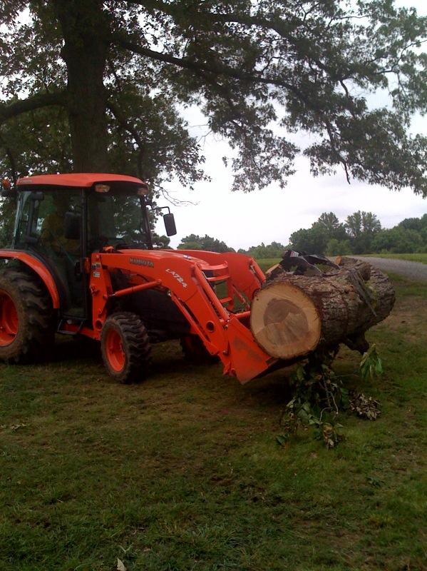

I have a kubota 3240 with 724 loader (small 66" hvy duty round back bucket) and mounted "the thumb" grapple onto my bucket top lip. I did not have to beef up the bucket any at all. I run the thumb from my rear remote (valve nice and handy located inside the cab).
Results are, once yo get good at using it (small learning curve) it is amazing!!! You will be amazed at how much brush this little thumb will pick up.
If you don't have a hvy duty kubota bucket you may have to add a support across the top of your bucket.
Video of grapple in action http://www.youtube.com/watch?v=tzxASonSSkI
