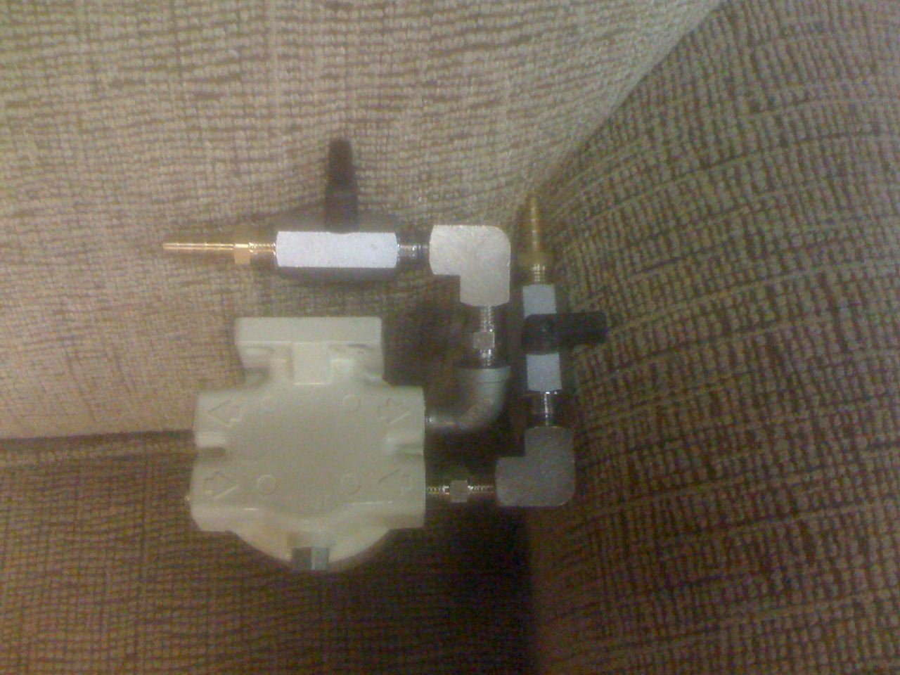

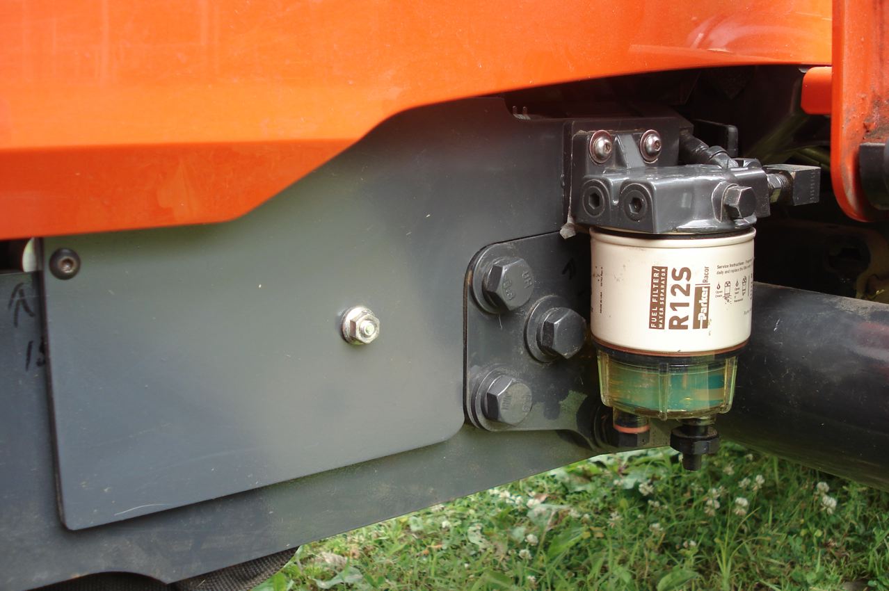

I guess it's time for me to post a picture or two of my Racor fuel filter installation... Mine is just outside the frame of the tractor on the left side and just a bit in front of the floor pan on my BX-25. I was able to relocate the lift pump to between the Racor and the injector pump without messing with the wiring. I also left the original filter in engine compartment between the lift pump and the injector pump to protect the injector pump in the event that lift pump fails as suggested by Neil Messick. So..., Fuel tank, Racor, lift pump, factory fuel filter, injector pump. It is my understanding that (if the tractor has one) that it is best to have the lift pump after the Racor fuel filter so you do not promote emulsification (think mixing) of the fuel and any available water. I'll plan to take the photos this weekend when I'm out switching from leaf collecting to snow plowing mode... :thumbsup:

OK, here are a few photos I took a while ago. The first is the way I plumbed all the new stuff and the second is the filter installed on the tractor. The lift pump is behind the new mounting plate for the filter and toward the front of the tractor. I can try to take a pic of that if anyone needs it. The new mounting plate required no new holes in the frame. The bolt that is in front of the filter goes through the hole that was in the frame for either a steering or fuel line clamp. (I'll check that later). The small one near the top left corner of the mounting plate is a clamp that grabs the top edge of the frame. The wire for the fuel pump runs just under the fan shroud (I made a little holder to keep it there) and to the re-located pump. No more getting under the tractor and taking off the skid plate to change the fuel filter!:D
