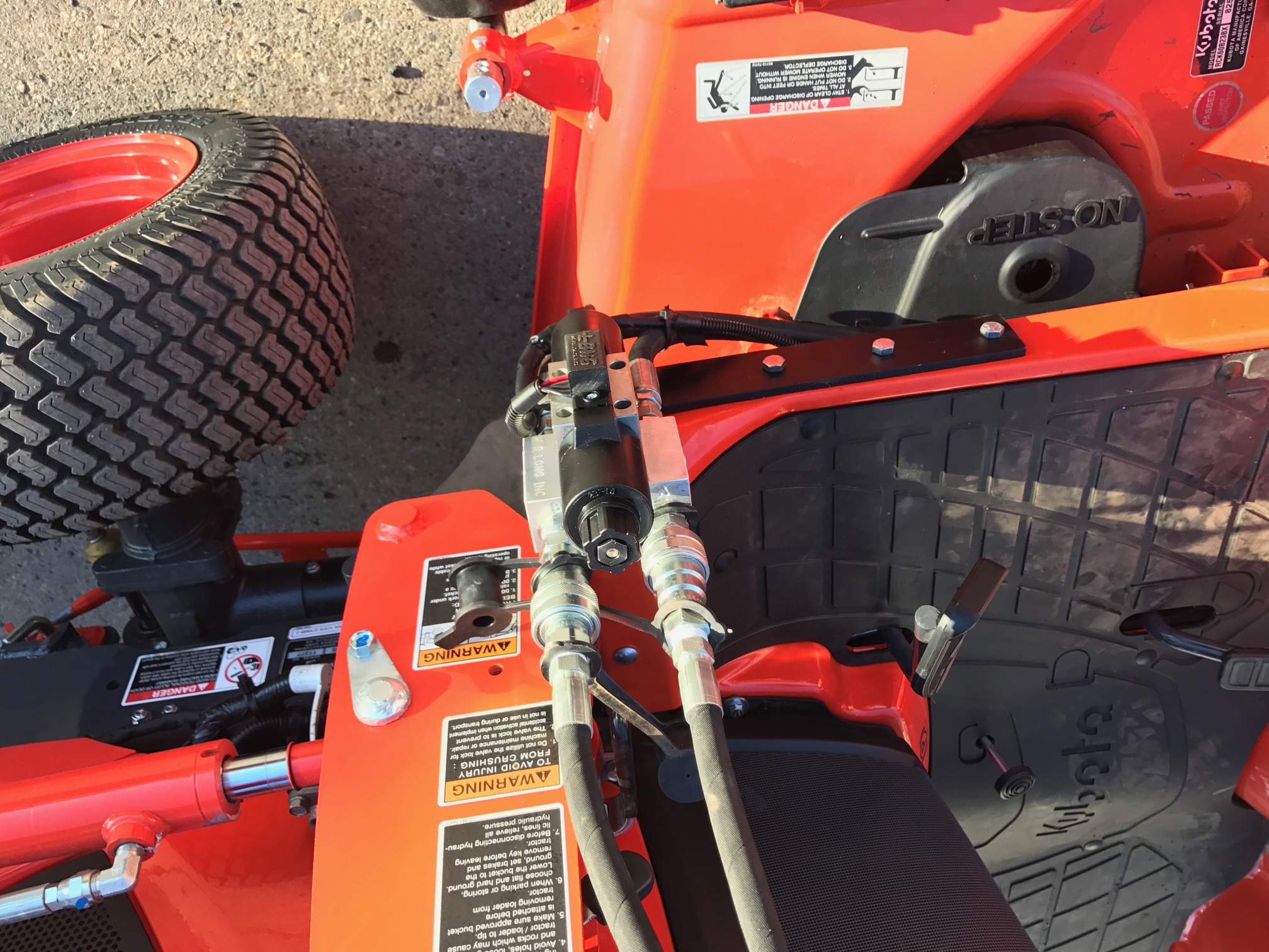

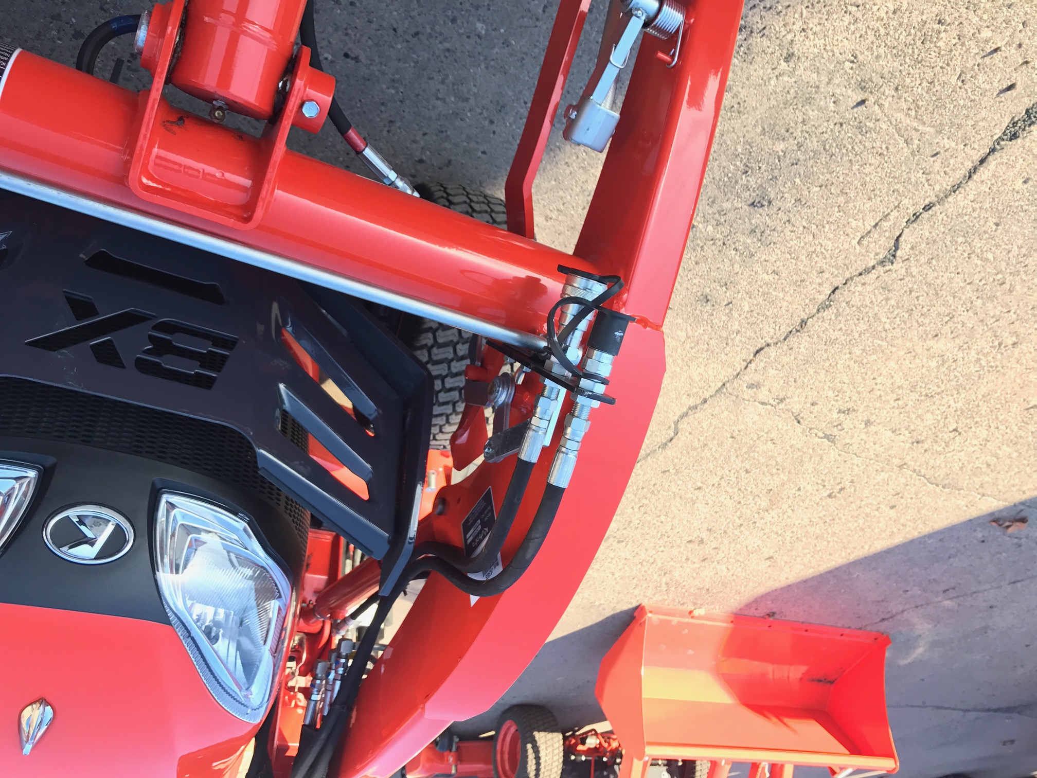

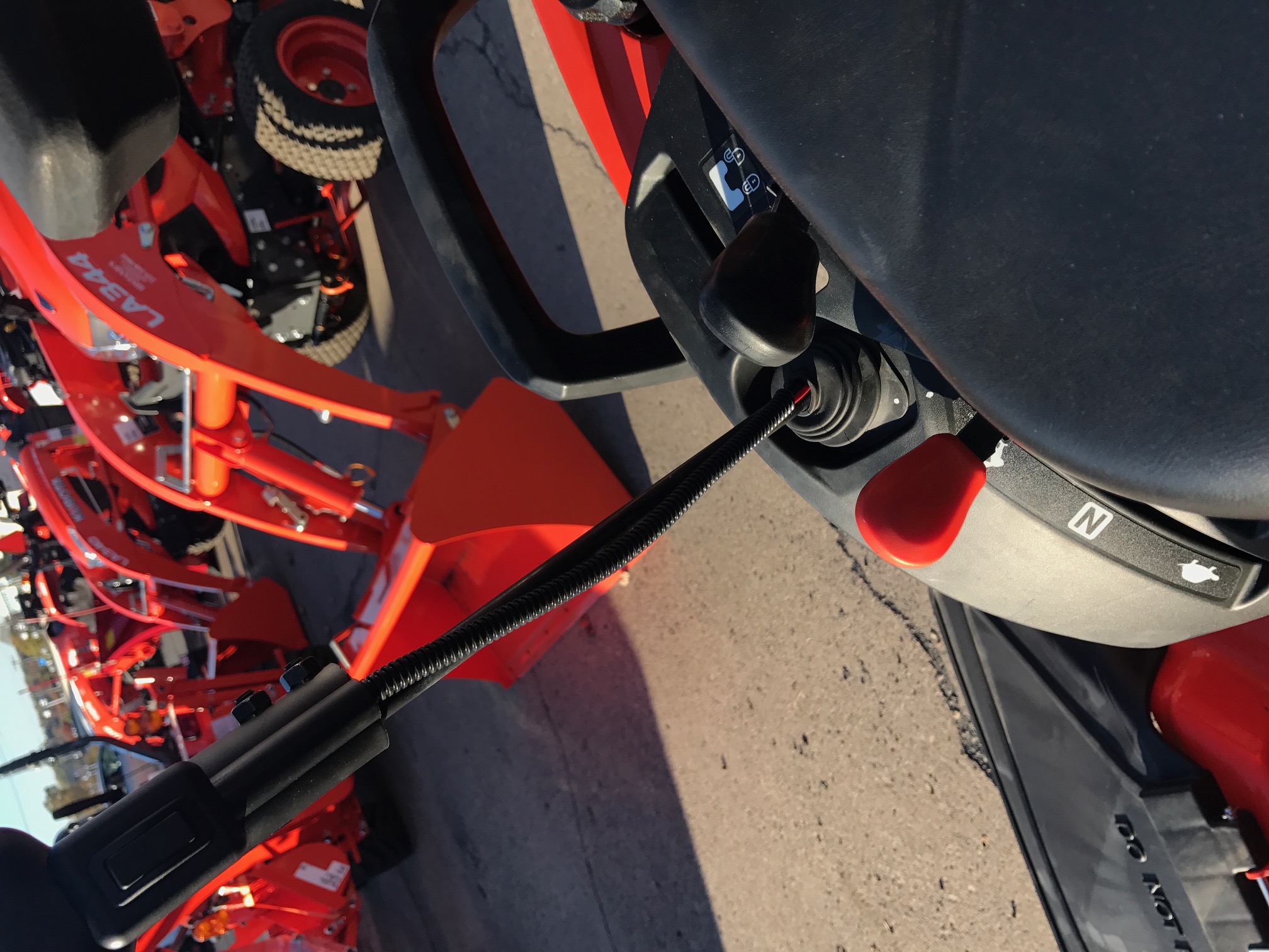

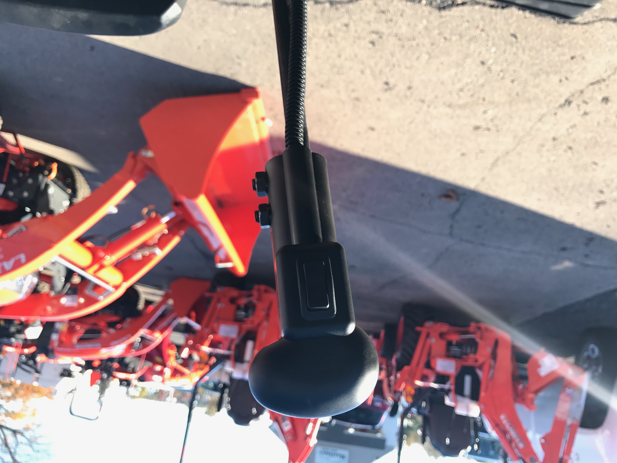

Hi all.
I dropped by my dealer to sign the final paperwork and inspect my new BX23S that's being delivered on Tuesday, and something about the third function valve they installed doesn't look right. It doesn't match the pictures in the brochure, nor does it look like what others have posted on this forum. It also looks kinda cheap the way it's installed with wires exposed above and below the loom on the control as well as the very exposed valve and zip-tied hydraulic lines. I'm guessing they're trying to pull one over on me but I want to make sure before I go accusing anyone of anything. Any help is appreciated!
/ Kubota BX23S third function valve #2
To start with, it is a WR Long kit, nothing wrong with that, but is that what you were expecting? As far as the exposed wires, the installer just got careless, have them get the wires covered with the loom. Is the control grip shown in the brochure, how about the valve? Is that what's on the tractor?
Go from there. Good luck.

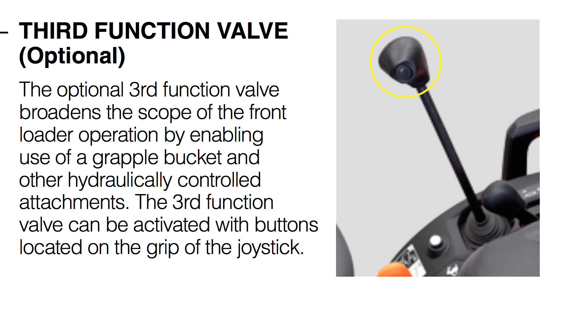

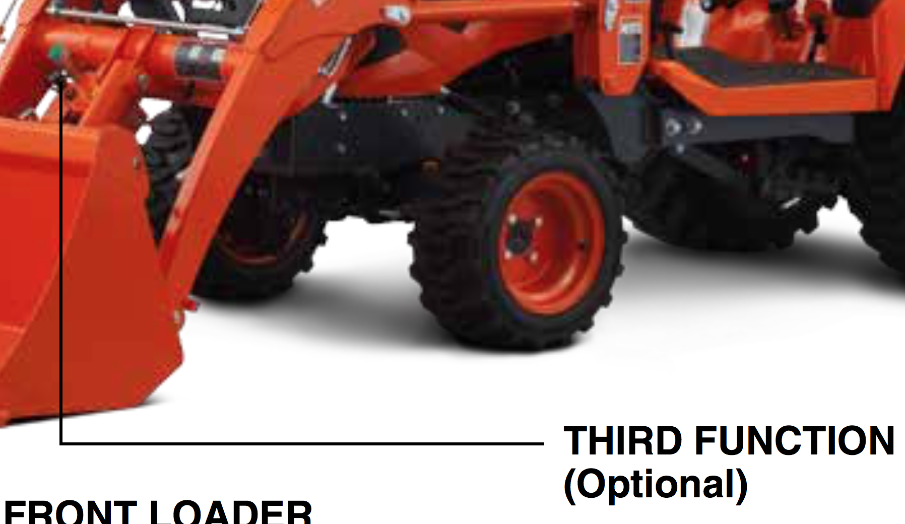

Well, good question. It's not what I was expecting, for sure; I was expecting an OEM Kubota option.
Pics of from the brochure for reference:
Screen Shot 2017-10-27 at 6.52.43 PM.pngScreen Shot 2017-10-27 at 6.52.33 PM.png
The question I have is whether the one I ended up with has any advantages vs. OEM or not. I mean, the OEM "diverter" version definitely seems to be better thought out as it integrates into the loader and its hydraulics vs. a separate set of hoses to have to connect and disconnect with the loader, however I don't know if functionally the WR kit is better.
/ Kubota BX23S third function valve #4
From what I'm reading "buttons" the Kubota 3rd function is not a diverter, but a true 3rd function. I know that's what is on the L models and larger. I don't think that Kubota uses a diverter system on any of the tractors, but I don't know that for a fact.
If indeed it is a true 3rd function, then it operates the same as the WR Long system. So then you need to decide if the OEM system's fit and finish is what you would prefer or just stay with the WR Long system.

Thanks, Brian. What got me thinking it was a diverter type were the below photos in another thread. It looks like the valve taps into hydraulics on the loader, which leads me to believe only one of the functions can operate at the same time:
520679d1504467119-anyone-install-3rd-function-valve-img_6652-jpg
As well as the button looks like it may only be a push button rather than a rocker switch:
520680d1504467150-anyone-install-3rd-function-valve-img_6653-jpg
Not really decided on what I'm doing yet. Tractor is getting delivered tomorrow so we'll see how I feel about it after another look.
/ Kubota BX23S third function valve #6
I believe that you are correct, it is a diverter valve. Sort of surprised about that with all their other tractors using a true 3rd function. :confused: I personally prefer the diverters for various reasons and is what I have on both of my utility tractors.

Yes, it's the WR Long. My dealer did the same thing with mine. I wanted the Kubota 3rd function option, but he told me the back-order time was ridiculous when I bought the tractor.
It works fine, but I can't do all 3 operations at the same time. One gives. My old grapple had the same set-up so I'm pretty much used to it anyway. I do like the thumb button on this vs the finger buttons on the old joystick with the 2370. Took a little to get used to, but it now seems more intuitive.

One thing I didn't post photos of is how they fed the actual third function valve. The hydraulic line feeding it is attached to the bucket valve under the right rear wheel well, and is sticking out inside and below the fender a lot more than I would like to see. This might have been a non-issue on the BX25 where that valve was up front, but this looks like an accident waiting to happen if something got between the tire and fender.

Just a quick note for all, I bought the BX2816 snowblower, and tire chains (H.D. Vbar, not from Kubota). While trying to install tire chains, which are pretty much a necessity for snow removal I was stunned to find out that my 3rd function valve was as yours is, above the right rear wheel under fender. Installation of chains is pretty much a no go as if they could even be installed, they would rip the 3rd function valve out causing who knows what for damage. Beware of this problem before chaining up.

The MFG screenshot looks like a diverted button. Hit it and use the bucket functions on the joystick (ie left/right) to actuate. What your dealer put on looks like a 3rd function to me. That said it is easy to tell. If they are tapping into the same hydraulic like for your loader, then it is a diverter.
My M62 has both a button to enable/disable the 3rd function hydraulics and a toggle switch to actuate it. I am guessing turn it off when I dont have a grapple on it to save the additional flow in those lines, but I could be wrong.
