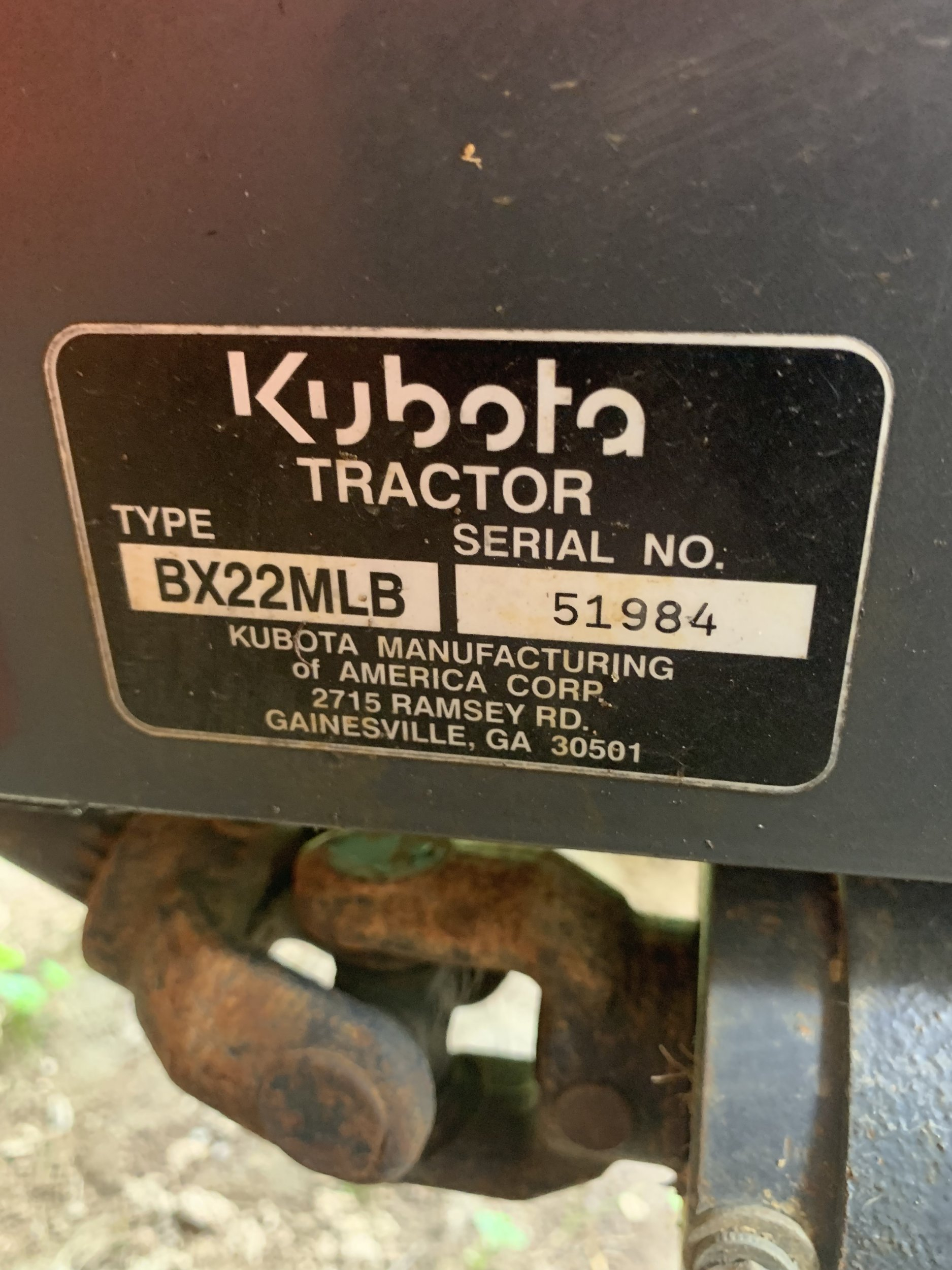

I’m trying to find something out very related to this ?.
My tractor is a 2003 bx22 MLB
Decks I know fit
RCK60B-22BX
RCK54B-22BX
Deck I am looking at for 1/4 price of new and half price of used.
RCK54-23BX
My questions are will it fit factory or what would I have to do to make it fit and function correctly?
First picture is of mowing deck tag and second is of my tractor tag.
