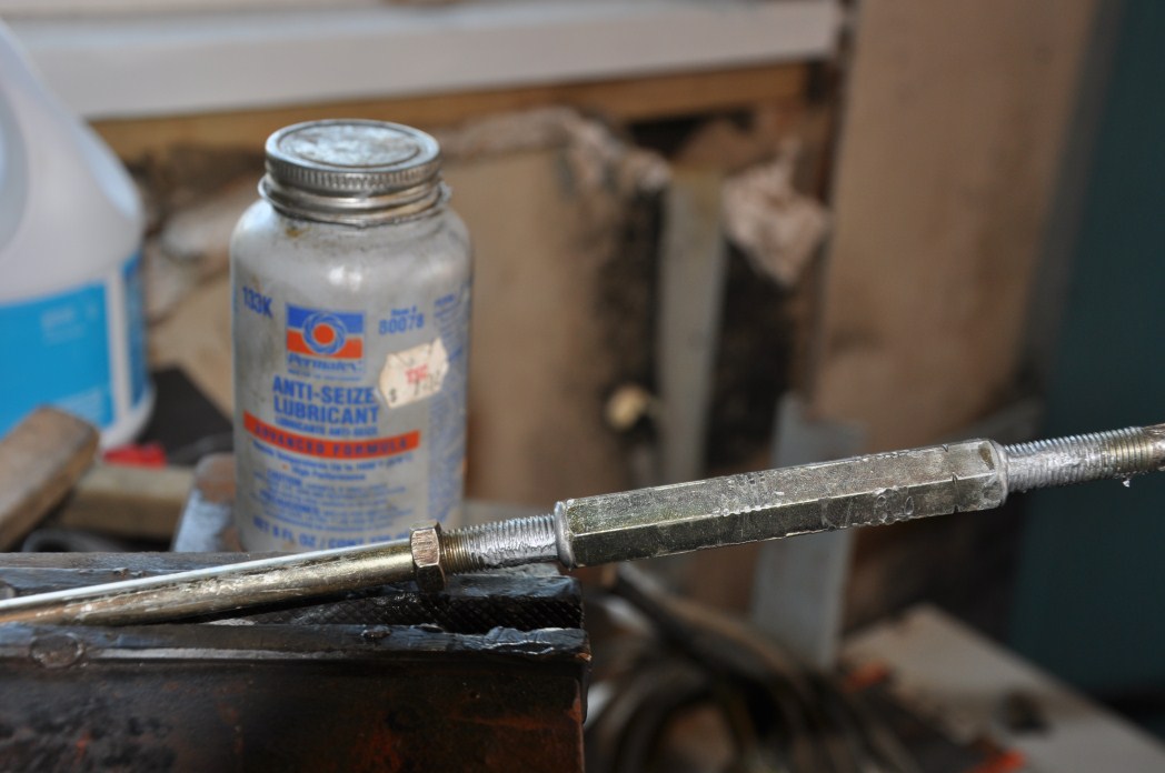

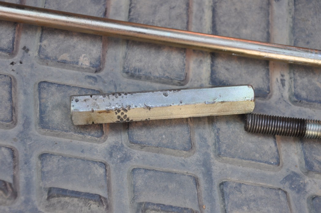

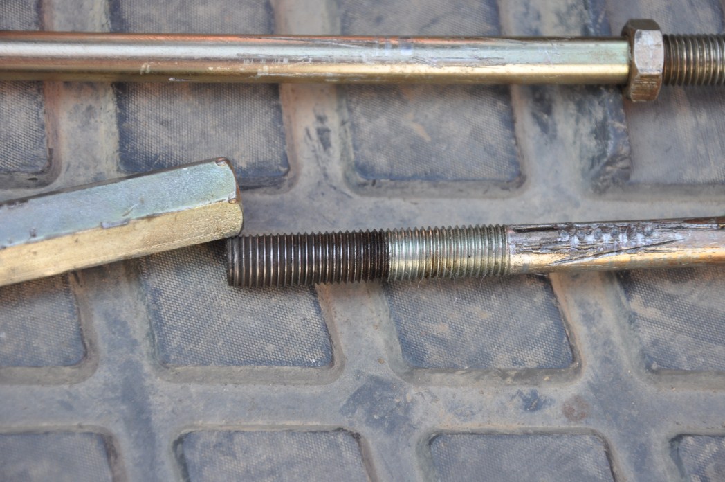

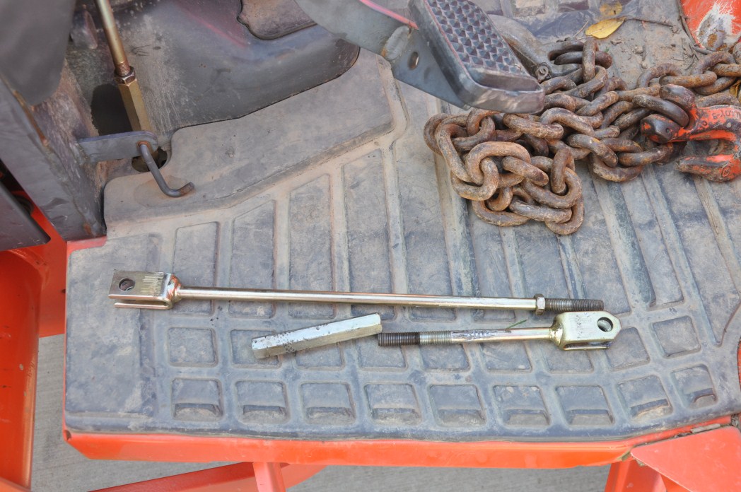

Free at last. Pulled out the cotter pins and pins and got the turnbuckle assembly free from the tractor. I put Kroil on the threads for three days.Put the turnbuckle in my vise and tried to spin each threaded rod with a pipe wrench. Felt like the rods were on the verge of twisting or breaking. Broke out the propane torch and applied heat for about 5 minutes to turnbuckle and rod. Put the wrench to it and no go. Reheated once again then grabbed with channel locks and put the turnbuckle on the flat part of the vise. Tapped on all the flats of the turnbuckle with a 2# hammer. Placed in vise again, reheated and commenced to torqing the threaded shaft. Alas. A loud squeak and then movement. A little more Kroil and wiggling back and forth and finally freed the threads. Same for other side. Very close to twisting the rod or snapping it. Finally it worked out for once. Time and patience got it done. Brakes are now adjusted. Hard part was getting out the cotter pins and releasing the turnbuckle assembly. Good Luck with yours...

Good pictures. That is exactly the design of mine. You saved $52.00 a side, in parts. Should of had anti-seize on the threads, from the beginning.
