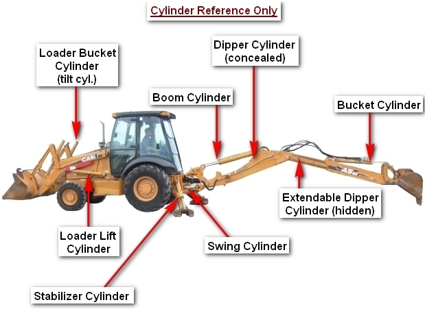

Hi All,
I bought an L3200 with a BH77 Backhoe attached to it earlier in the year. I've had to take it back to the dealership
several times with hydraulic issues (weak cylinders). Everything seems fine now, but I have a question about the
operation of the backhoe. Can the boom cylinder and the dipper cylinder operate at the same time? I didn't know if this was a kubota thing or not, but I don't think I've had this issue with other backhoes. I cannot raise the boom until I release the dipper control. I can only use either one cylinder or the other, not both. It would be nice if I could use both for "skimming" the topsoil off of a septic tank. The guy at the dealership said that is just the way it is. I think they are as tired of me as I am of them. Any help would be very appreciated. I uploaded a picture so you have a better understanding of what I'm talking about.

The boom and dipper should be able to run somewhat simultaneously. It's a lot easier to be smoother on a large backhoe though.

Ok, thanks for the reply. Thats what I thought. I'm definitely still having problems with the hydraulic system.
Any ideas what the problem could be?

What does your owners manual say? My BX 25 manual says you can do both at the same time and I do it all the time as it saves time to do it while swinging the boom or digging. I now have about 300 HRS on the BH out of 1,000 on the tractor and it has all become second nature, hardly realize I am moving the joy sticks and never look at them, keep my eyes on the hole. If your manual states it like mine use that evidence to make them fix it right. A lot of sales and service folks are not proficient operators and do not really know what their product does in operation. After my warranty expired I raised the HYD pressure to 2000 PSI, sure made a difference in BH response and smoothness. Your dealer shop will tell you no but **** no if you want them to doe it.

I sure don't but there is a lot of handy people here that likely do so just keep checking in on your thread.
Try running the levers slow and in different directions together and see if you get any kind of simultaneous movement at any time. I know if I move the boom lever all the way back it will rob from the dipper and so on. Also try just moving both levers just a tad so one don't rob from the other.

I'm aware that a cylinder will rob some hydraulic flow from another when used together, but the boom will stop dead in its tracks as soon as I ease on the dipper lever.

Yeah I'd say their is something wrong with it then.

I can sort of get two cylinders going at once with my Kubota, but it is not like my Case which is a real backhoe. I attribute it more to the Case having twice the pump and about the same size cylinders. Having said that, I use my Kubota more due to the quick attach. On and off in 5 minutes.

You can "feather" the valves on any of these hoes to get two cyls to move at once. What the Case
prob has is valves that are better for feathering: chamfered edges on the spools.
It takes practice, for sure.
