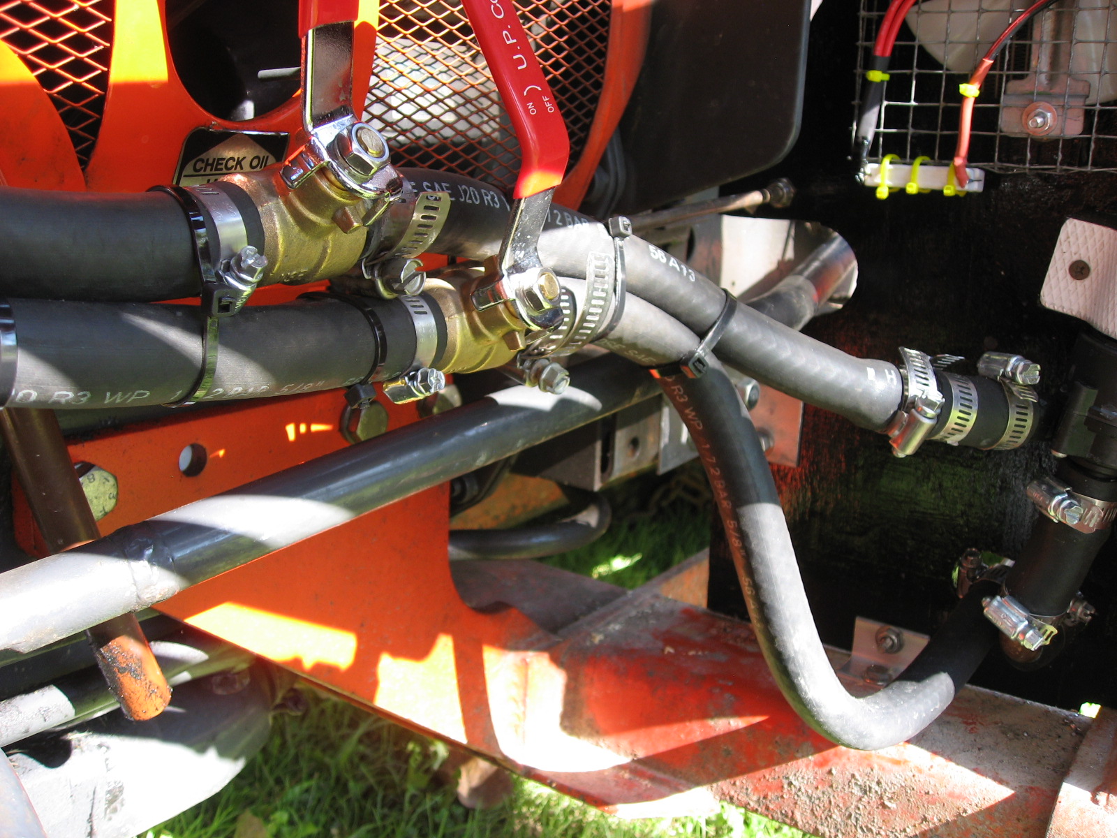

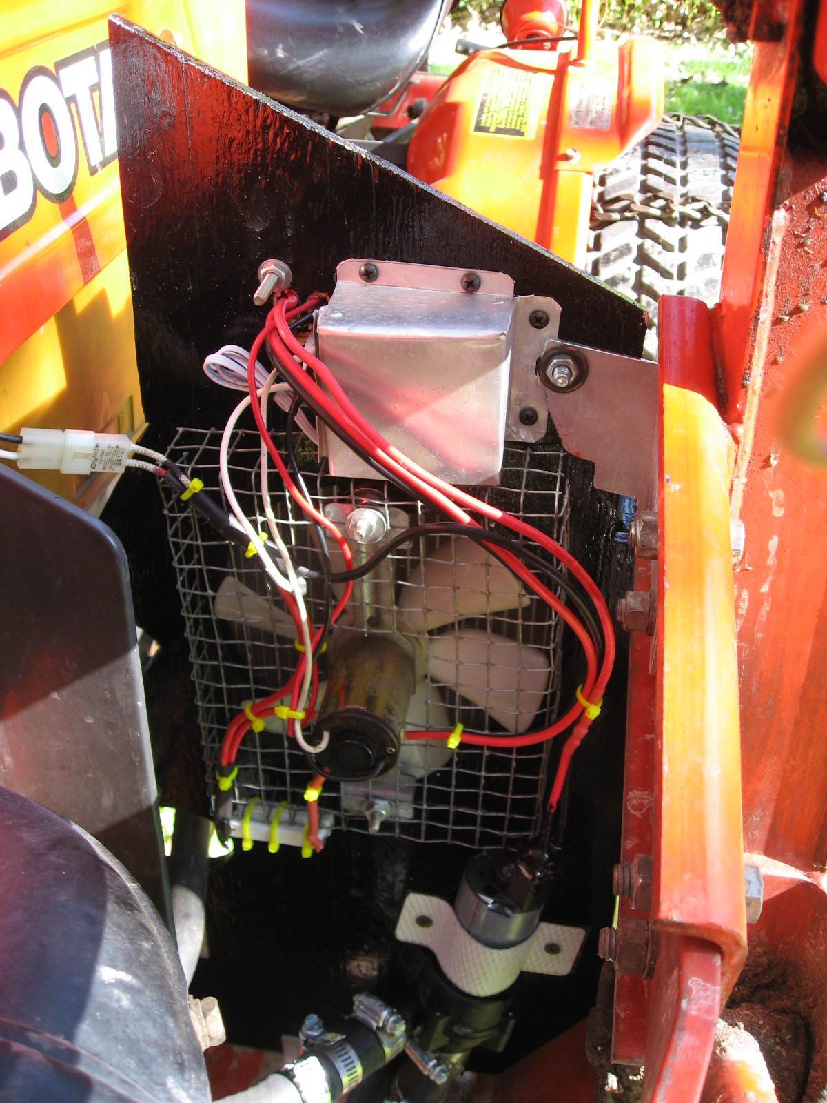

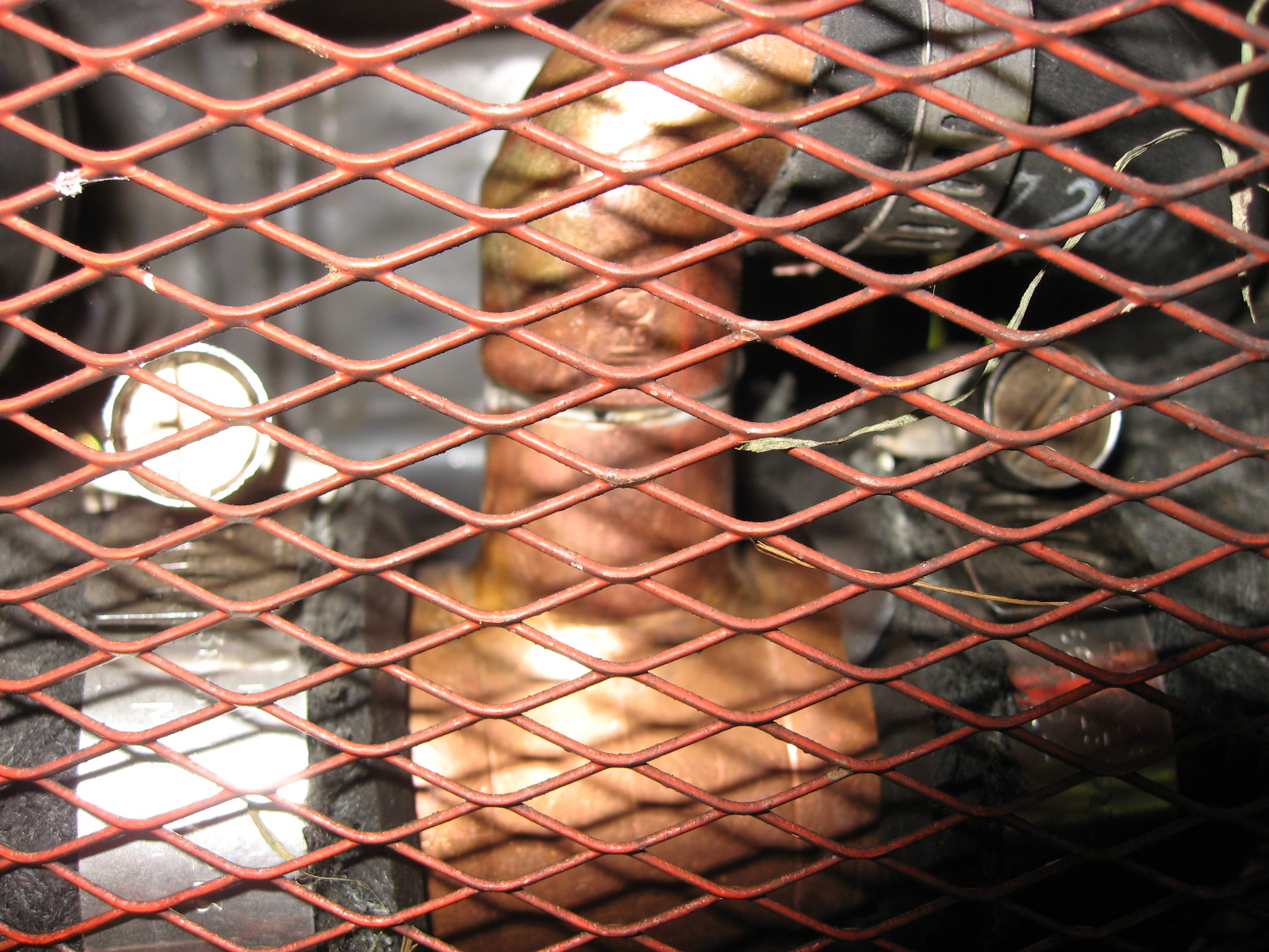

So, I built a heater from from plywood, a new but scrapped automotive heater core, a fan from a RV stove vent and a Bosch electric water pump. Since the B7100 has no water pump, I had to insert a copper 1 1/4" fitting into the upper and lower radiator hoses. In the top hose, I used a coupling and just drilled a hole and soldered an elbow into the hole. The lower hose had more room and I was able to use a reducing T fitting that was 1 1/4" x 1 1/4" x 1/2" . Heater hose that is 5/8" ID just fits nicely over the outside of a 1/2" copper coupling.
To control the pump I wired in a resistor to give two pumping speeds with a SPDP switch. To control the fan speed, I used a PWM rotating control off eBay plus an off switch, as the PWM draws a small current when off.
I also installed ball valve shutoffs in the heater lines so I can shut off the flow if the heater pops a leak.
