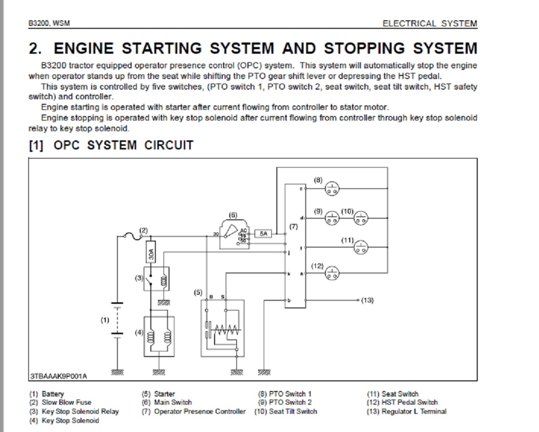

My tractor was idling, I got off of it and was hooking my boat up to it to move it, it shut off and will not start back up, I checked the neutral switch, the seat switch seems to be working, any ideas?

Read the material I will provide below very carefully. The OPC did exactly what it was supposed to do. When you got off the seat something like the pto was engaged, the HST pedal was touched or its switch not properly adjusted.
In your description you should be clearer. 'will not start back up." does this mean no crank or crank but not fire.

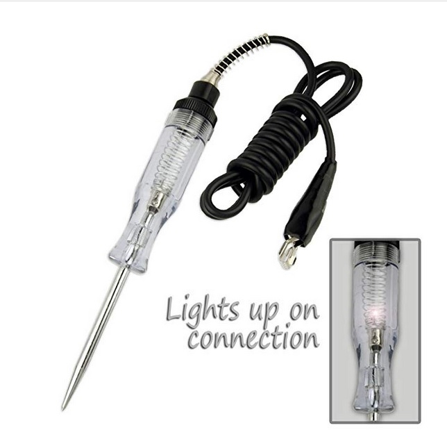

If you are going to troubleshoot these systems at the very least you need a 12 volt test light.
