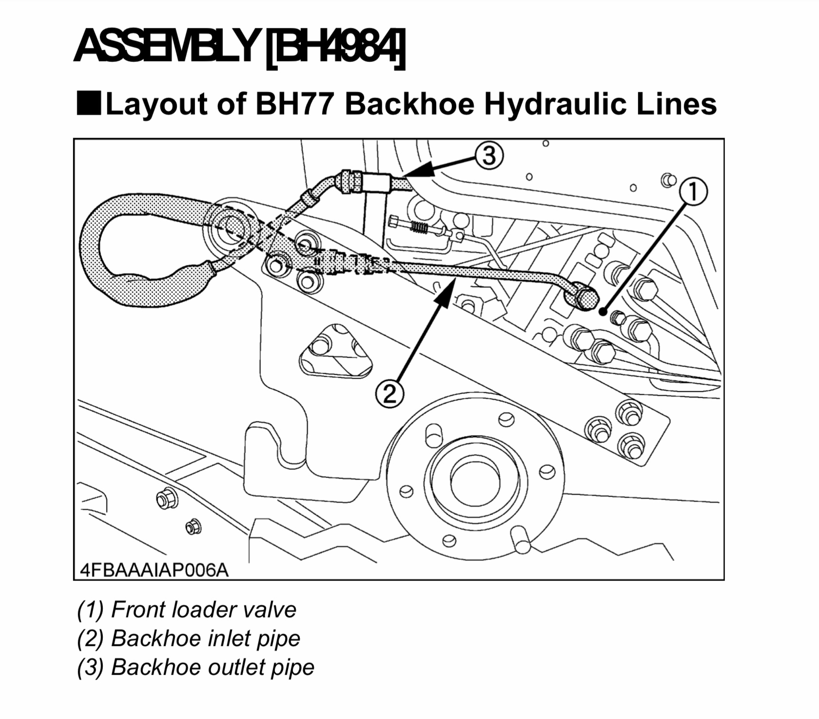

I have a B3200 that has a BH-76 backhoe sub-frame and rear power beyond ports for the backhoe installed. The backhoe is not normally installed on the tractor, and I want to add 2 rear remotes for use with 3 point implements. Since the backhoe and 3 point implements can’t be installed at the same time, could I just run the feed line and return to tank for the backhoe power beyond (which are normally just looped) to in and out power beyond lines on rear remotes valve block that I get to provide flow to the rear remotes? Right now it looks like the power beyond port on my block runs to the backhoe power beyond fist, then runs to the loader valve. When the backhoe is not installed, the power beyond ports are just plugged into one another, making the loader valve the only thing in the PB loop. If I feed the rear remotes from the PB connectors, that wood put the rear remotes first, and the loader valve second. Is that a problem? I don’t think I would ever be using the rear remotes and the loader at the same time.
I also want to add a 3rd function to my LA 504 Loader. Does flow for the third function valve have to be added to the power beyond loop, or is there a separate port on the B3200’s loader valve that can provide flow to the 3rd function. If not, would I need to run the power beyond (backhoe connection) up to the 3rd function “P” port, then out from the “T” port to the feed on the rear remote block, then out of the rear remote block and back to the backhoe supply connection?
I assume I have to use the same 1/2 hose for supplying the 3rd function and rear remotes so I don’t reduce flow to the backhoe?
Sorry for all the questions. I have searched and tried to find the information I need, but I can’t find info on a B3200 with a backhoe power beyond, rear remotes and a loader and with a third function. If there are any B3200 owners who have dealt with this I’m interested in how you handled it.
Attached is the diagram of how my rear power beyond ports were plumbed when installed by the dealer.

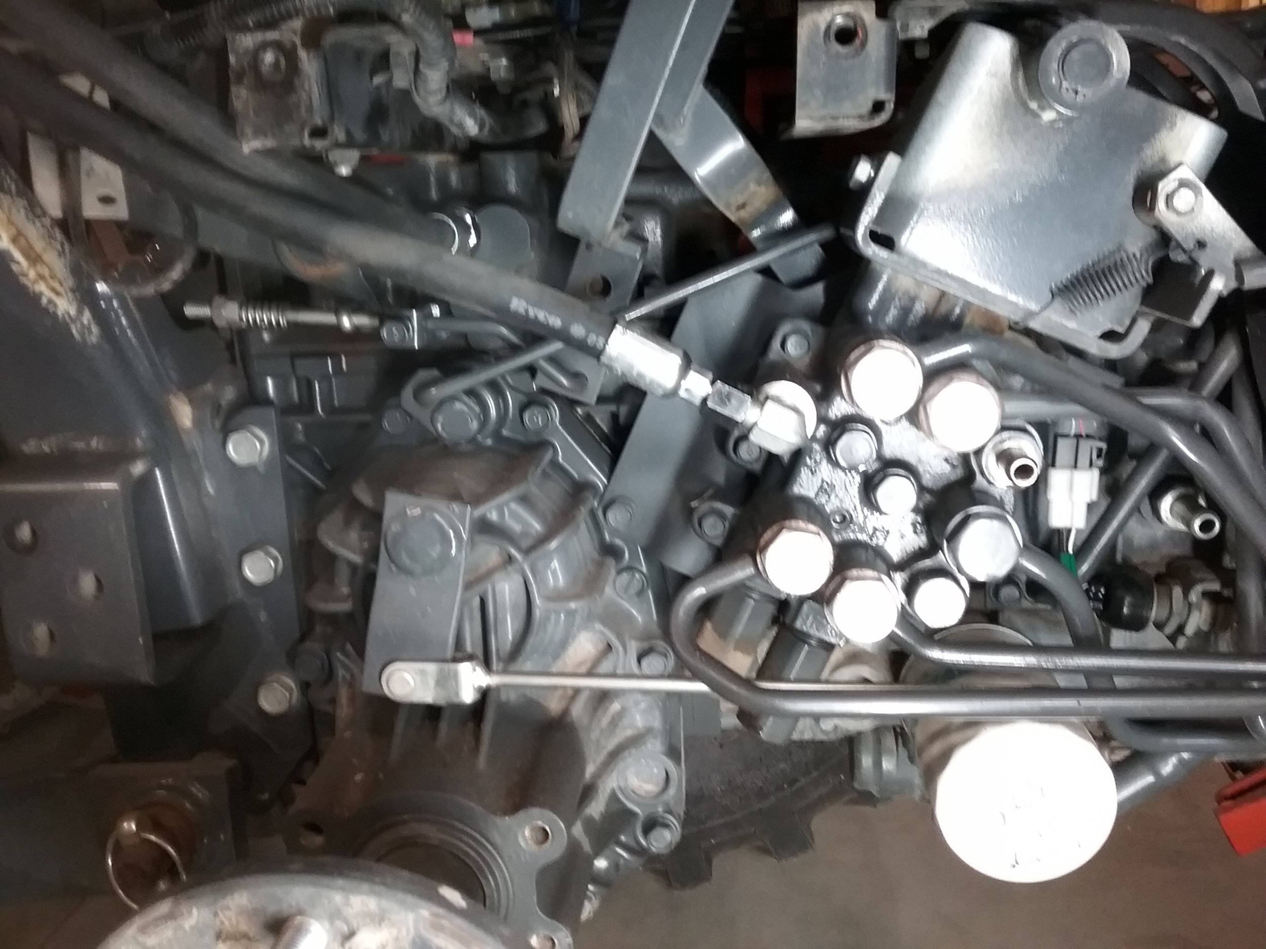

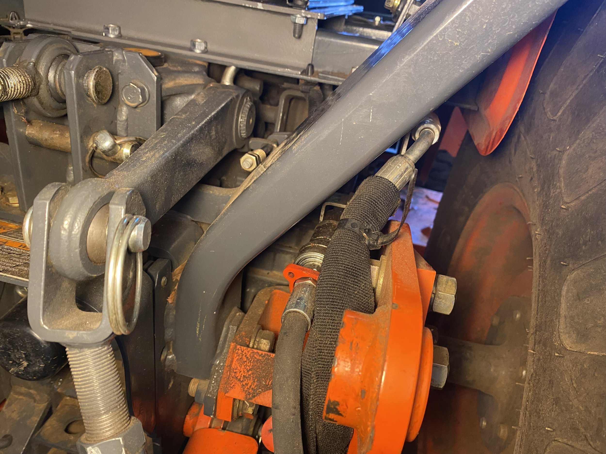

My FEL has 4 hoses. I would prefer a true 3rd function, but understand that a diverted may be the easiest way to go. I’m just trying to figure out what I can do with the backhoe’s power beyond port that is usually just looped when the backhoe is not installed. I think (but I’m not positive) my loader valve has the 4 loader line connections, the power beyond supply connection and the return connection. Right now the rear remotes are more needed than the 3rd function. I have searched and know these questions are asked repeatedly, I just can’t find the hydraulic plumbing for the combo of FEL, 3rd function, rear remotes and backhoe power beyond. Thanks for your help, I appreciate it.

Ok, best I can tell here is what I would do.
Power Beyond from loader to the 3rd function valve. Make sure you get a 3rd function valve that can feed another valve.
Then go from 3rd function valve to inlet on remote valve. This valve will need to be open center with Power Beyond.
Then take power beyond from remote valve back to complete the power beyond loop.
You will need to locate a tank line off of the loader and use a tee to tie it with the tank port of the remote valve.
When you have the backhoe on the power beyond from the remote valve will now feed the backhoe valve.
Hope that makes sense.

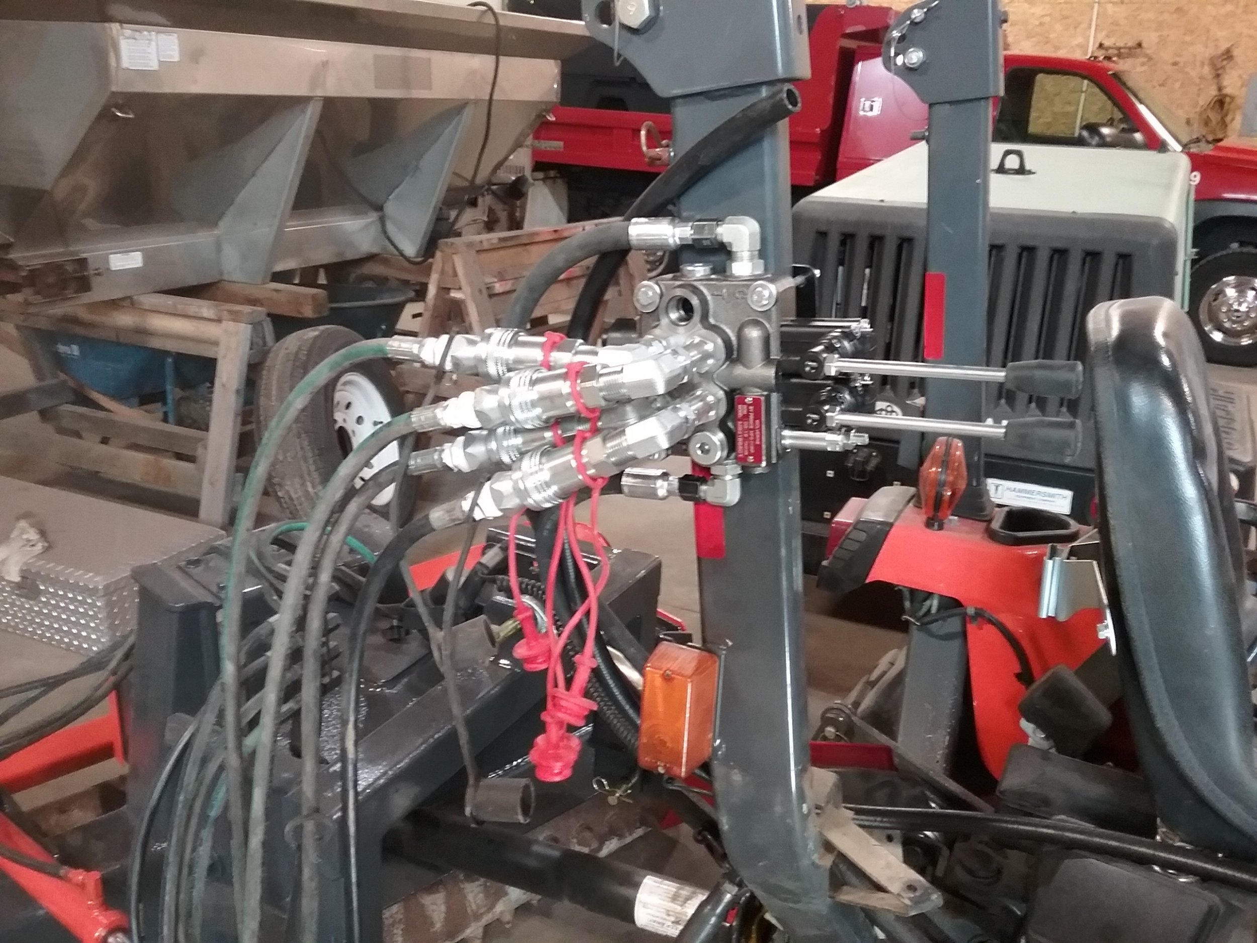

I added rear remotes to a b2920 a few years ago. It looks like the same basic layout. I hadnt plumbed the drain hose in yet, but that was just done with a barb tee. you can see the 2 open connections on the right side. You can put the 3rd function valve in line before or after the loader valve. I dont think it matters. The 2 hydraulic lines that i added are the same as you already have for your backhoe so theres no reason not to use em. As long as all the valves you're using are open center, you can put as many as you want in series and in any order.
/ Kubota B3200 adding remotes and 3rd function #9
Not sure if you're putting together your own setup together or buying a kit, but heres the valve that I used and where i mounted it.
Prince Hydraulic Control Valve — 8 GPM, 2-Spool, Model# MB21BB5C1​

Your backhoe is not fed before the loader. It's after.
If you look at the pics you posted...what is labeled as the loader PB, where that tube goes back to the tractor is feeding the 3ph.
The backhoe loop interrupts this. So loader PB now feeds backhoe....and when you loop them back, the backhoe return feeds the 3ph.
Using a remote for the 3rd function is fine. So you only need to install the ONE valve with 3 spools.
NOT counting the 6 work ports, you need THREE hoses to this new valve. And you have two already
The PB hose coming off the loader needs to go to the inlet or P port of the new valve. The new valve needs a PB cartridge. The hose that goes there is the backhoe return. You need to add a third from the tank port of the new valve and teed into a tank port or line somewhere
Easiest way to run the backhoe now is to put ag couplers on the backhoe hoses and run them off one of the new remotes. A detent on one of the new remotes would be helpful, but a mechanical way of holding the lever is fine. Just be sure you are feeding the backhoe correctly and not backwards

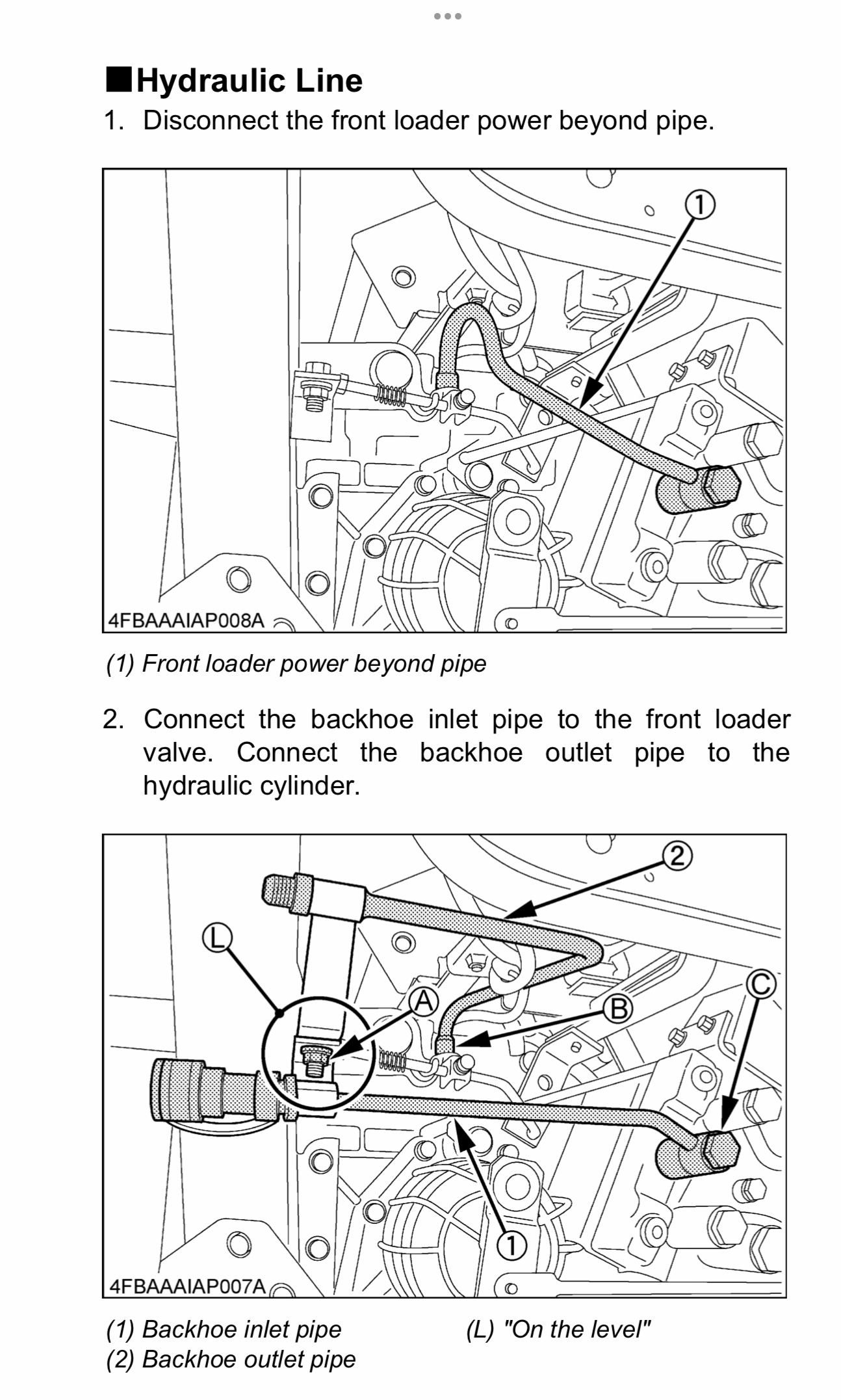

LD1: Thank you very much, that was helpful. I think I have a clear understanding of the lines now. I just have to identify the Tank Return line to tee in the tank return on the new valve. When I looked through the install manual for the Summit Hydraulics EVK2-3 valve it only shows 2 connections, the pressure inlet and the tank/return. See page 5 of the manual attachment. I’ll ask Summit if they have a dedicated tank return. As for for connecting the Summit valve to my power beyond, I was just going to connect it to the existing AG connectors on pb that the backhoe uses, and just unplug the Summit rear remotes when I have to install the backhoe. I do like your idea of adding an extra remote to connect the backhoe to. Thanks again for your help.
I would just simply feed the new valve with the hose that feeds your backhoe. Then use the power beyond from the new valve to feed the backhoe or complete the loop for when the backhoe is off. Then you tee the tank line as stated.
This way there is no need for an extra spool or having to tie the spool open to use the backhoe.
