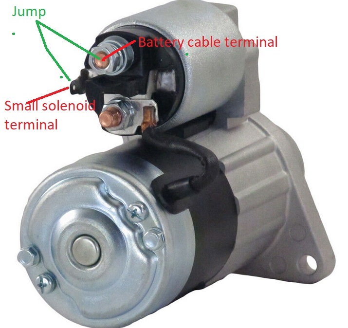

You need to learn to jump the starter so you can rule it out in your search for the cause.
Jumping a starter is inherently dangerous as all safety features are bypasses and you can get run over or have run-a-way tractor.
I suggest having someone on the seat with the brakes applied.
The attached photo shows what terminals to jump. Remove the trigger wire from the solenoid before doing the jumping. A screw driver or short length of wire to bridge the two terminals shown in the photo.
The engine should crank immediately. There may be a small spark.
If the engine cranks then you know the problem lies in the circuit from the key switch to the solenoid which is where safety switches and Operator Presence Controllers are located.

Fixed...I hope! I rigged up a solenoid jumper cable, per the above instructions, which allowed me to sit in the seat, and operate the ignition and brake, and this old rascal fired right up. I then began to look at safety switches, etc., and found that the Mid Mount PTO lever was stuck in the On positions. Crawling around underneath, I found a piece of tree branch that was blocking the lever, and wouldn't allow the lever to move to the off position....I was doing some brush hogging in the forest a couple of days ago, and probably kicked up the branch, then accidently hit the lever when I was doing some dirt work.
I checked some more of the safety switches, and fuses, etc., and all seems ok now. I may even open the dashboard in the next couple of days and check out all the connections in there. At a minimum, I put this "jumper" in the tractor toolbox, just in case, I have a repeat of this problem when in the forest, 1/4 mile from the house.
