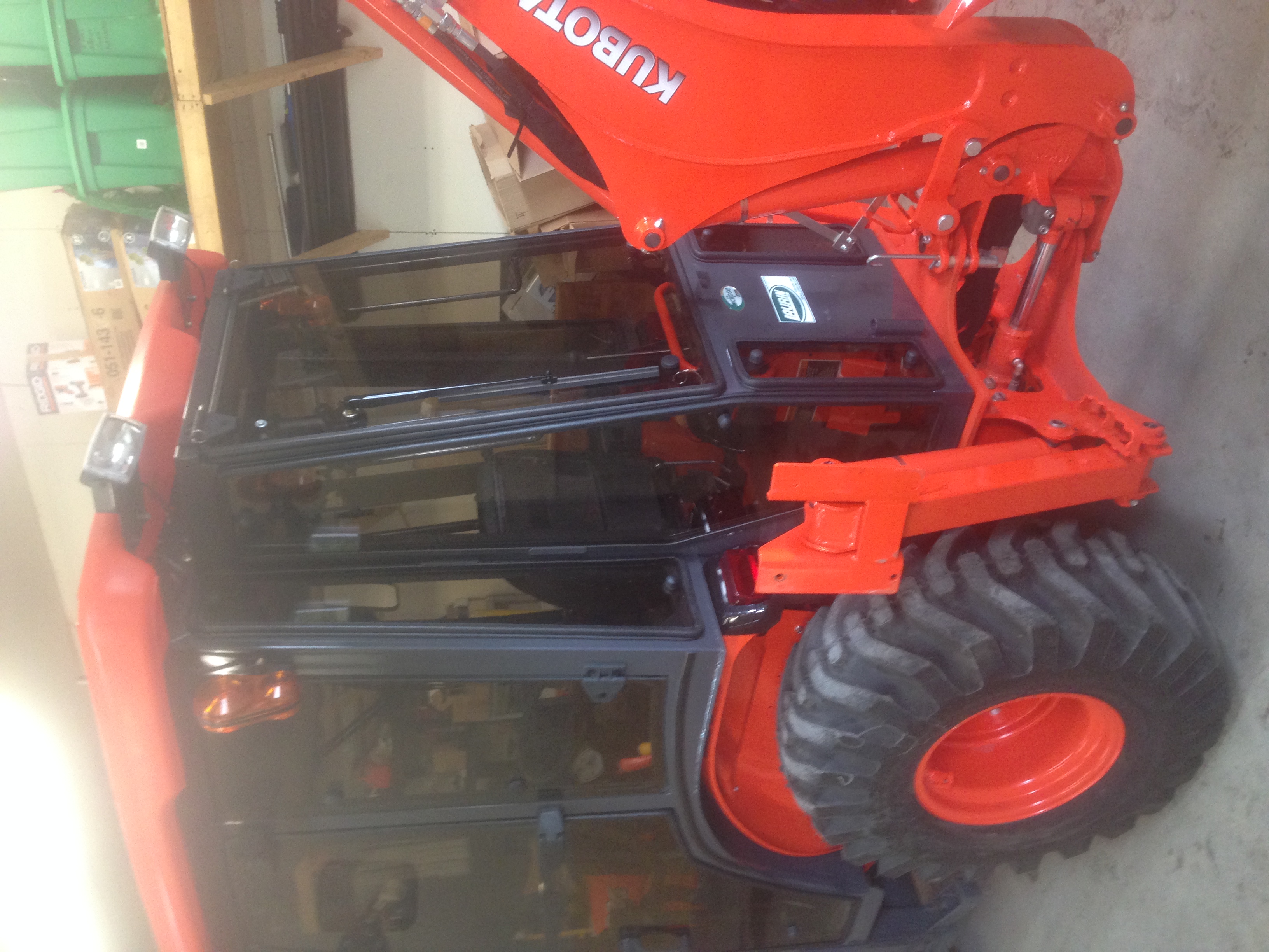

Well guys,here is my 2017 b26 with laurin cab.its very nice,.i can't wait for winter.i have heat/radio/wipers..I didn't want a/c..you'll have to put big white box on roof.it didn't look pretty....
It is tight and awkward to switch to bh...but manageable..I have rear snow blower kubota 64"..3thrd function valve..looking to get bolt on grapple...

Really nice cab, I'm jealous!
I have a cottage in snow country where it gets down to -30 Celsius and it's darn cold sitting there in an open cab. I took the poor man's route and installed a heated car over the vinyl OEM Kobota seat. It's strange how much more comfy it is just with a car seat.
I do get cold feet and hands though when it gets really cold, I'll probably invest in good gloves and boots next winter. Still, I had to clean the drool off my monitor after looking at the photos. :eek:
/ Kubota B26 with enclosed cab #16
No drooling !! LoL ...it is warm little bit loud,but it winter the heater will make the noise sound umm warm.!
It did cost $$$$$ for cab.. which drove price of machine up considerably... I haven't really tested it out yet..it's just been raining off and on...no sense in getting it all muddy n dirty .for nothing.....but I can't wait to..LoL....if any questions want answered about the cab just ask...I know I seen few forums where people were asking questions about the laurin cab on a b26.. I think next week I will take of the bh on a trial run,and put snow blower on,just to see how things work out...the extended piece of the cab is suppose to come off with bh,and the back glass does come off,and it's suppose to go back on with a steel plate that gets placed on bottom.....so before winter does come if any issues arise I shall have them all worked out...
