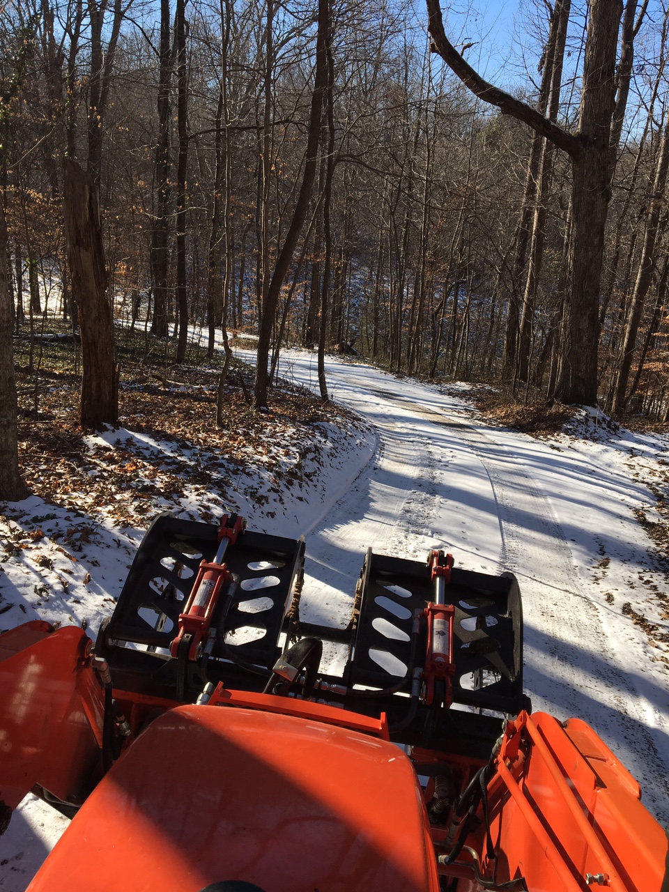

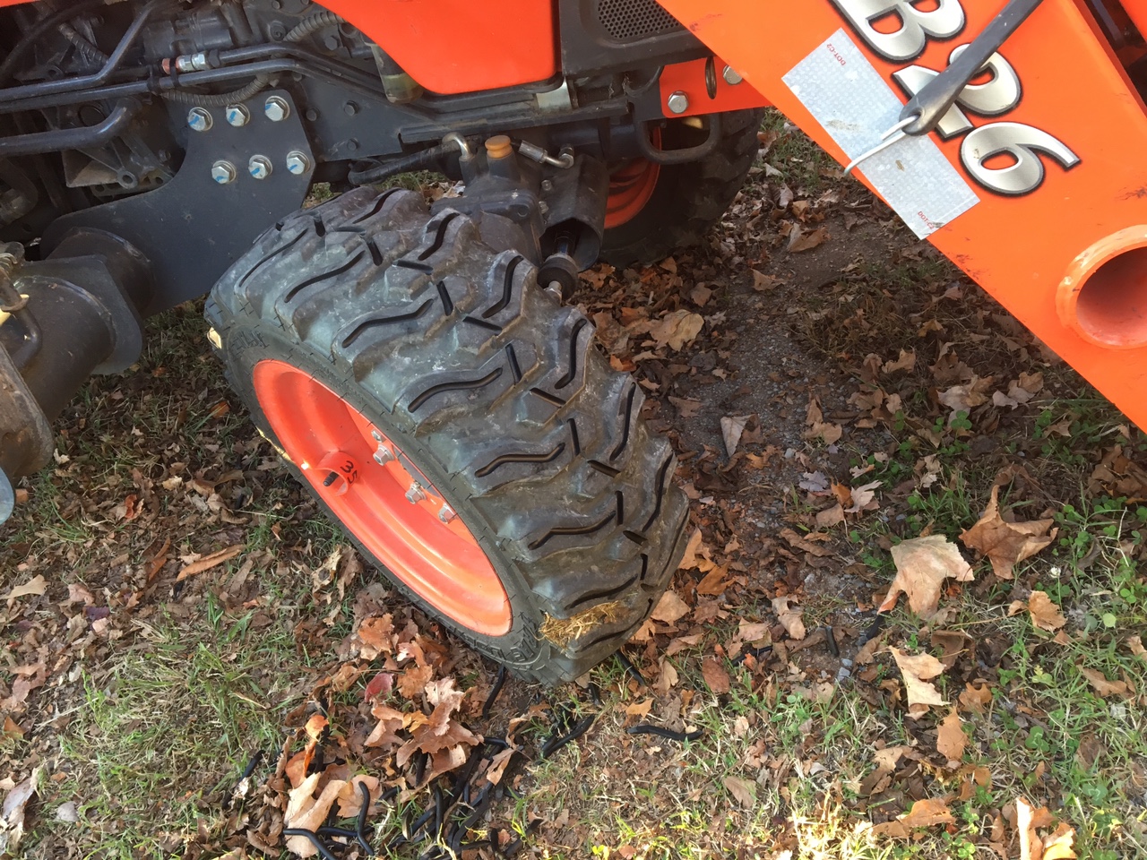

2” rear wheel spacers really improved stability on my B26 on my hilly farm. So did rear ballast in the rear tires. Gemplers Bulletproof tire sealant in the front. Mowing and FEL work with grapples improved. IMG_0653.JPG
Grooved the front tires. Helps with mowing and the little snow we get. Don’t run on the road so R4 tires last a long time.
