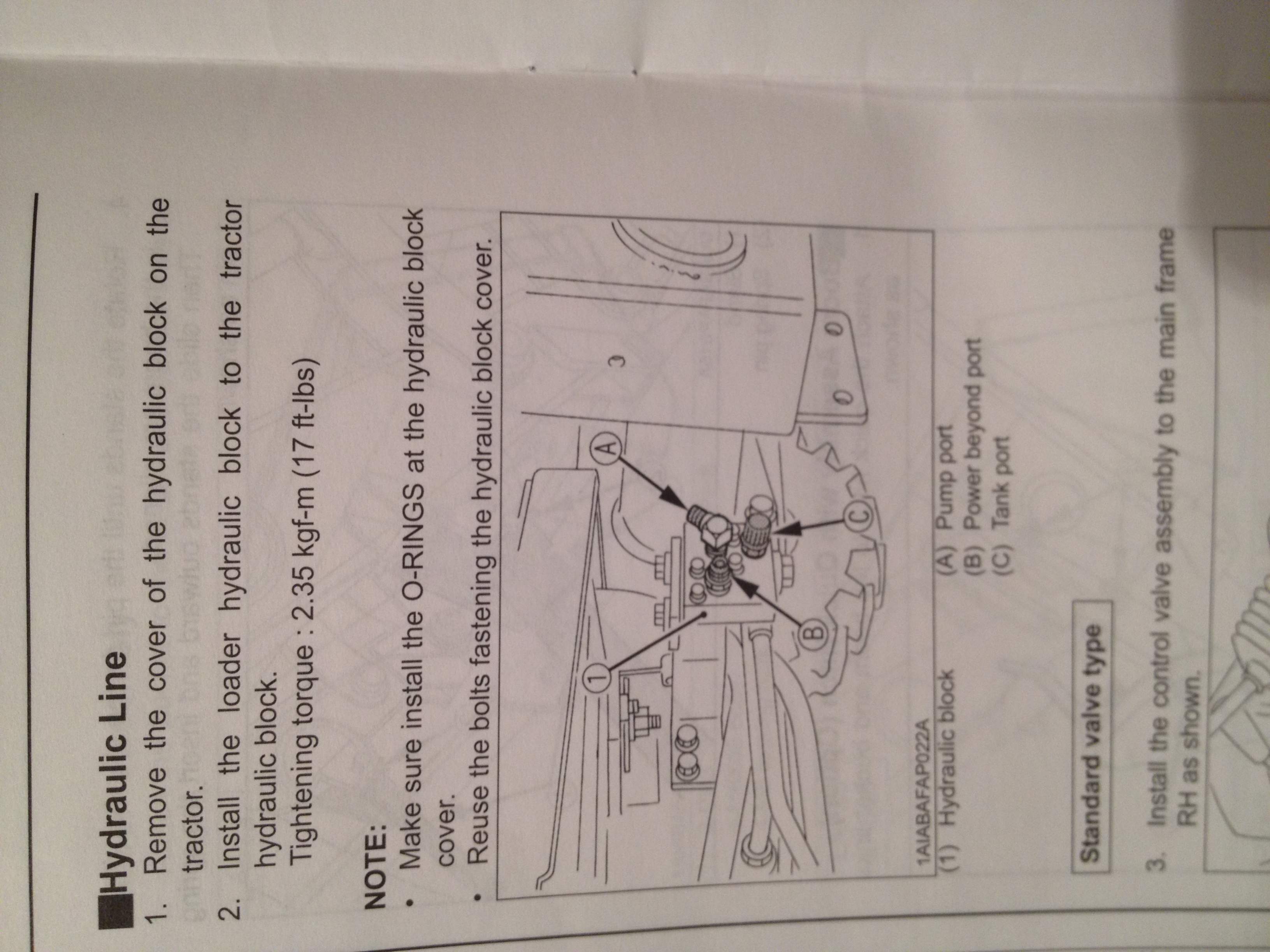

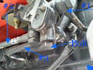

I have a B 2323HSD and would like to use the method listed here. I just do not know what ports on the side of the tractor would be the pressure side and the return.
Can anyone send a photo of the ports or a diagram? This seems like a simple task as there is a spool valve that can be added so the ports are there somewhere.
Any help would be great.
Thanks

These pic are similar tractor hyd blocks.
   / Kubota B2320 power beyond and 3rd function
thanks for these Sir!
