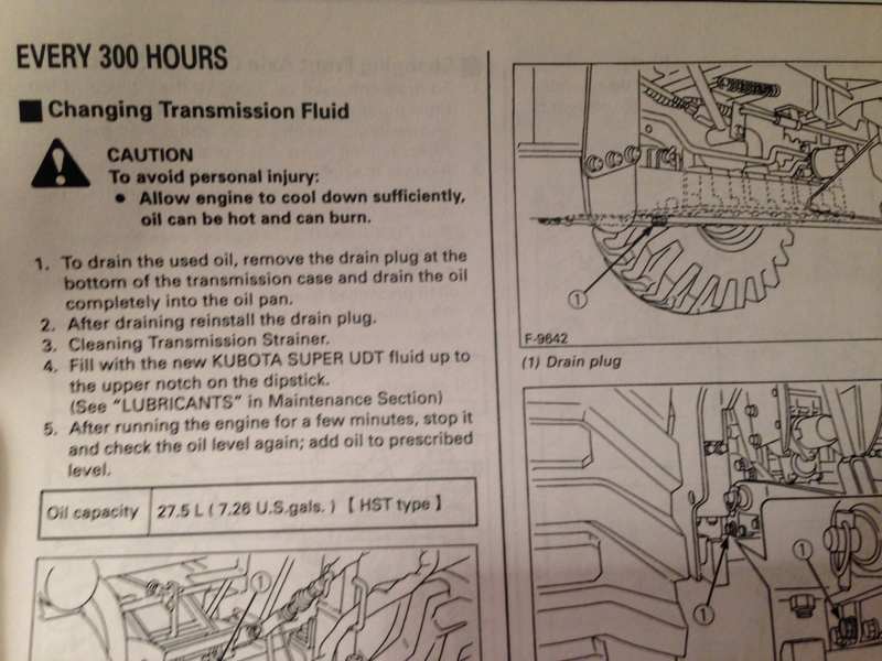

I don't like the looks of that at all!
Don't forget the drain plugs on the brake/axle housings as well.
Pull the red fill and let us have a look inside.
And if possible some video inside when running from the start up.
Will your hoe stabilizers lift the tractor to full height at idle?
I have not looked under it to see separate drains, how many total drain plugs are there? The manual only shows the one.

Please note, drain plugs on rear axle/brake housings are pdf page 158 of the parts list noted, it must be a different pdf to mine. I have edited the post above.
   / Kubota B21 Foaming Transmission Fluid. #36
Actually if you have a look in the picture you have posted, the lower picture shows the axle housing drain plug!
(I hadn't looked at the pic)
I see that now. The instructions say to remove "the drain plug" (singular), then use symbol 1 twice, once in each picture. Without looking closely, I thought it was another view of the same plug. It obviously is not, there are three. Thank you for pointing that out.

Also one on the bottom of the HST it appears you can't get to unless you drop the hydraulic oil tank.
I hope not.
   / Kubota B21 Foaming Transmission Fluid. #40
I wouldn't worry about the plug in the bottom of the HST, but if you find lots of sludge/water in the bottom you may wish to either air ratchet the bottom of the pan off or pull the entire pan, of course that depends how pedantic you are, and whether you intend to do another drain and fill in "X" hours down the track.
Don't forget the bit about running the engine at medium speed for a few minutes after changing the oil, before any use of the tractor. (just found my operators manual Code No. 32721-6311-7, what code no. is yours?)
