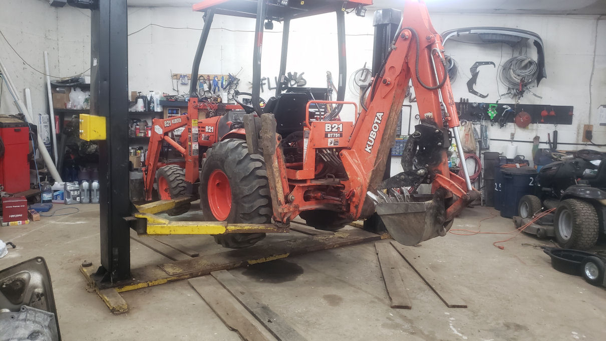

Sorry for reviving a VERY old thread but it's one of the first Google results so I figure I should add some flavor to the post.
I just finished changing my engine oil/filter, hydraulic oil plus filters (x2), fuel filter.. as well as the headlights but that's not important. The whole process too around 3 hrs. A good chunk of that time was spent waiting for oil to drain, or oil to fill up the reservoir. Of note: I have the benefit of a lift/hoist which made removing the hydro filters quite simple. It also allowed me to remove most of the fluid from all of the cylinders as well since I could prop up the bucket/boom/etc. with a transmission jack, tie back the corresponding hydraulic control stick, and slowly lower the tractor which would extend and/or compress the hydraulic piston and push the fluid into the reservoir (and out the drain plug into my pan).
I used three 15 liter (4 gallon) oil pans to capture all of the oil, leaving only a tiny drip on the concrete floor when I swapped out pans.
Overall, for me, it was a very simple process that resembled an oil change on most any truck and/or full size SUV. If you're not concerned with getting all of the oil out of the lines and hydraulic pistons then this should still take the same or less time even without a lift. I do, however, recommend that you raise the tractor up as high as possible with the bucket and backhoe legs, then place 4 jack stands under the tractor, so that you have enough room underneath to work.

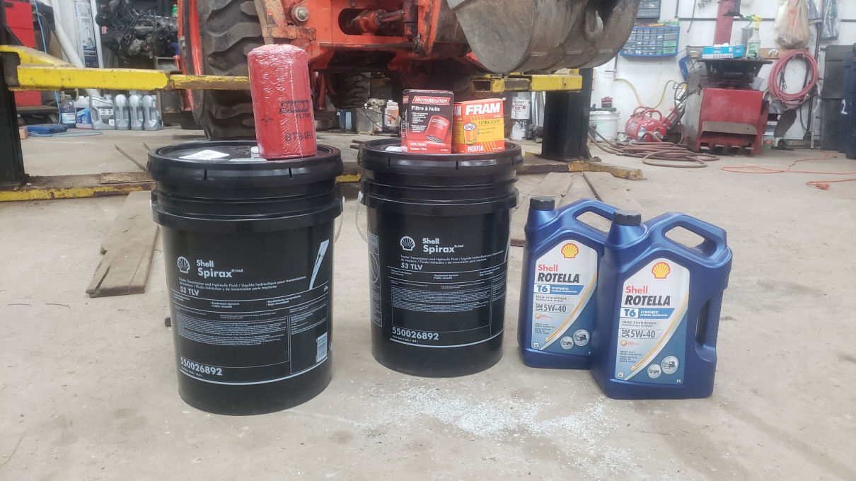

Filters Used:
  • PH3593A for the Engine Oil
  • PH3682 for the HST (behind the left tire)
  • BT8488 for the HST Reservoir (mounted under the middle of the tractor, immediately in front of the hydraulic oil reservoir)
Oils Used:
  • 4 Litres of Shell Rotella T6 Synthetic 5W-40 for the Engine Oil
  • ~30 Litres of Shell Spirax S3 TLV (Used to be called Shell Donax TD) for the Hydraulic Oil
Tomorrow I'll change out the axle oil but I dont see that being a lengthy process (other than waiting for the 90 weight oil to drain/fill)

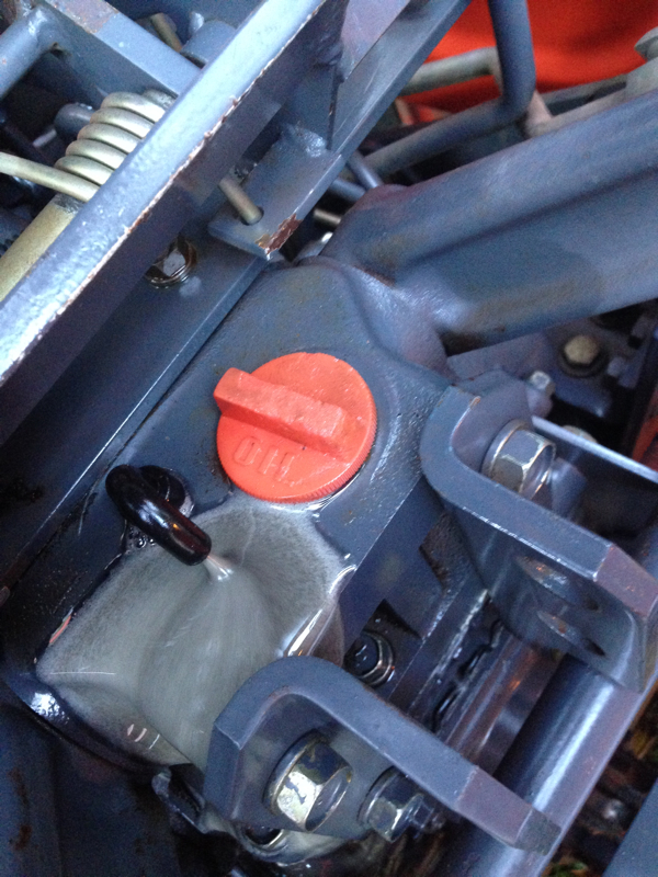

Been my experience that foaming is caused by one of two things...
Incompatible fluids not intermixing or water in the fluid.
   / Kubota B21 Foaming Transmission Fluid. #48
Now that a couple of years have passed and I've had the chance to work on this problem a couple of times.
I've seen two main reasons trans/hydraulic oil foams, and either one can push a froth out the overflow.
To figure which it is, take a sample of the foamy fluid, put it into a clear jar, and see what happens in an hour or so. You can use a syringe and piece of tubing down the fill hole will pull a sample.
If the fluid was cloudy to start but clears up or turns into mostly clear oil with some foam on top then the foam is micro air bubbles. Usually from air being sucked into the system between the sump, filters, and the pump. Often it's an old hardened hose cracking at the end where it is held with a hose clamp. Or a loose fitting.
The fix is to stop the air from getting in.
Suspect the hoses and fittings. It won't leak oil out while running - except through the overflow - but might when sitting.
On the other hand, if the fluid after sitting looks like weak chocolate milk or is stringy and stays that way then that means water has gotten into the transmission fluid and made an detergent emulsion. This is real common with tractors that sit outside in the rain when water seeps past the shifters. I also had a friend see this after using rental attachments that we suspect had watery oil. A filter won't take the water out once it is well-mixed.
The fix for this is to drain, flush, clean filters, and refill.
Hope this helps,
rScotty
