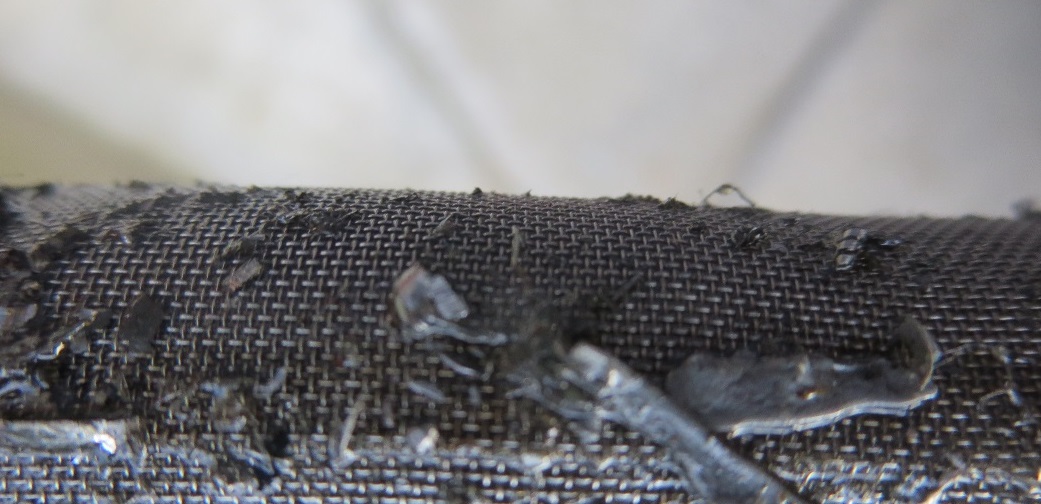

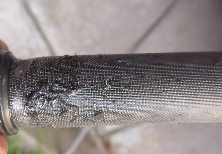

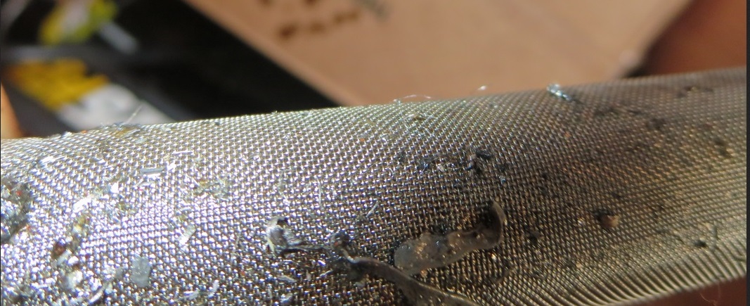

when I did my "300" hr service at 358 hrs I finally figured out where/how to get the hydro screen off and cleaned, I just thought I'd post a few pics and see what anyone thought.
Thanks
