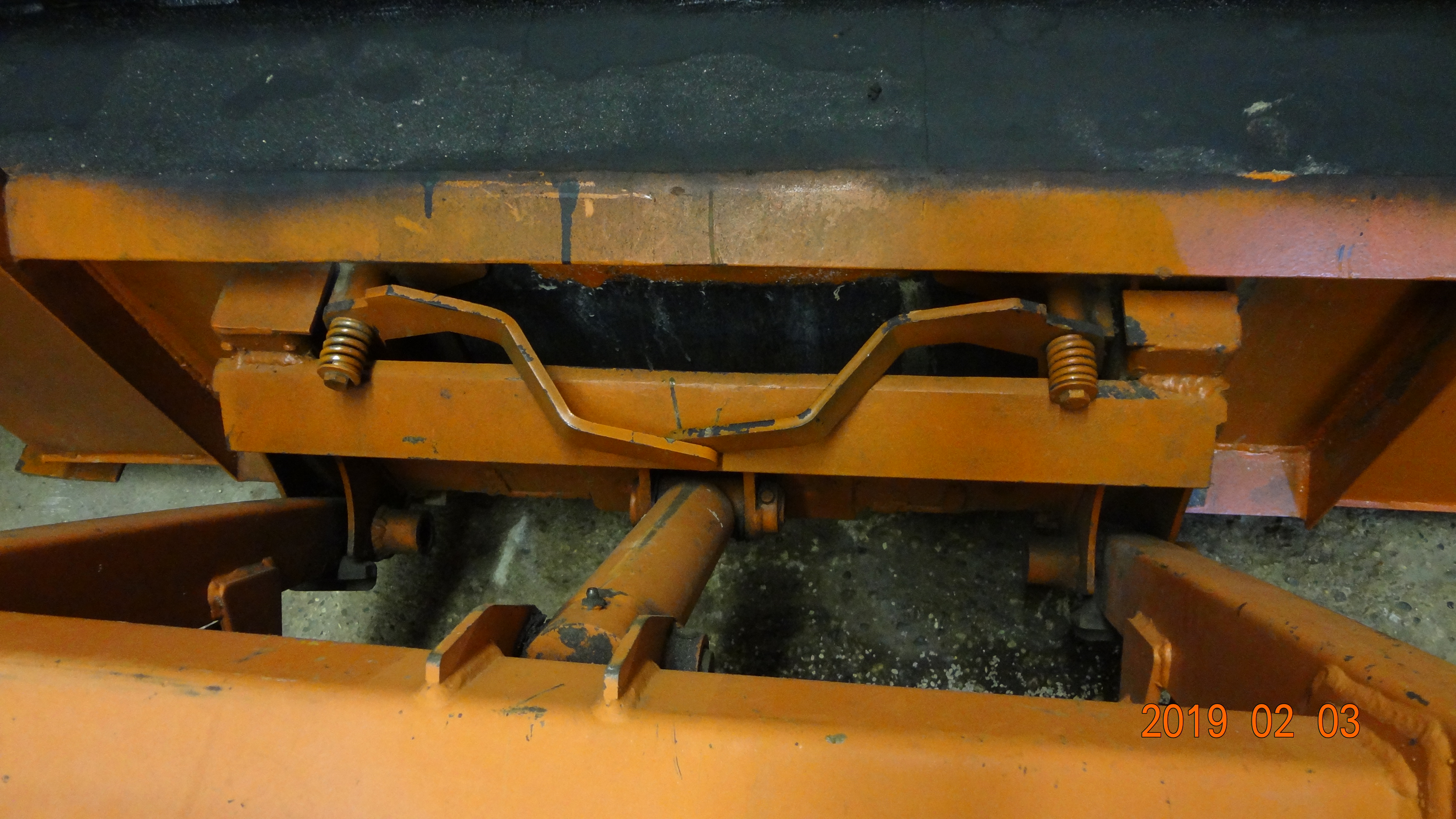

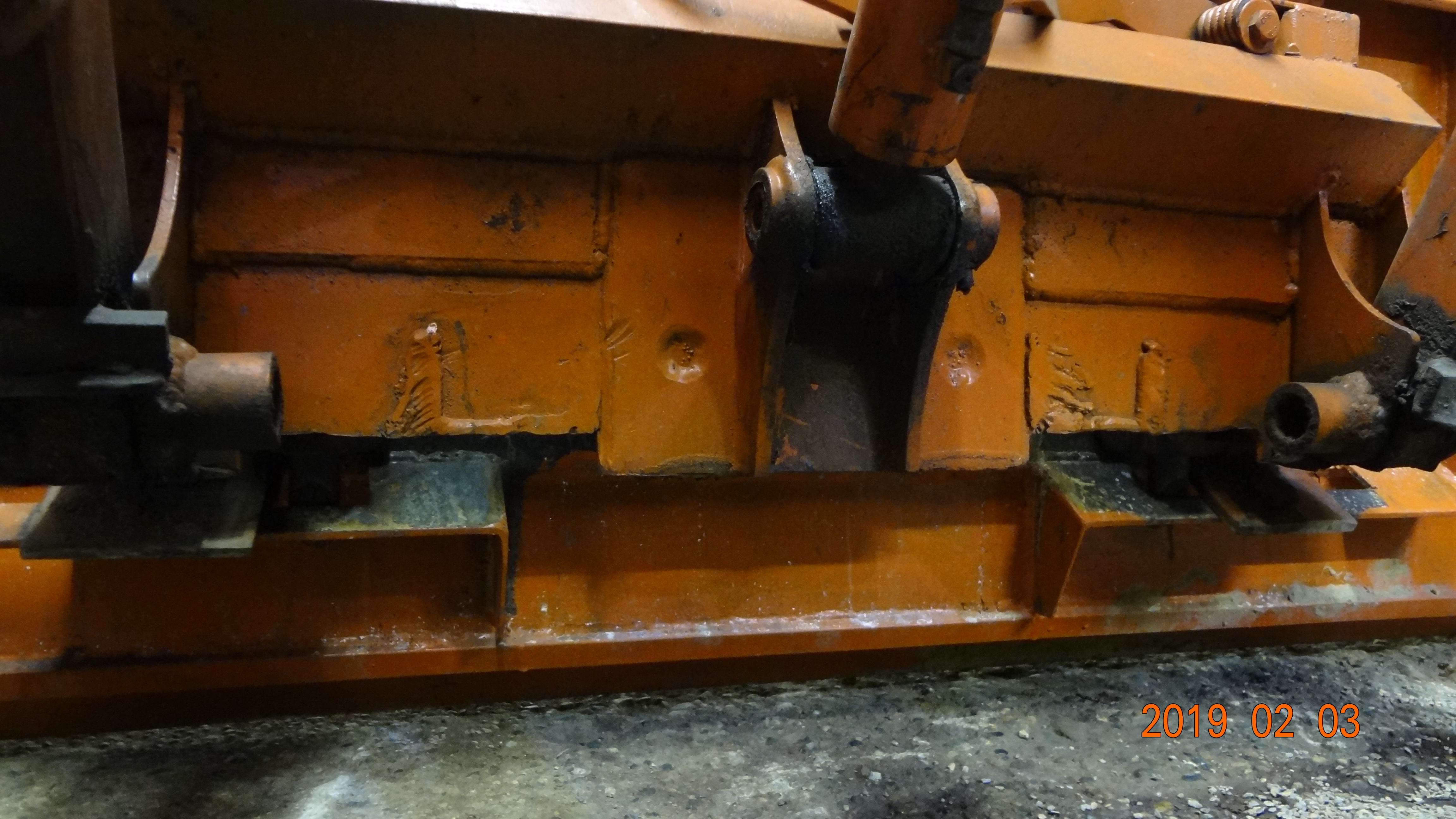

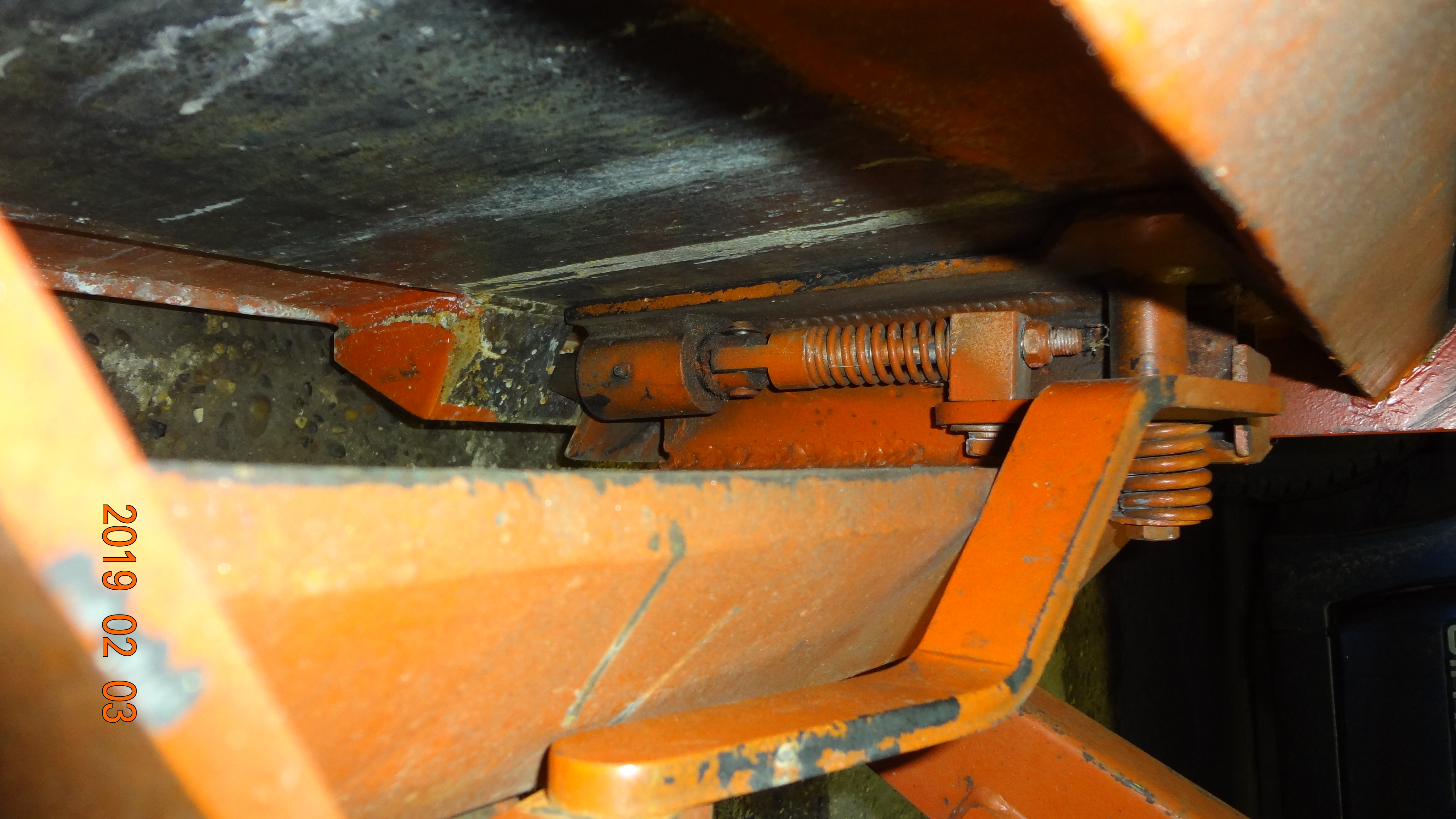

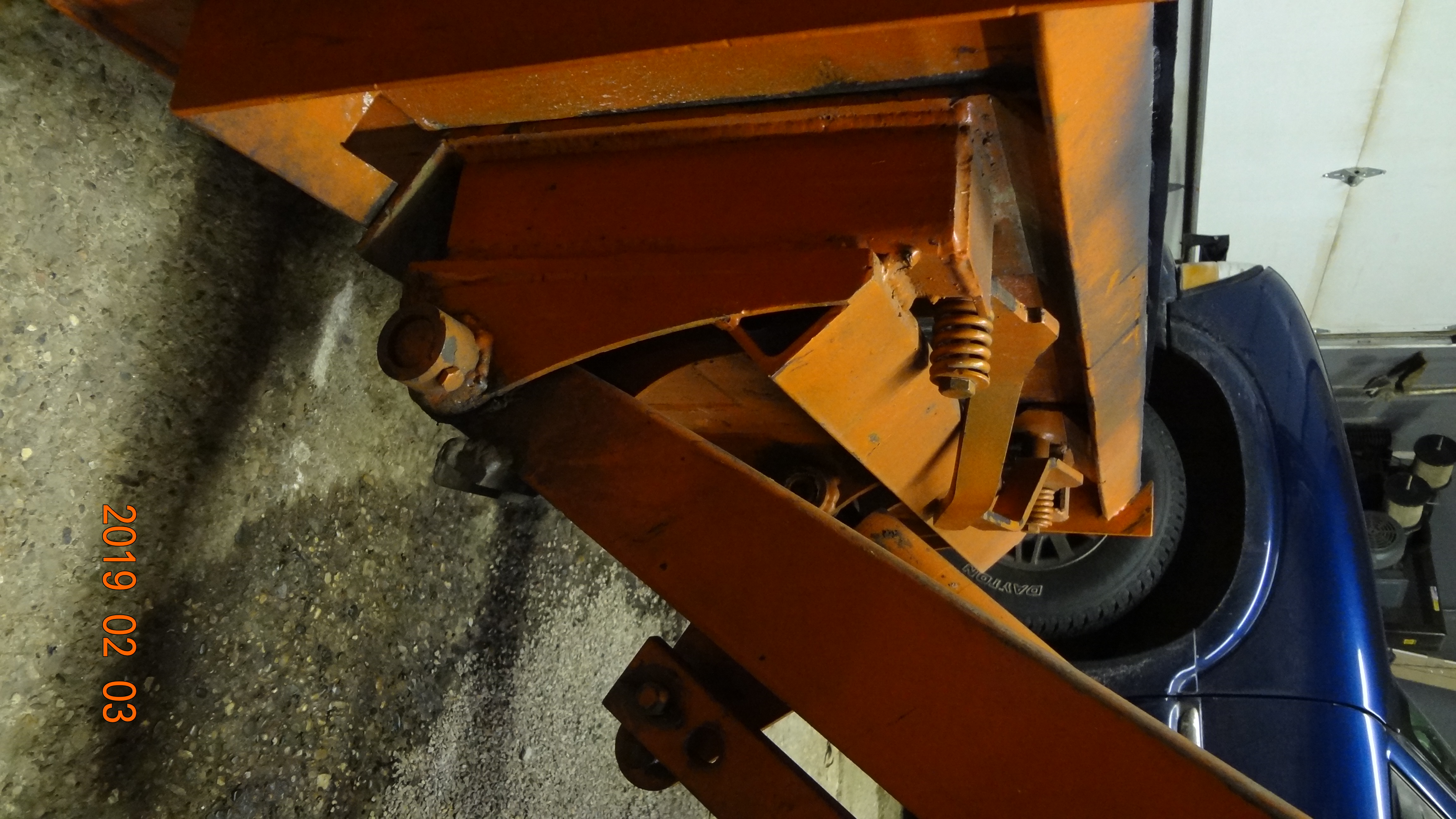

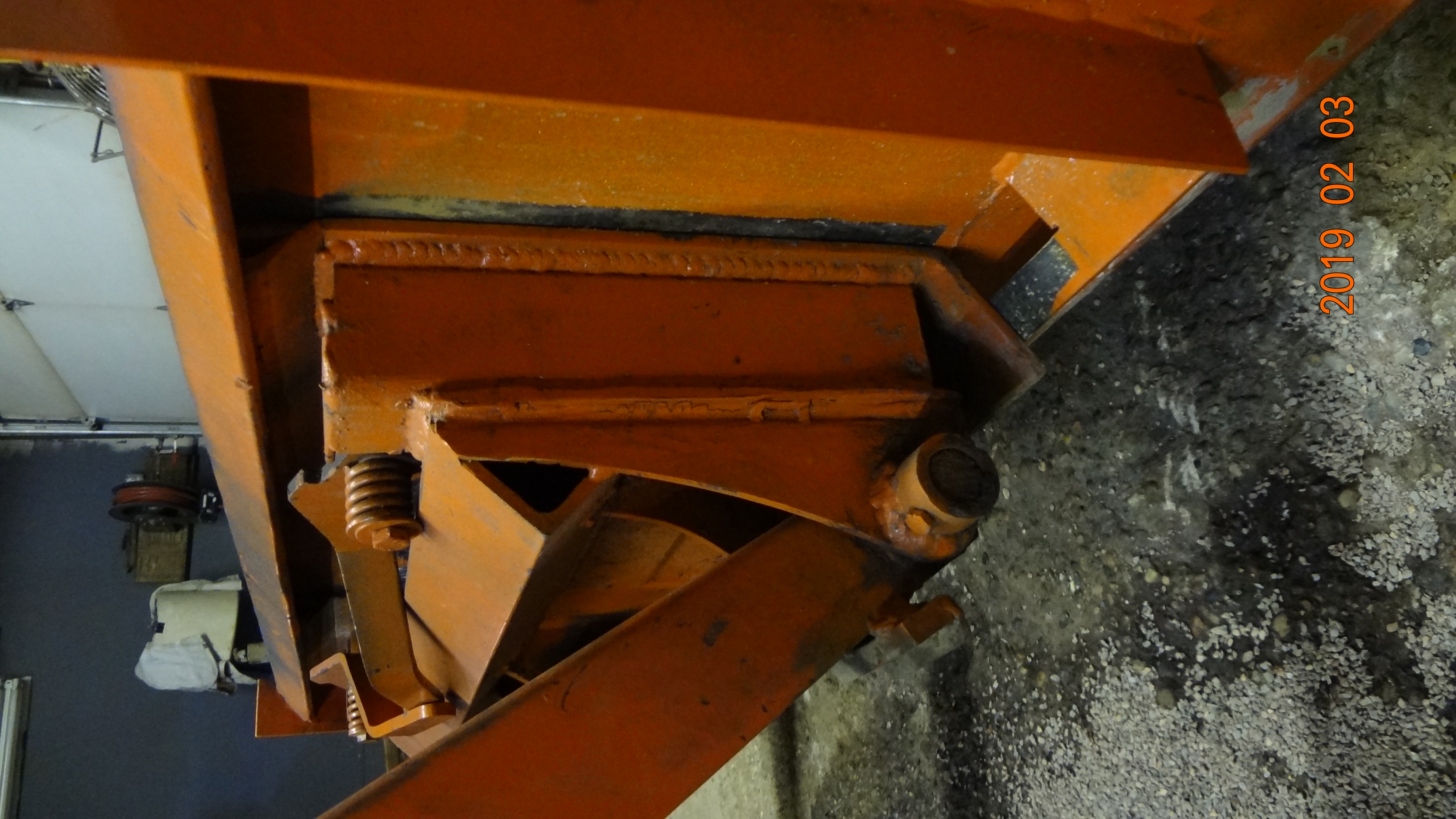

I did. it works. Cut off the back of the bucket to keep the pins aligned. Added 3 inch square tubing and then added the quick attach setup. I made my own previous setup and once I got the kit for my bigger tractor I switched immediately because its just that much better. So you have a plate with the 3 pins, and then the quick attach levers and angle pieces. I'll see if I have a picture around.
   / kubota 6315 quick attach on bx2200? #3
If they need to be bigger, let me know. I can't remember if these shrink down or not. Hope this helps

I believe johann is talking about the bx6315 which is different than what you're talking about.

whoops! I am sorry. But the setup is the same as mine with the single middle cylinder. I thought about going that route until you are stuck with kubota only attachments. I wanted to be able to get any attachment I wanted. Being stuck with kubota only attachments limited what I could buy. Just my opinion though. I thought it was an awesome setup they made, but owning 2 tractors would have been **** trying to adapt one to the other type thing.
