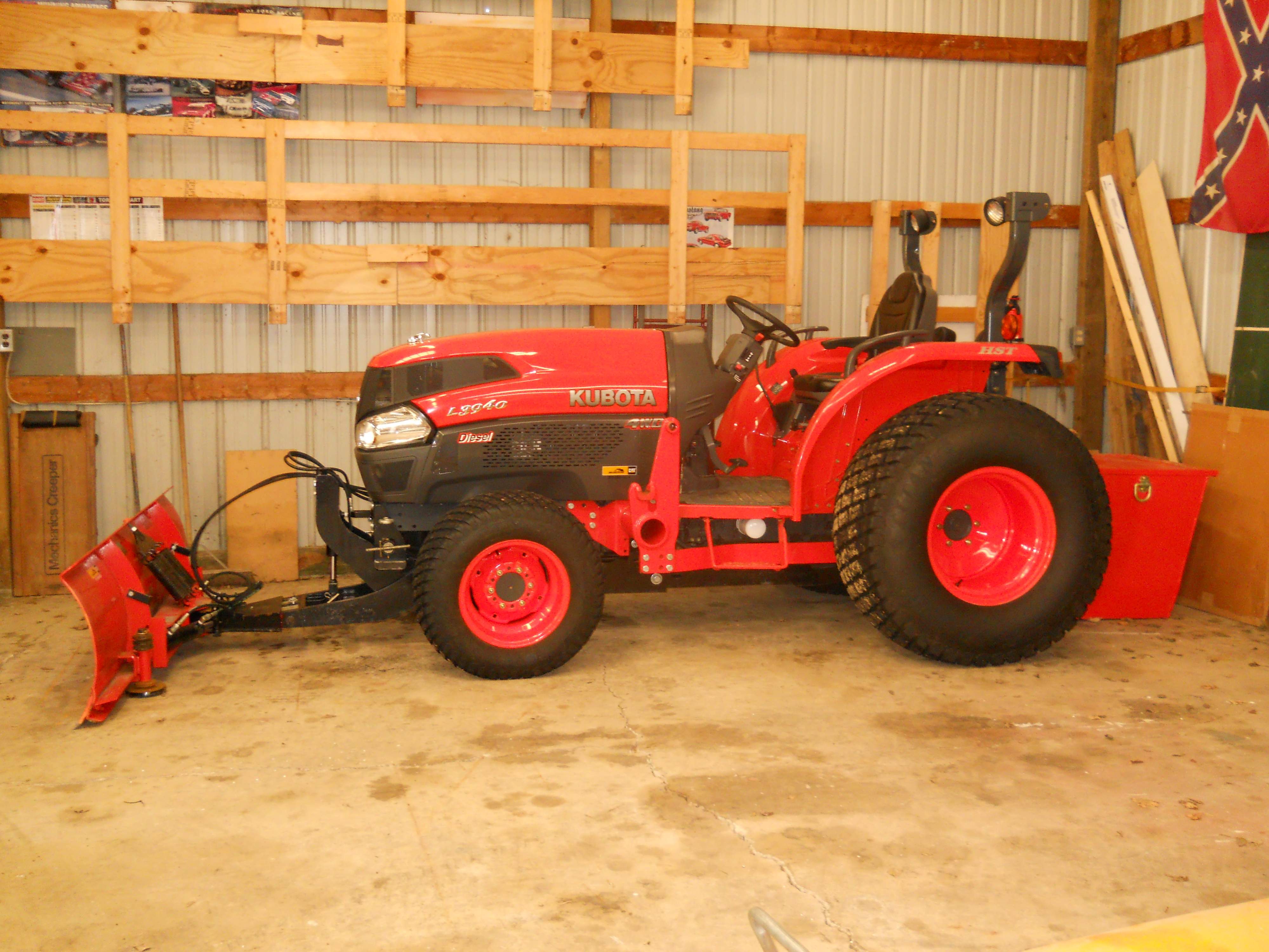

I recently upgraded from a l4330 to a l4730 hstc. Great machine, now I am turning it into a snow removal animal. I purchased a agro-trend 78" heavy duty 3 point snowblower with hydro shoot control. Now I am working on a plow for the machine. I will be converting a fisher plow with a the universal skid steer attach, I already have hydraulics up-front.
I am seaching for a 7'6" blade and having some difficulty locating on that is worthy of rehab, but have found several 8' ers. The specs on the 7'6" and 8' are as follows:
width, height, guage, trip spings, Width angle LBS
7' 6″ 29″ 12 3 8 1 1/2″ x 12″ 6′ 7″ 637 lbs.
8′ 29″ 11 4 8 1 1/2″ x 12″ 7′ 1″ 717 lbs.
I know the loader capacity is more than capable, but just wanted some feedback of what some "real life" users have experienced.

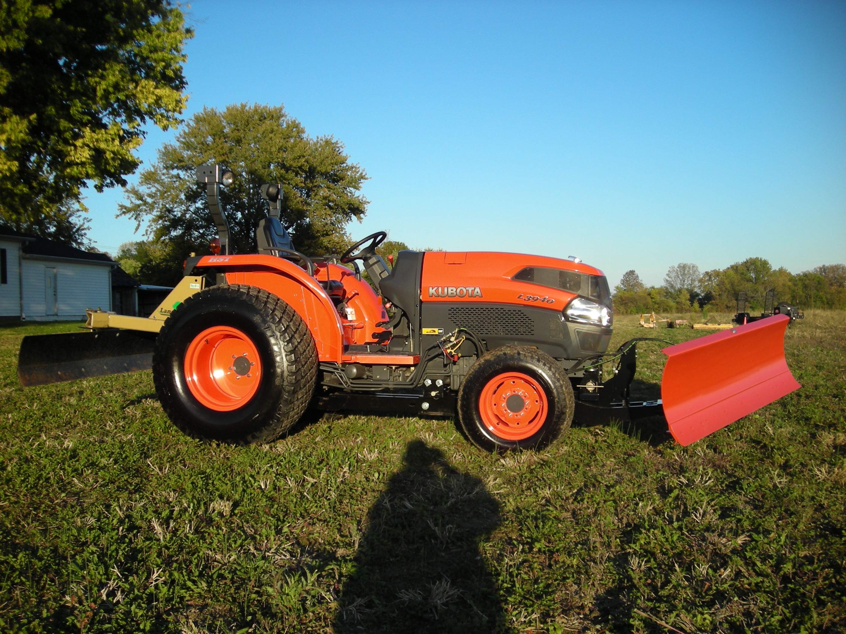

/ kubota 4740 hstc #7
Try and keep the front blade as close to the front axle as possible to reduce the 'rudder' effect as others have already mentioned. I have the oem 7' blade and turf tires, and the only time it pushes the front of the tractor is when the front tires are on ice. I do keep a 1200# ballast box on 3 point, but you should get nearly the same effect from your 3 point snow blower. Philip.
