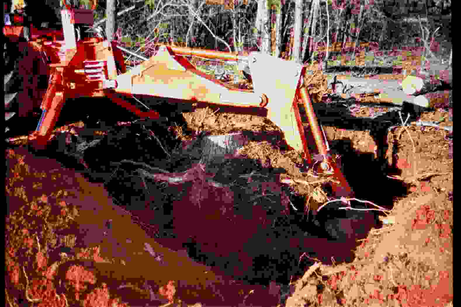

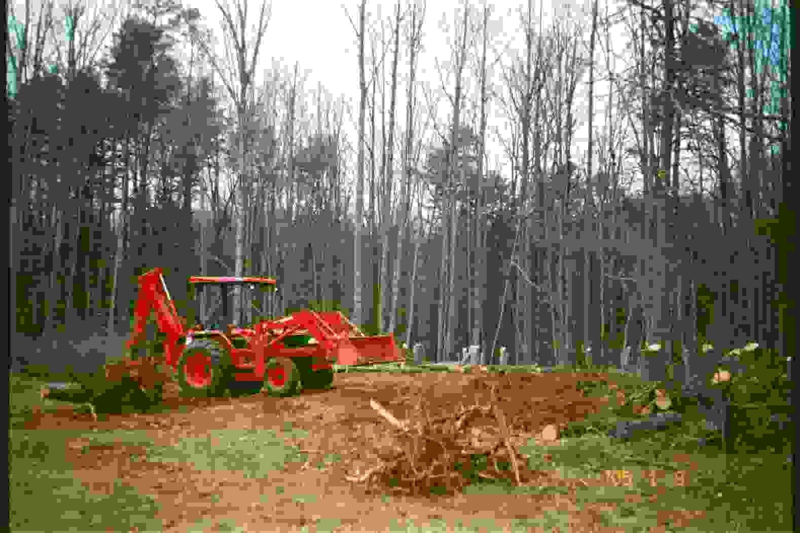

I was not going to comment on the pics, I got the idea! I still am impressed by your work and that of the 4560. /forums/images/graemlins/smile.gif
