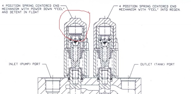

had a problem with float sticking badly, found out about the water/rust problem in the cap so i removed the cap sure enough everything in there was rusty/sticky so i cleaned the ball beaarings and the detent sleeve. when i reassembled , now it will not stay in float at all, so ordered the correct detent kit from kubota thinking maybe the parts were worn, reassembled again , same result, no detent, im pretty sure i assembled correctly i have the parts diagram looks pretty streight foward but something isnt right, seems like something has to push down on the large ball at the top of the spring to give the small balls enough outward pressure to catch ridge, (my valve is mounted so the detent cap is at a upward angle), any help would be greatly appreciated, seems like im missing something simple, thanks..

im not sure of correct terminology, i removed the cap with 2 alan screws, then thiers a sleeve with a ridge inside it , which im guessing provides the detent, then i slid that off and theres the 5 ball bearings ,4 sit in holes on the sides of the end of the spool (i think) and 1 on top with a spring sitting down under it. i tried to reassemble the way the parts diagram shows but the balls dont seem to be catching on the ridge, i greased them to help hold them in while i reassembled could that be causing a problem? ill try to insert my valve diagram but im a rookie at this to!

Is that valve a Kubota generic valve or a Prince valve or some other brand?
/ kubota 3710 float detent reassembly???
im guessung its kubota, when i looked up my loader (la682), on kubota's parts search, the diagram for the valve is my setup, thats how i ordered the detent repair kit, thats the diagram im going by for reasseblly.
#9
looked at the bag all the parts came in and it says husco on it.
/ kubota 3710 float detent reassembly??? #10
#11

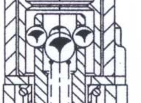

oh my god!!! that is awsome.. that valve is very similar, mine is not that clean,ha ha, but that diagram shows the big ball under the 4 small ones and i have mine sitting on top doin nothing, now i seeeee, next question, whats the trick getting the big ball under the little ones, i think i should be able to figure that out.. thank you , thats the bop in the head i needed..

Going to need a "third hand" you are looking at it wrong. The large ball would just fall out for nothing retains it, so you put the large ball on the end of the springs and cut a short piece of tubing that you can depress the large ball(third hand) with the sleeve on install the small balls and slide the detent sleeve to compress the small balls.
/ kubota 3710 float detent reassembly??? #15
spring in, big ball, depress with a small screwdriver, 4 small balls in the holes then the sleeve over the top (ensure the sleeve is the correct orientation), then remove the screw driver. In the factory we use some grease to a) help with assembly, b) reduce corrosion, c) reduce friction when not in detent.
