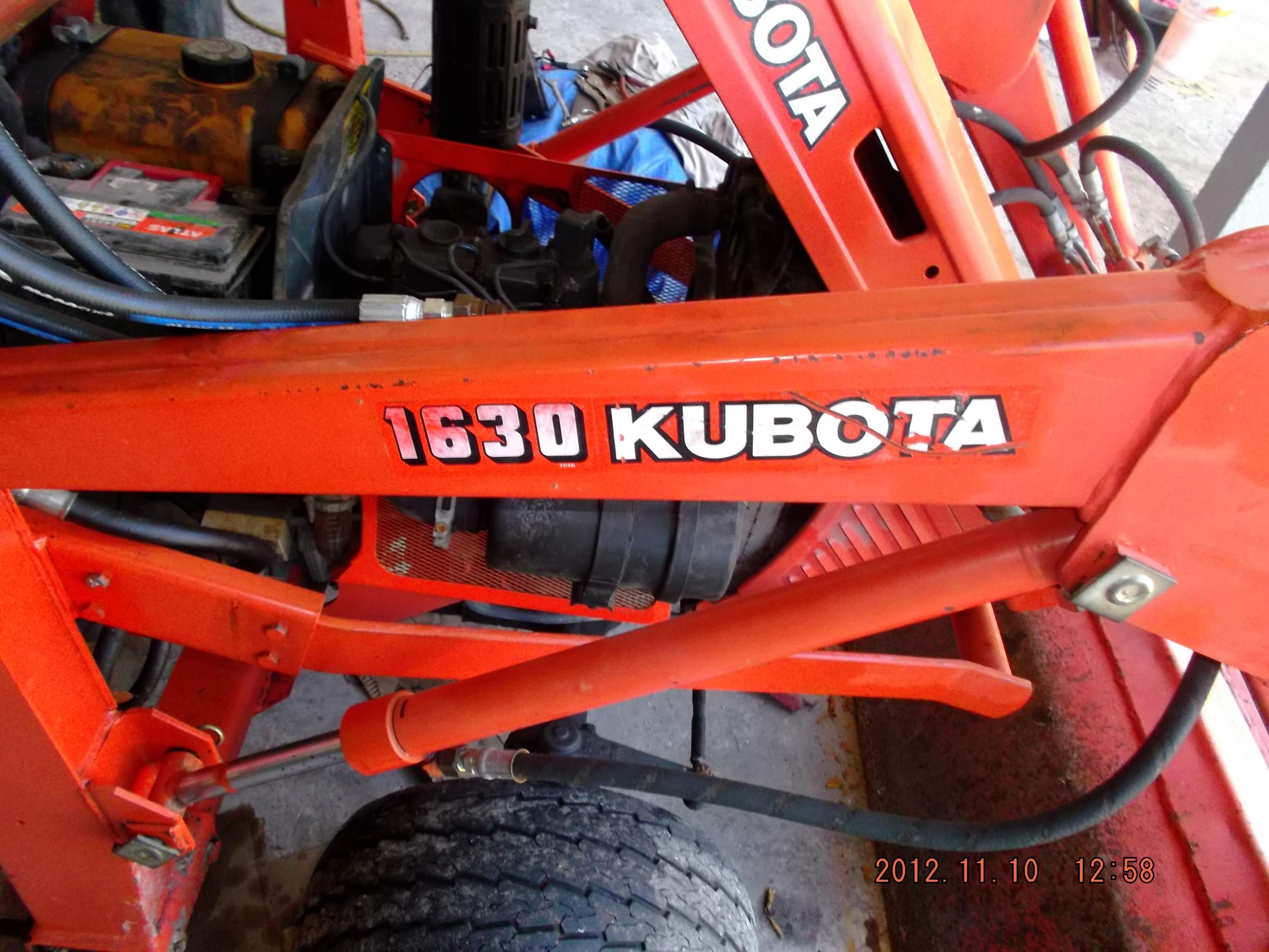

OK I'm in a wee bit over my head here! I got my hands on a 1630 KUBOTA loader attachment but all the hoses are disconnected and no manual |I can't find a manual that actually shows me where they go. Anybody have a PDF diagram> Any help at this point would be greatly appreceated! I,m in Central America and there ain't any help close by!
Thanks!

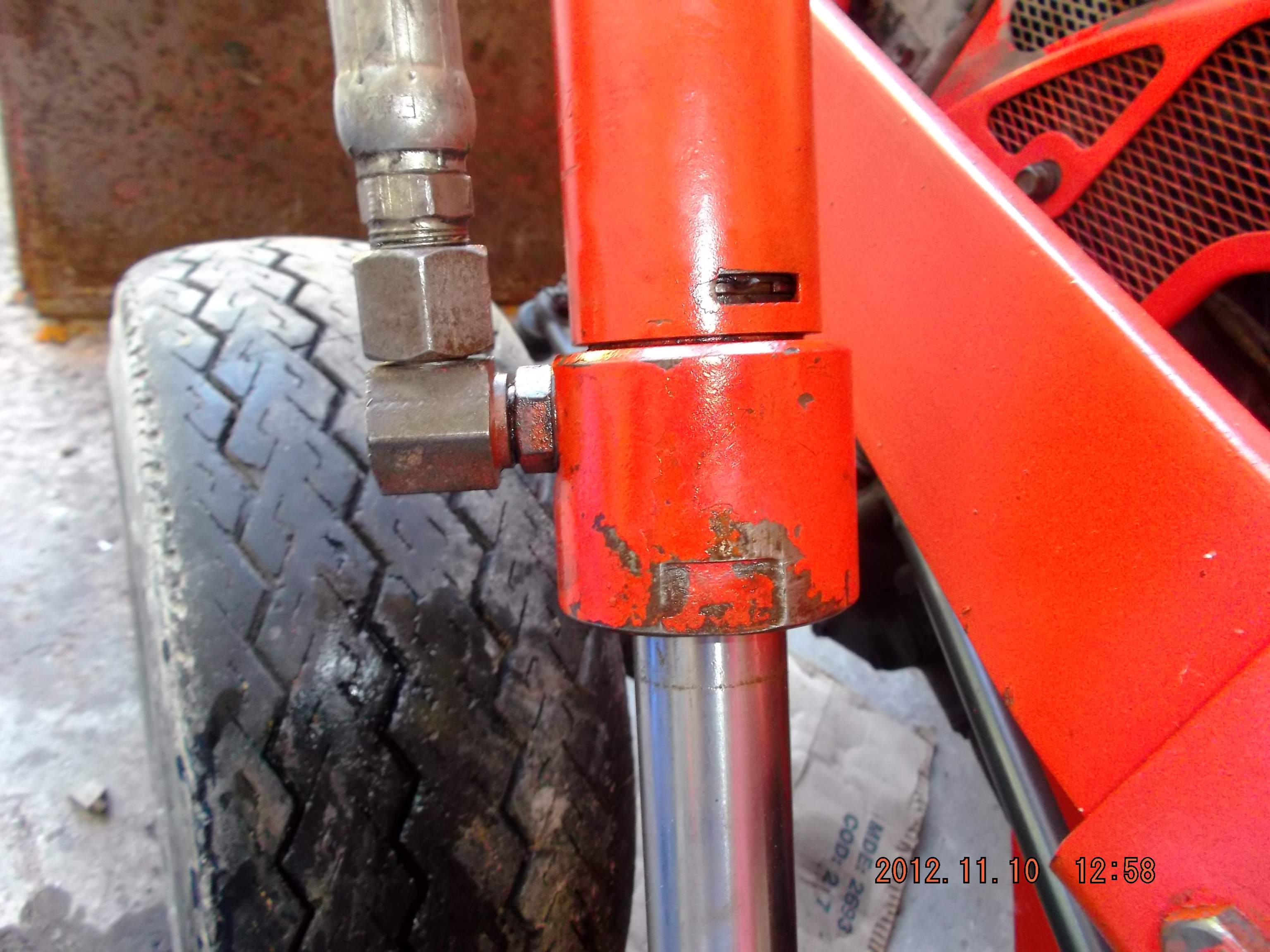

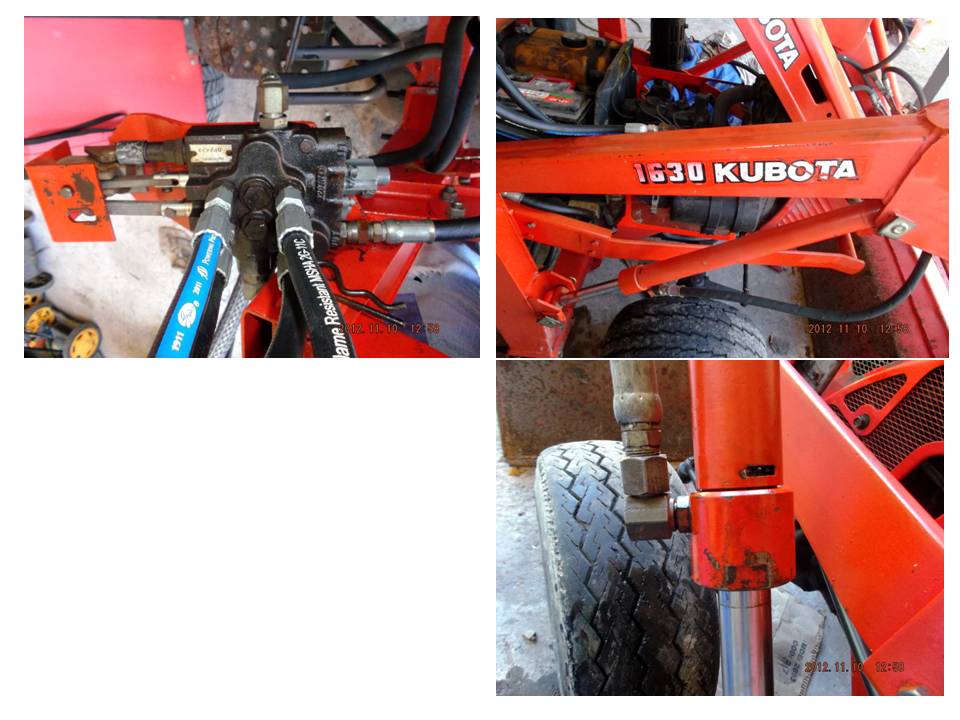

I'm a little lost but I think I have all the hose assignments right. Hoses A,B,C,D I connected the loader to a KUBOTA B7100 HST. Just fired it up and the bucket jumped upward by itself. "Almost ripped my bumper off!" I had to boost the battery at the time!
There's a little play on the piston. It feels like the pressure is way too high! Dang thing sprung a leak on the bigger left Hydraulic post "A" too!

Did you make sure that the loader valve, and tractor is open center hydraulics?
Lets make sure you have the hoses connected correctly.
If the valve was in neutral, the fluid would just flow through the valve to the next valve.
The flow from the pump should go to the IN port.
Return /tank port hose should go to the return or tank line.
If you have PB, and adapter, this hose should go to the 3pt input.
A and B on one spool should go to a tee then going to one cyl set.
C and D should go to a tee and then go to another cyl set.
Check your relief valve setting, as that will be your hyd system relief. Somewhere around 2200 psi

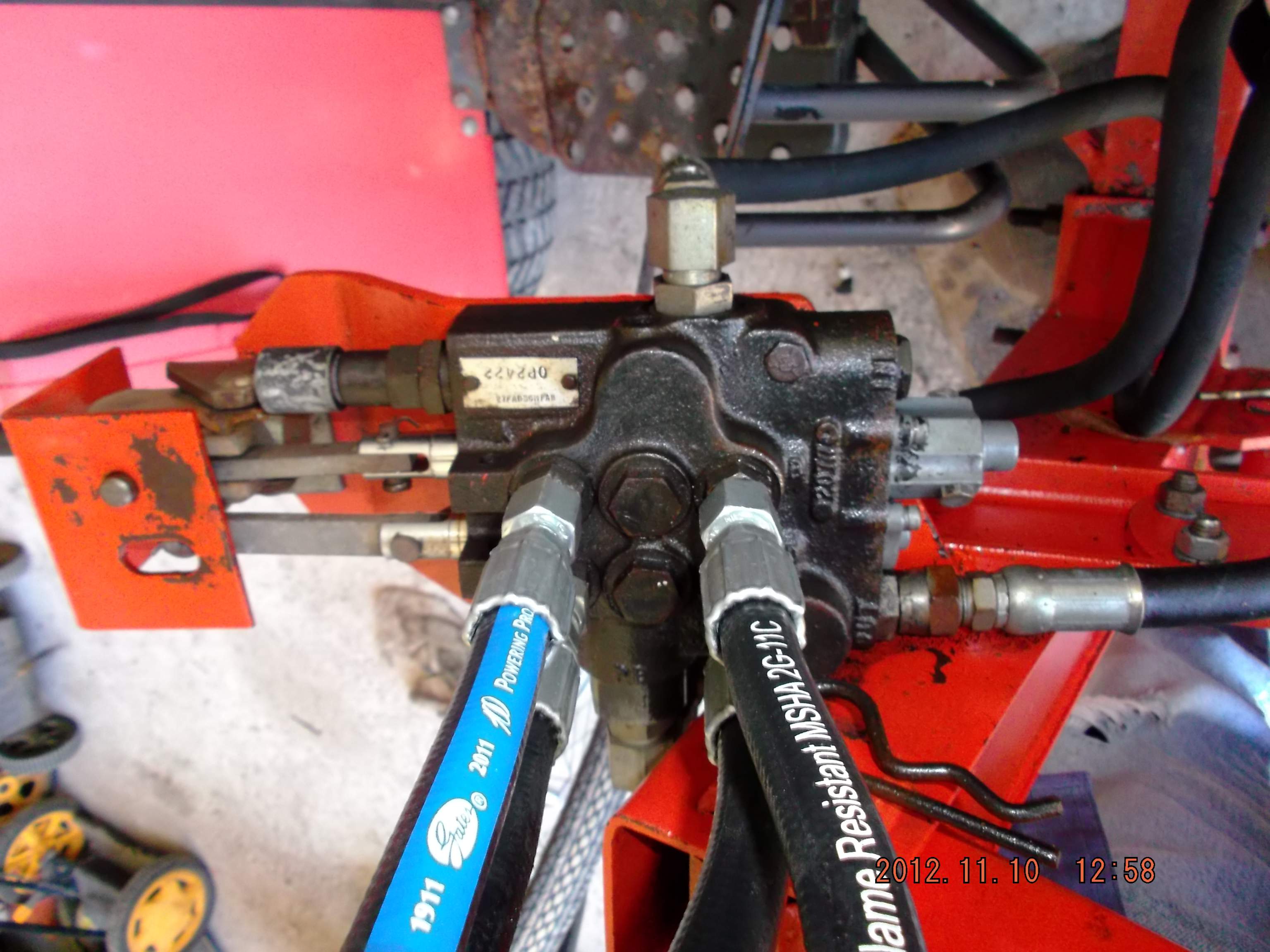

J_J do you have any ideas on where I can get an exploded parts view of the Single Lever Control Valve as pictured above? I'm guessing I need to replace some seals and quite possibly the First spool. It looks worn out at the very end but I don't have anything to compare it too! I'm beginning to think this part is a "Grey Market" model.

I don't believe you can just replace worn spools, as they are supposed to be a precision fit.
If your spools have o-rings, those can be replaced.
Is your spools leaking externally?
Try this place.
Kubota Parts for Tractors and Equipment
What brand is the loader valve.

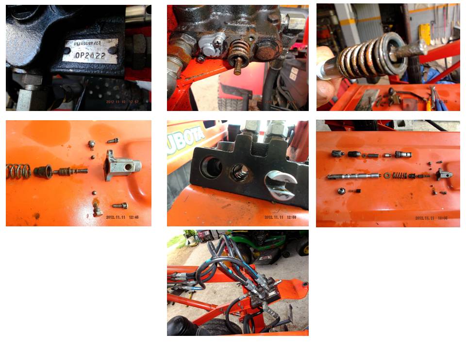

OK I got a little side tracked! I could not find any other tags showing manufacturer. I took some of it appart and here's what I found.(see attachment) There is a very worn out part at the end where 2 small ball bearings keep the actuator or spool in place. When I went to reassemble it I tightened the same tip and then losened it a quarter turn so a less worn portion would line up with the balls. After complete assembly I tried it out and the bucket no longer lifted by itself. The worn out tip on the spool was the problem! But! The loader still seemed to lift and drop way too fast and I'm thinking the problem with the pressure could be a missing "orifice". I'm guessing an orifice in the "A" or "B" side could slow the flow down some????? Also, if you look into the hole for the spool you'll notice there appears to be some O rings inside. I'm not sure if there may be one missing but without a a parts diagram for this unit I'm kinda dangling here!

You're wandering into dark territory here trying to repair that yourself
that worn spot and rusty parts may impede the stroking of the spool or not hold the spool during the "float" position or keep it engaged not spring centered.....but orifices missing is not your trouble
that oring blew out for a reason (ie: hoses hooked up wrong creating too much back-pressure in the return port)
the orings you see are just near the outside of the valve to prevent oil from getting out before it is diverted back to return tank.......technically that valve would work (other than it would puke oil all over the place) with out any orings in there, so the real trouble is getting troubleshooting done before you start yanking stuff apart
First you said it went up on it's own, now you are saying is goes down by itself (too fast?)......maybe you have cylinder troubles too
Looking at the condition of that corroded spool, you'd be better off getting a replacement valve anyways, those spools are precision fit and not a replacement part, then rule out crossed connections of hoses and/or cyl by-passing
Don't make this harder than it already is......try to find out what works and what doesn't work first

Since I backed off the tip of the spool there ain't no more lifting or dropping of the bucket by itself. But I'm still having problems with too much power. Lifting or dropping etc. No matter what direction I push the joy stick in,,,,,It just goes way too fast. The whole tractor jumps and jolts! Are you sure the orifice won't play any role in slowing down the action? A pressure release valve? Or could there be blockage in the pump or a return line mayabe?
/ KUBOTA 1630 loader attachment #15
What is the tip of the spool you are talking about?
It is hard to believe that 3 GPM from your tractor pump and you feathering the valve, that you have to much power of fluid flow.
Yes, restrictors or needle valves will reduce the flow rate to the cyl's.
The purpose of the valve lever is to provide a certain lift rate.
