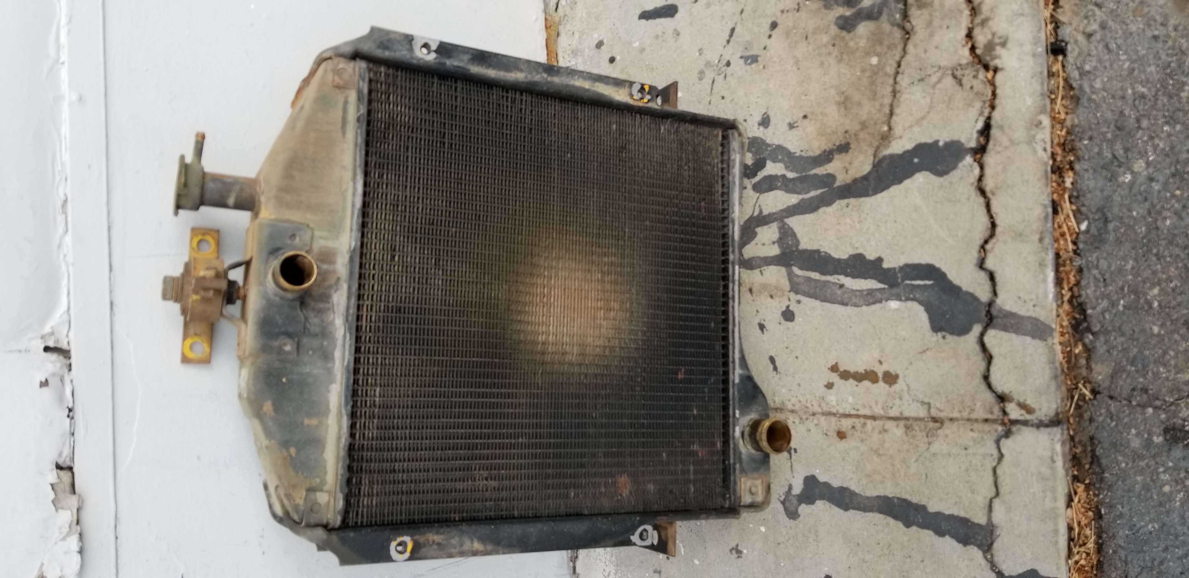

Now for the latest Cooling and exhaust system maintenance and restoration. I do the best I can to keep my equipment up and running with proactive preventive maintenance. If something needs attention take it apart address the issue, then put it all back together in a timely manner just in case something happens to me, that way my wife will not have any trouble unloading all this boy toy stuff "over my dead body" How thoughtful of me is that?

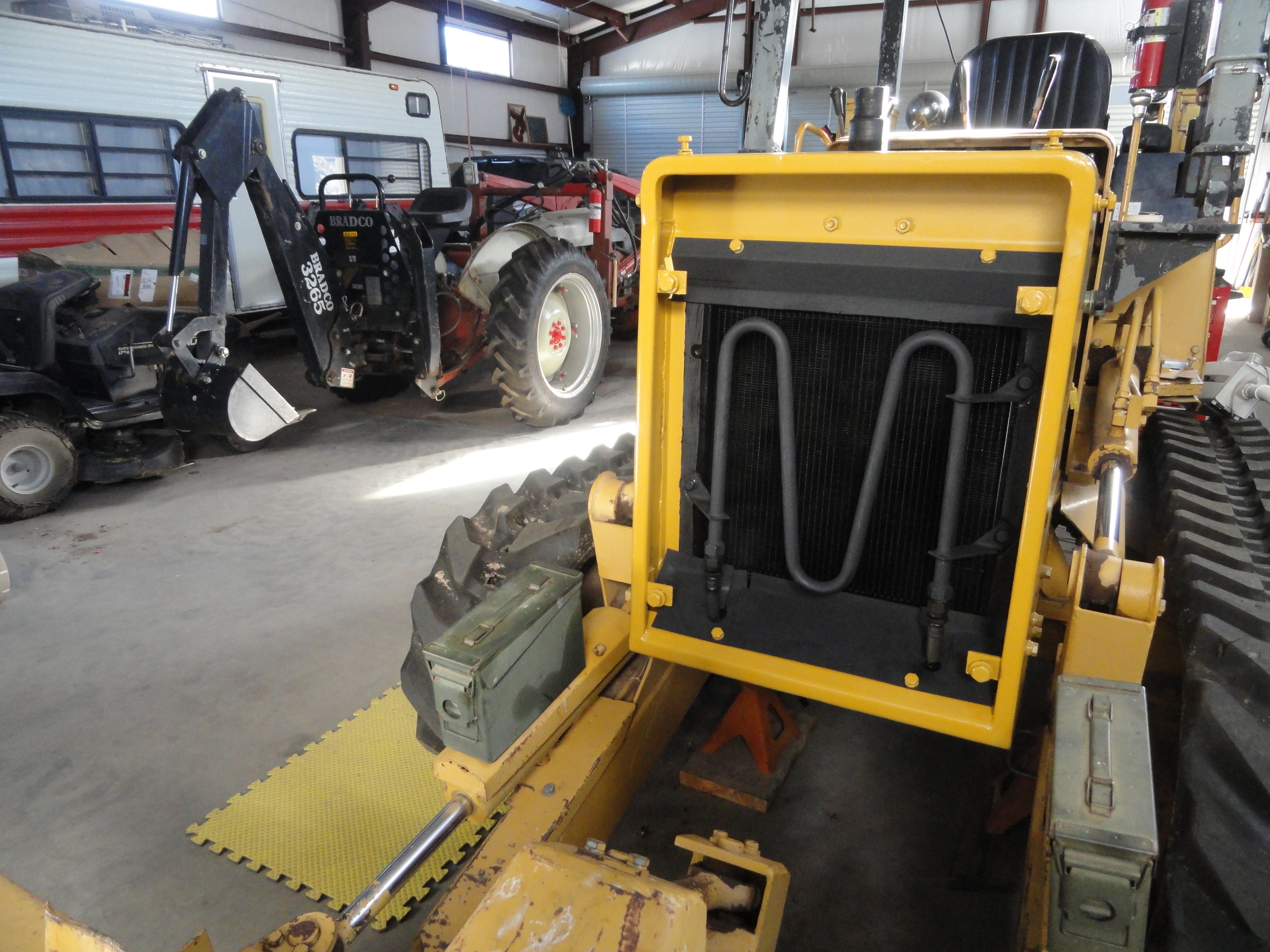

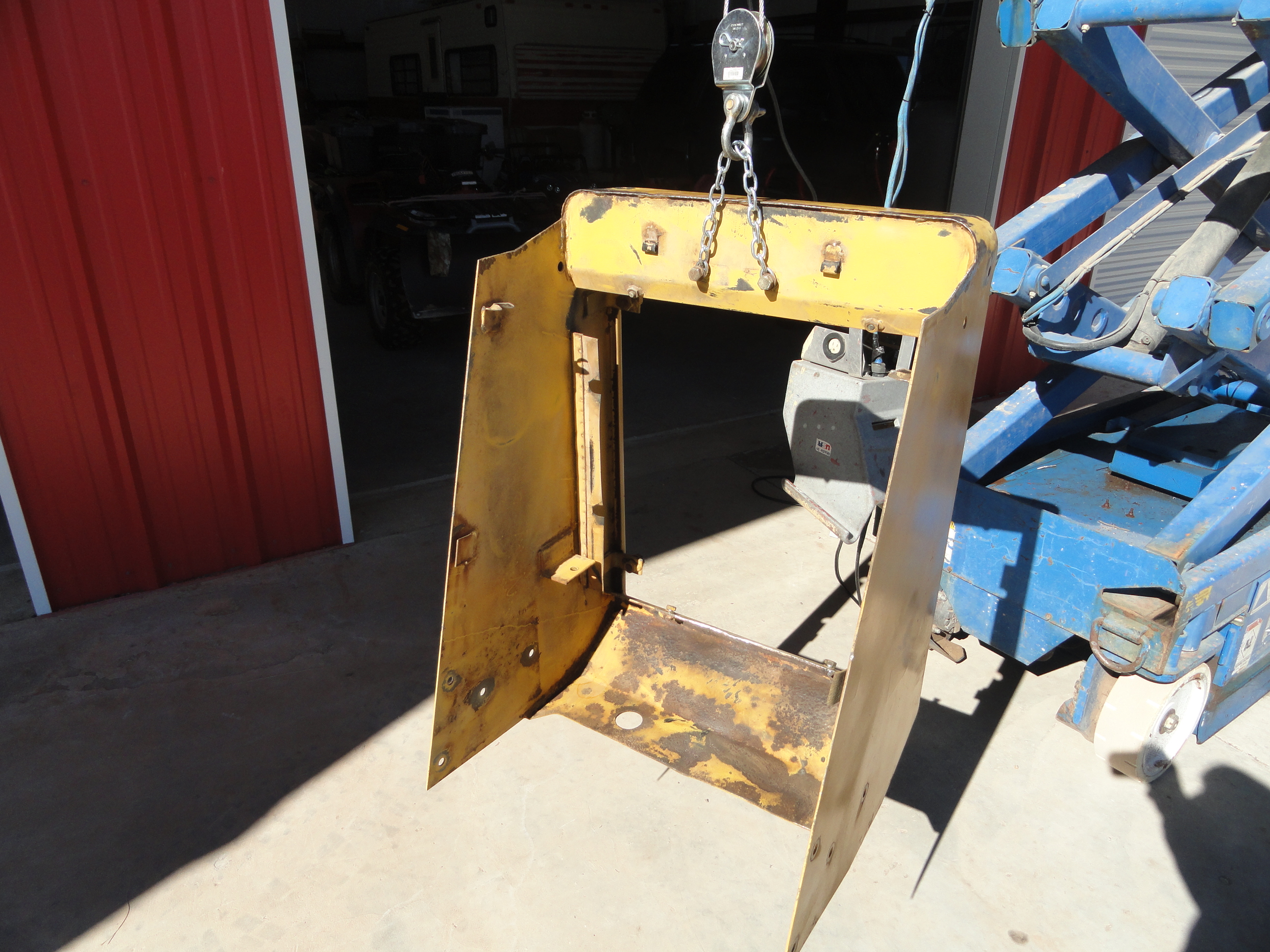

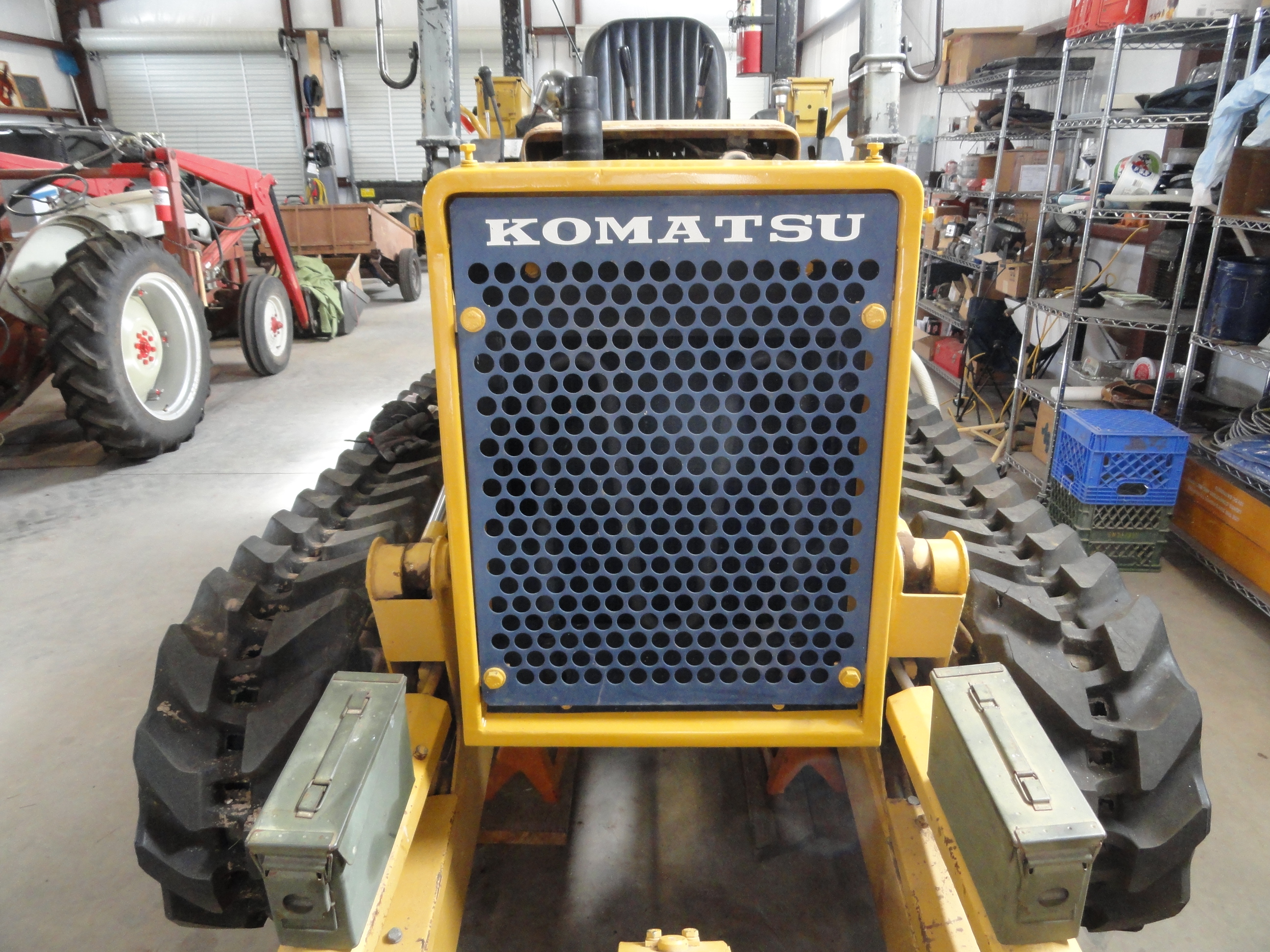

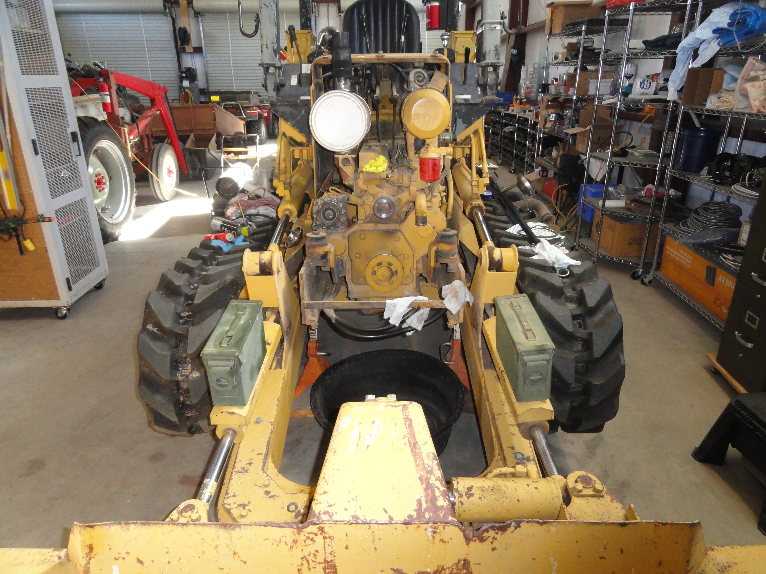

The Winter of 18-19 set in, the ground is frozen hard, snow pack on top, its cold, windy and no outside projects lined up for the dozer, so decided to perform preventive maintenance on the entire cooling system, then exhaust.

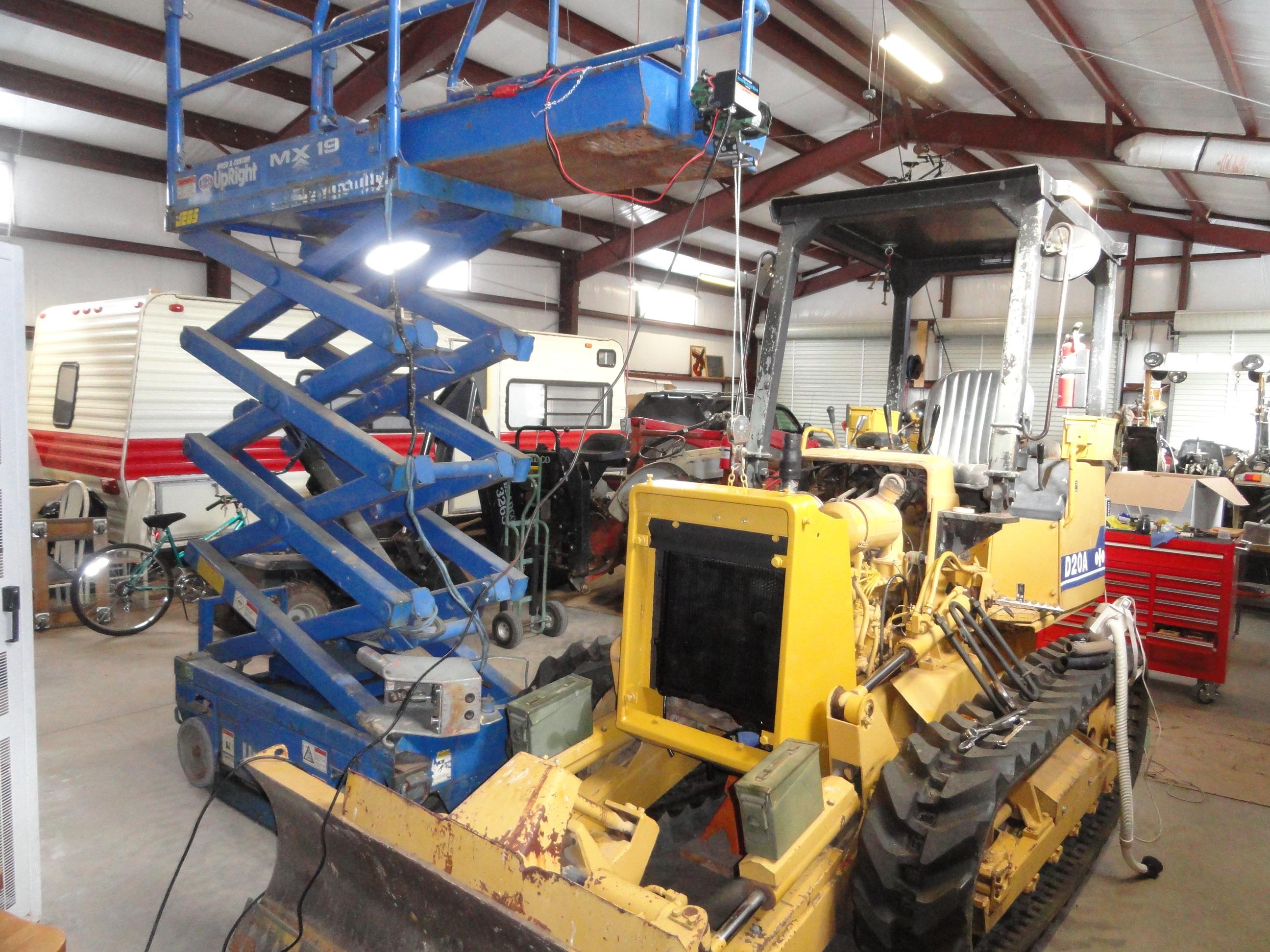

First was to drain the radiator, loosen hose clamps and a wire for the head lamps. After that I fitted a small winch on trusty old scissors lift to remove the entire front cowling with radiator attached, its held on by eight bolts, four on each side. Amazingly simple to remove the entire assembly, just need a means of lifting it up and out of the way.
First couple of pics show what it all looks like with the front cowling assembly remove. And of course, to show off the spacious man cave shop to work on it. It's still up on blocks from replacing the steering clutch yolk bearings. Sorry no pics of that project it would have been boring anyway. I do have a picture of the custom yolk pulling tool I had to fabricate. If interested let me know and it will get posted.

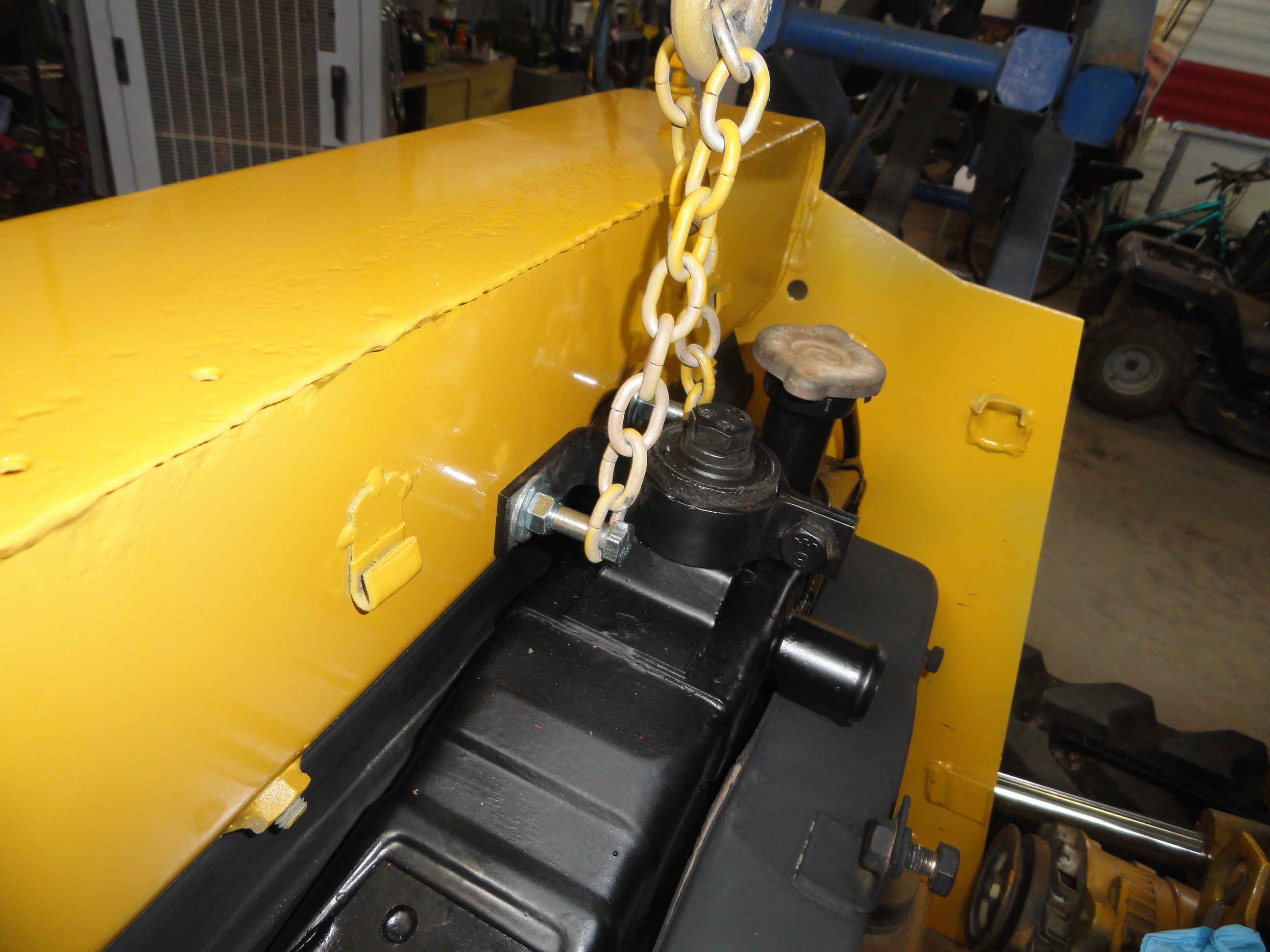

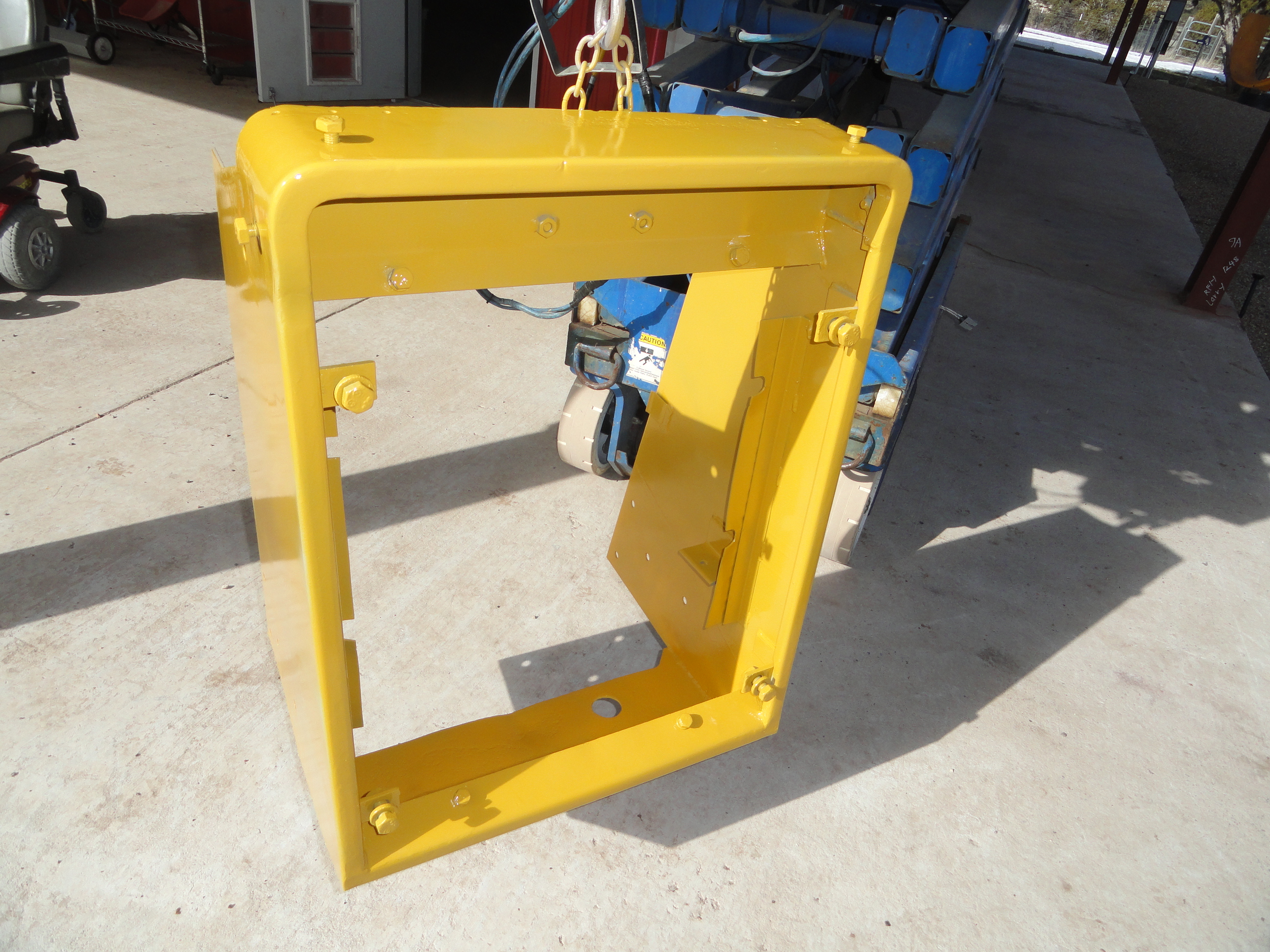

After unbolting the radiator from the cowling, the cowling was cleaned up, sanded, primed with Red Rust-Oleum, followed by Gray Primer then the finish coat.

While the Alkyd Enamel was trying to cure, believe you me paint does not dry(cure) when its 18* outside. Do not let the sunny pictures fool you "Baby its Cold Outside" We are at 7000 feet and its the middle of January this just happened to be a sunny day. I finally wound up lowering the whole thing down inside a very large cardboard box with a ceramic space heater to bake the enamel @ 120* for about 7 days. In the meantime, the radiator was taken to a local radiator shop to be rod-ed out, flushed, pressure tested then painted. The nice thing about painting in the dead of winter there are no bugs to land on, stick to and ruin your perfect paint job. Looks nicer than I could have imagined.

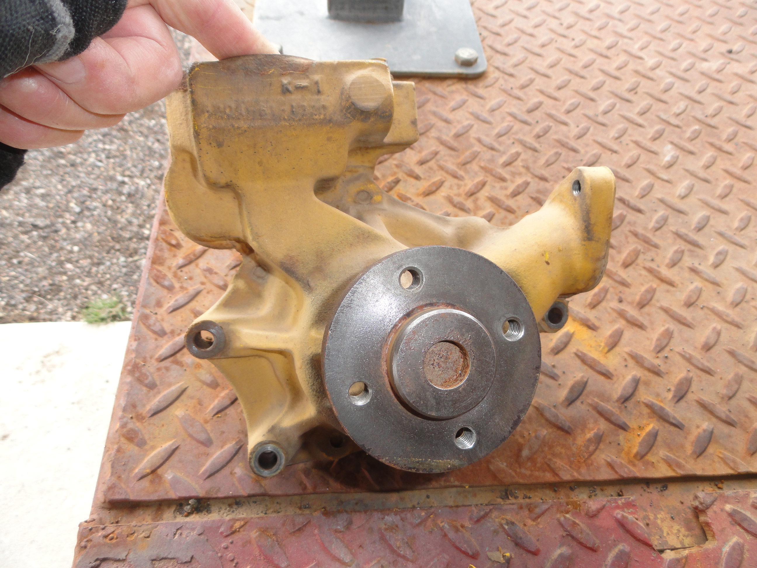

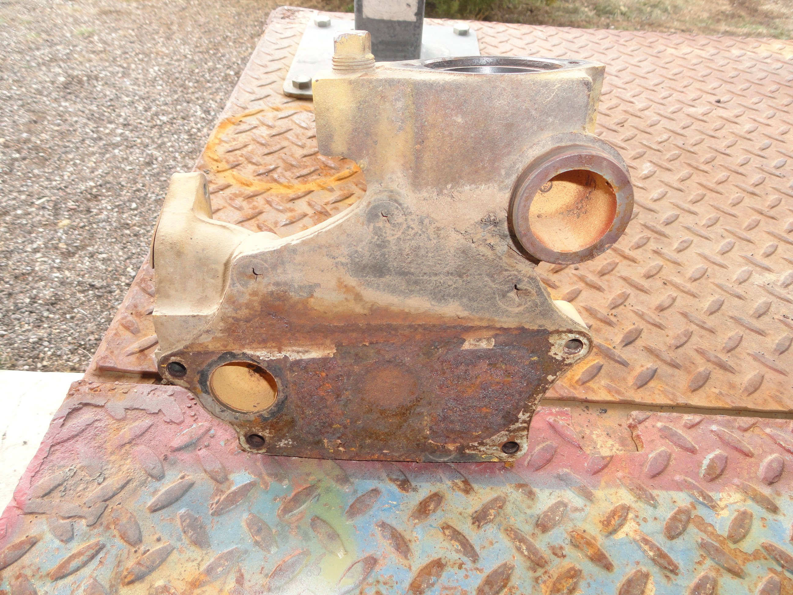

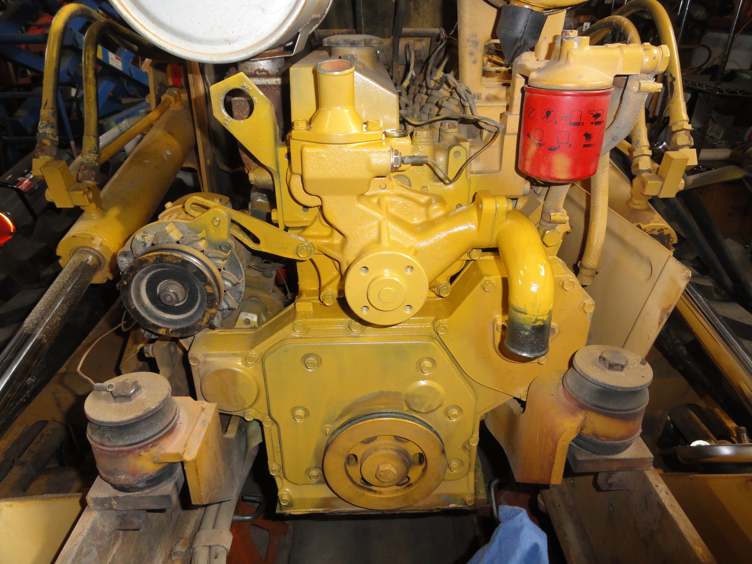

While the Radiator was at the rad shop in Albuquerque, the water pump was removed Pic1 and replaced with a brand new one from Amazon. Amazing to get a brand-new water pump online for a very reasonable price. The old one will get rebuilt for a spare or re-sale. A new 82*c thermostat and bullet proof Kevlar fan belt was installed at the same time. Pic 2 Water pump rear view, a bit rusty all the gaskets and O-rings were very much disintegrating. Pic 3 New water pump installed and ready to start putting everything else back together.

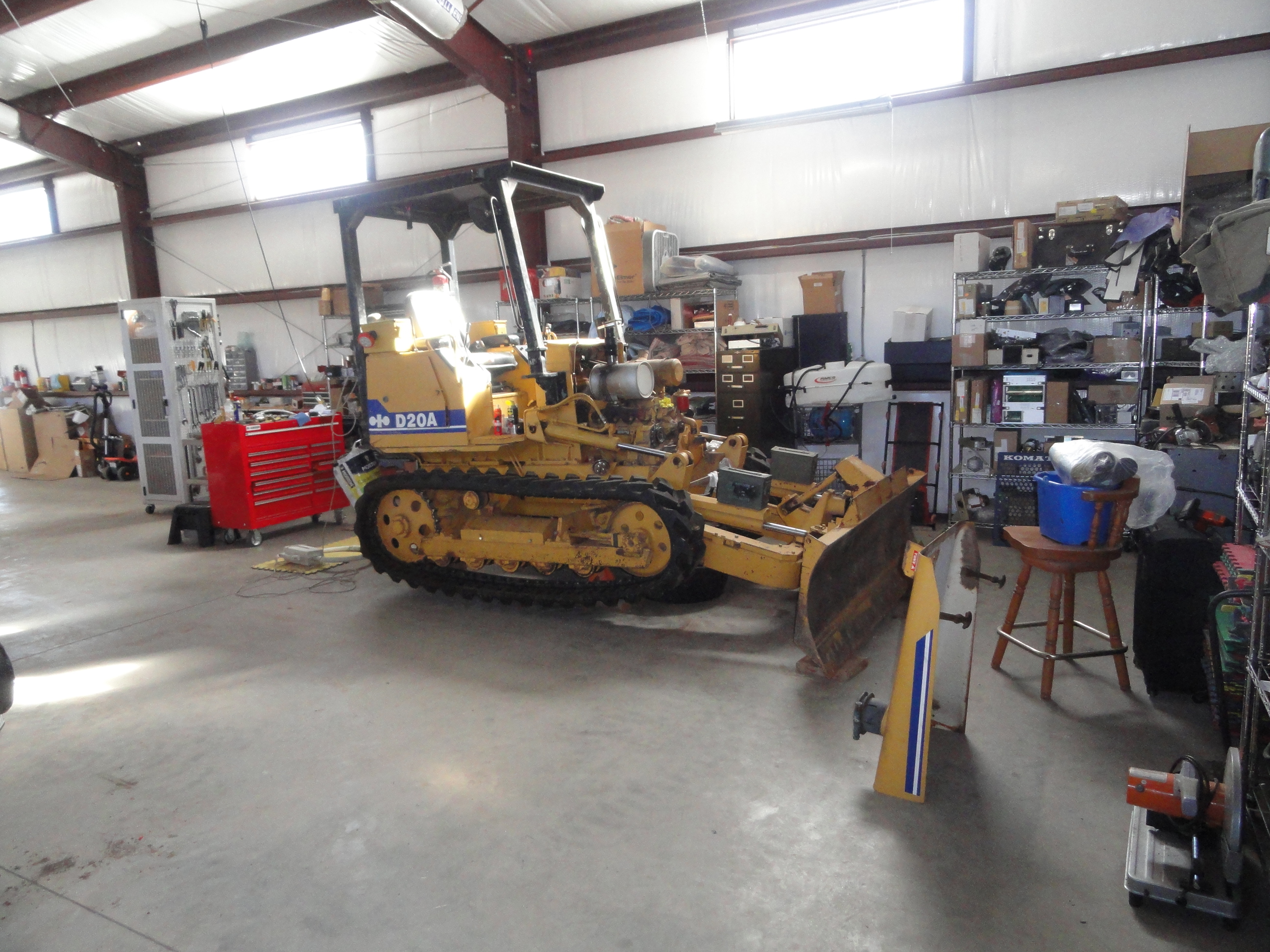

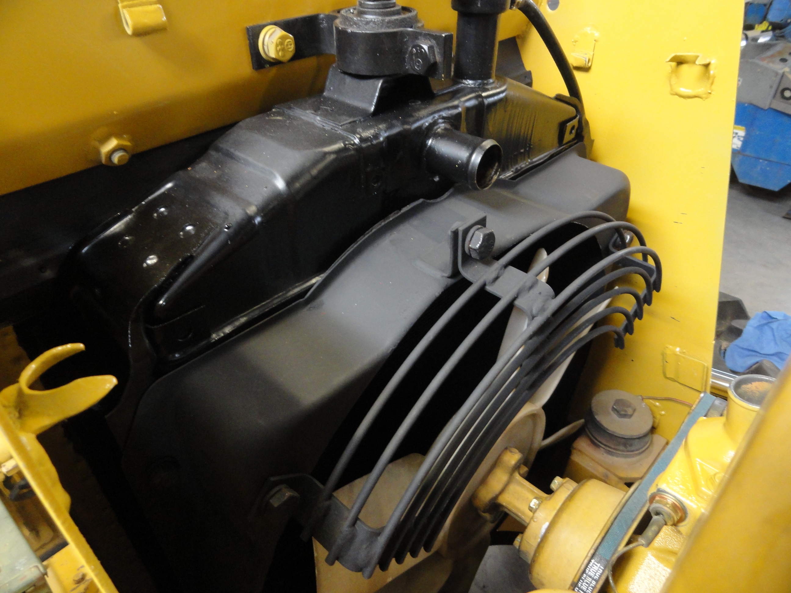

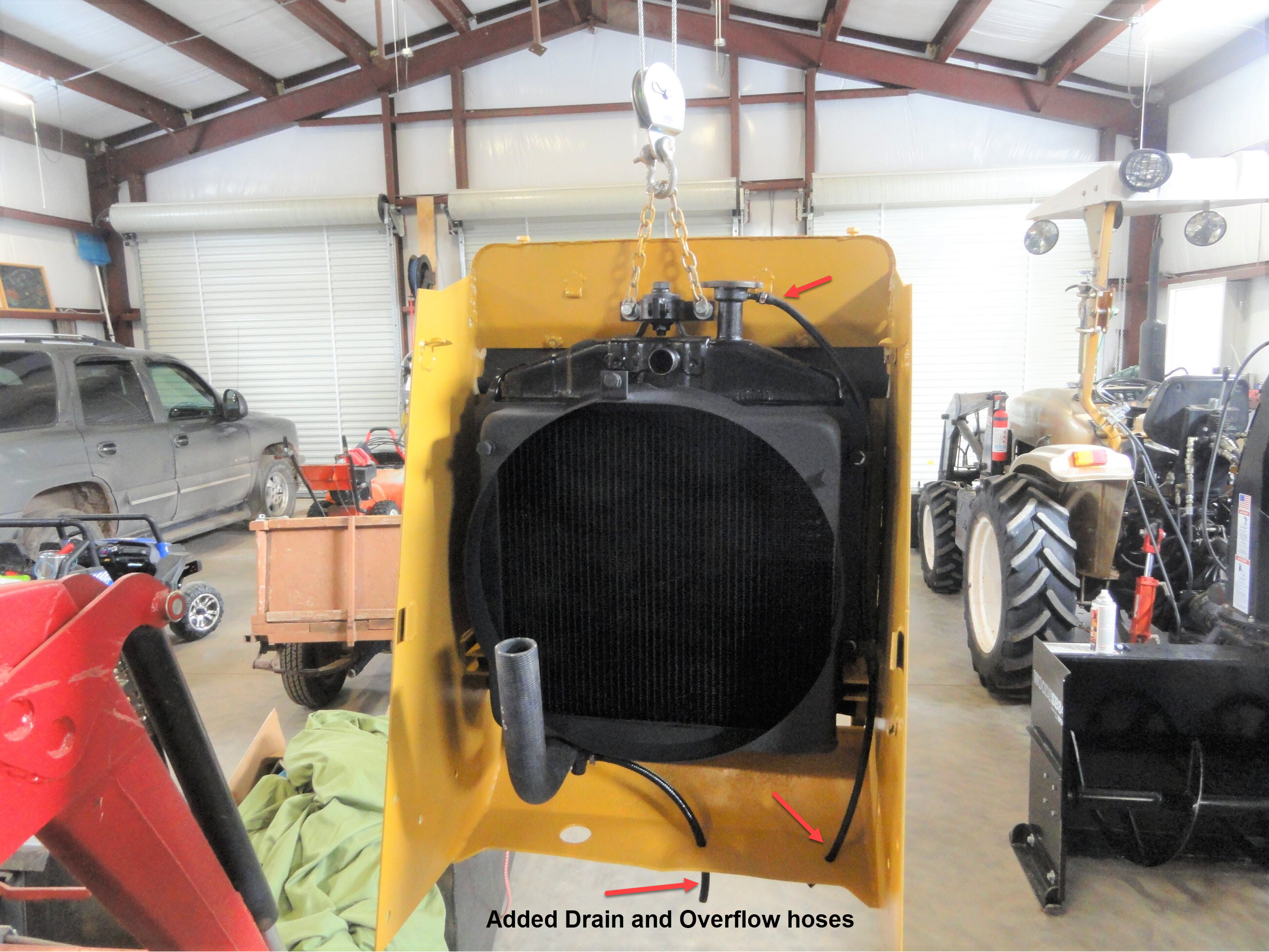

Radiator reattached to front cowling, got it all hooked back up to the winch cable and hanging off the scissors lift. Ready to be moved into position and bolt back on. Between the scissors lift and winch I was able to get all 8 bolts perfectly lined up and threaded in by hand, Man I'm good, okay really lucky. Installed the hydraulic fluid heat exchanger tube assembly, connected the hoses, now ready to attach the front grille. Front grill installed, now ready to move onto the hood and muffler restoration. Oh and last pic sanded and repainted the engine oil pan skid plate.

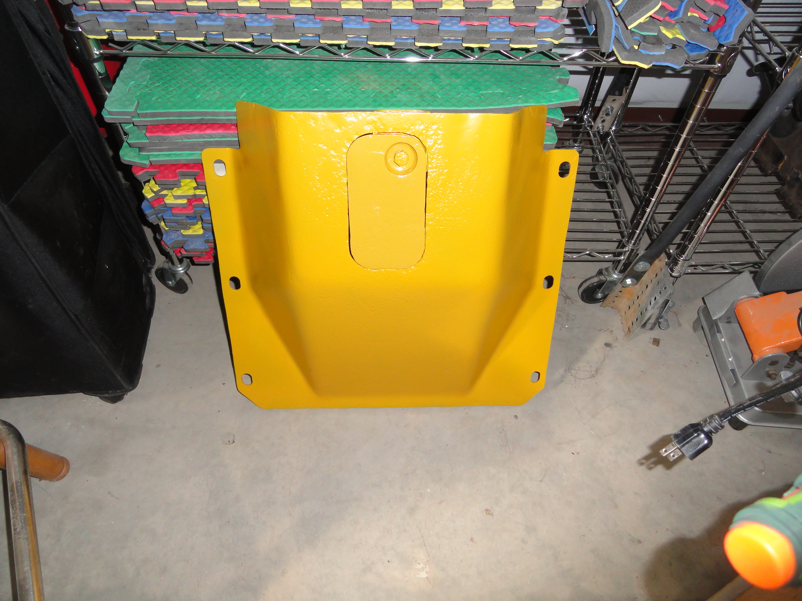

Underside of the hood was a bit of a rust bucket, so it got sanded and painted with a good matching finish coat. Its too darn cold to paint any more. It has been in the single digits early in the mornings then teens in the afternoons. Should I give the entire dozer a paint job when it warms up then enter it into the pinto bean fiesta parade down main street? In the last pic you might notice my supervisor pleased with the results while at the same time keeping my ride back to the house warm and cozy, what a good boy. He is the best Junk Yard guard dog we have ever had, he is always looking for trouble.
That is it for tonight, must get some much needed shut eye.
