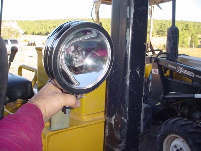

I was reviewing this thread and discovered I did not document the install of some ammo boxes or the rear view mirrors. You all probably saw them in various action shots? I thought I would post a few pics to show the detail on how they were mounted. First the ammo boxes:
When Rob (3RRL) & Loretta came to visit, I took them to Surplus City in Albuquerque, a huge surplus store with just about everything you could imagine. While they were browsing around, I picked up a couple of ammo boxes and some mirrors for the Dozer.
Rob helped me layout the holes to be drilled in the bottom of the boxes for mounting. After we drilled them out and checked for fit, They got primed and painted with a close matching Komatsu Dozer yellow. There is a plate with tapped holes underneath the boxes. Those plates were for the OEM canopy that at one time was removed and replaced with a very beefy aftermarket ROPS, so those tapped plates were just the place to mount the boxes. In them I store, gloves, sunglasses, gate remote, coffee thermos & bottled water etc. They are pretty handy as they can be opened and accessed while sitting on the dozer or standing besides it.
Larry
/ Komatsu D20A-6 ?
#119
These 8" convex mirrors are a great addition to any Dozer or tractor. They sure do come in handy when backing up. I've been using the dozer to haul around a dump trailer, with some practice, I have learned to use them efficiently. For the most part I no longer have to turn around to look when while backing up. The is no vibration in the image so the view is clear and large enough for ease of use. With a quick glance I can see what is just about to get flattened by running over it back wards. They were attached to the top hand rail mounting bolt.
