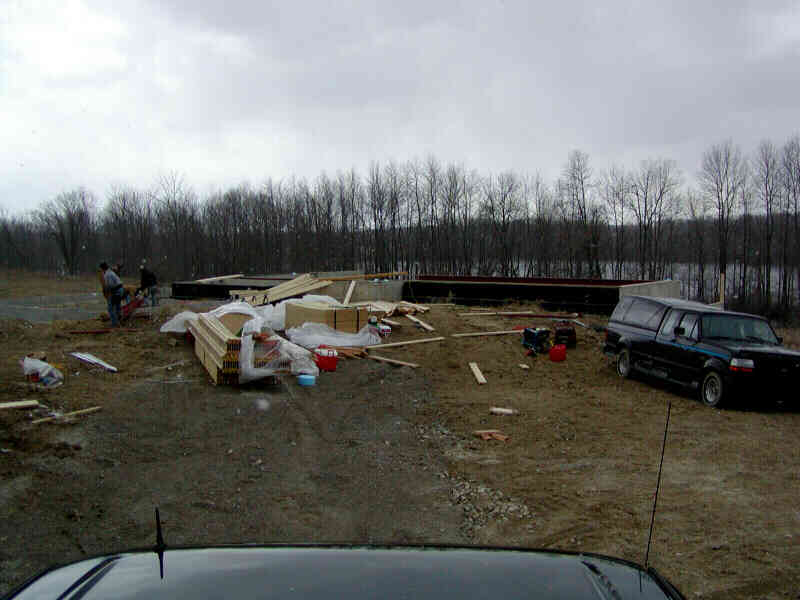

It has taken a month (since I started this thread with pics of the basement wall being poured) and we're finally starting something new. The rough carpenter crew was setting the beams over the basement yesterday. I hope they don't hurt themselves - the one beam they have up already is a 40 ft long I beam, and four guys did it manually.

/ Knotwyrk Farm #26
Chris, that scene looks mighty familiar. We must be near the same point in construction. Was the beam you mentioned steel? If so, I'm surprised they didn't need a crane. We've got a number of beams waiting for joists to be laid across. Beams are all built up from 2X12 dimensional lumber.

I started out in the am with a lighter jacket on, 45 degrees. Early afternoon at the jobsite it was 15 degrees and blowing. Darn it, I should have worn a warmer coat and hat - I didn't stay long.
The beams are steel. We upgraded a bit to larger steel beams and engineered wooden floor joists to decrease the number of posts in the basement, and to make a stiffer floor. The floor joists are "AllJoist" by Boise Cascade.

We talked about I-joists instead of dimensional lumber. It came down to price since it didn't solve any span issues for us.

Great to hear that things are moving along for you. We went with dimensional beam & I-joists to eliminate poles also.

About the only difference then is that the dimension 2x12's will shrink in width about 3/8" to 1/2" over time, when they dry out. The wood I-joists do not have this dimension change. The change in width is not a problem if figured into the design.
