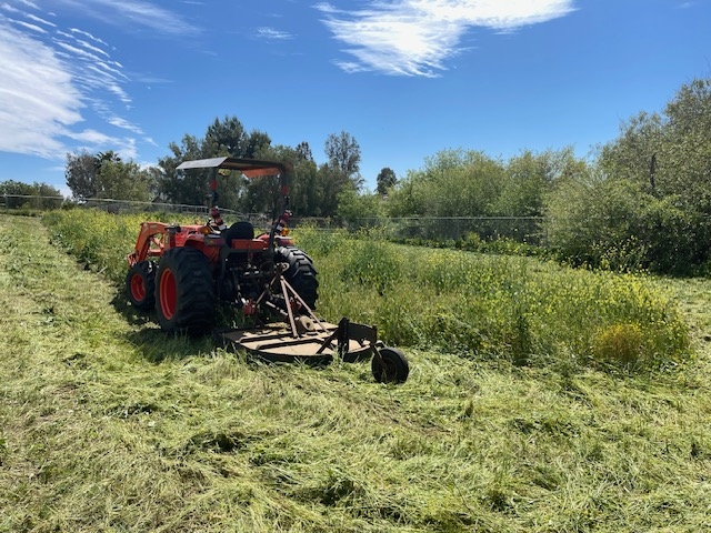

How ya liking the chain mower?
I like the chain mower where I'm rough mowing an overgrown field or where I'm mowing an unknown field where I don't want to find rocks and debris with blades. I did a little thread on it. It started with an old free mower and an inspiration from reading TBN posts from abroad.
