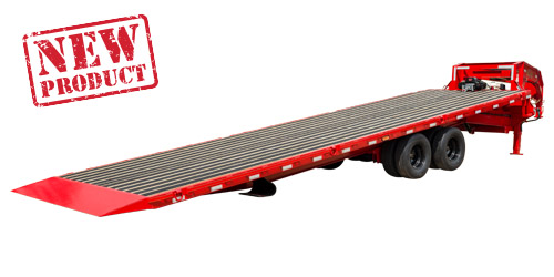

I'm looking at building a 26-28' lowboy gooseneck trailer and have never seen a kneeling gooseneck, originally I wanted tilt deck but that has its drawbacks and a fixed deck with air suspension would allow it to drop to loading level without steepness of a tilt and load multiple items more easily.
Ideally I would use 8000# axle less suspension but so far the closest I have found is timbren 7000#

I had to do a image search to find out what a "kneeling trailer" was:
   / Kneeling gooseneck, has anyone built one?
Xfaxman that's it, but on a larger scale!
It looks like the link I prvoided was something else but they do offer an air ride

You can also go for a drop tail: use heavy duty rigid axles with air suspension, drop that till the tires allmost hit the lower side of the deck, and then release two additional air bags that drop the bed behind the axles till the light beam on the rear of the bed lies on the ground. Then you only need a three foot foldable ramp to create a very low angle, suitable for anything from forklifts to Ferraris

It's fairly straightforward if the width of the bed is less than 76" (low boy gooseneck). Drop deck trailers are available.
Safely load a motorcycle onto a trailer - Drop-deck, non-tilting trailers by Airtow - YouTube
You could modify this design for your use.
If your gooseneck is full legal width (102"), then a tilt bed is you best option.
