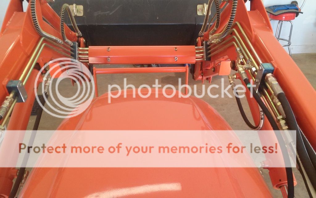

[Took some pics and measurements today, it appears mine is 1/4" lower on the right side. I'll probably start a new thread in reference to ck2510 owners but wanted to post here first. Do y'all think that is enough difference to contact my dealer and try and get resolved? I'm like others , OCD lol
If you work your loader a bunch of times and then bring it down to a level surface the bucket edge SHOULD touch down evenly. If it doesn't then, yes, there's an issue. If you don't find this acceptable then bring it to your dealer's attention. Interesting that this is also showing up on the right side of the loader as with mine and bgruss75's loaders.

Twisting or tweaking the FEL due to operator error or exceeding the capacity happens. Generally an incident like this is human error and not equipment failure. I've learned over the years that when a piece of equipment fails it's usually 90% operator and 10% equipment. Now to the point of this thread, which is the KL6010 FEL being uneven off the delivery truck; I have the same issue as the OP. My dealer has contacted the NC headquarters and their engineers have asked for a matrix of measurements to be taken. I'll be relinquishing my tractor on Monday for the to do this in their shop.
For those scratching their heads, I am absolutely not new to tractors. I did not use the FEL to doze anything. I did not catch the edge on an immovable object. My FEL came of the trailer with this issue to the point I cannot backdrag any material evenly on a level surface. Once I hear what the dealer says, I'll happily convey the information on this thread.
This pic shows the unevenness of my FEL as it rests on the ground.
/ KL6010 - uneven loader arms #39
That is pretty definitive. Something is definitively off.
