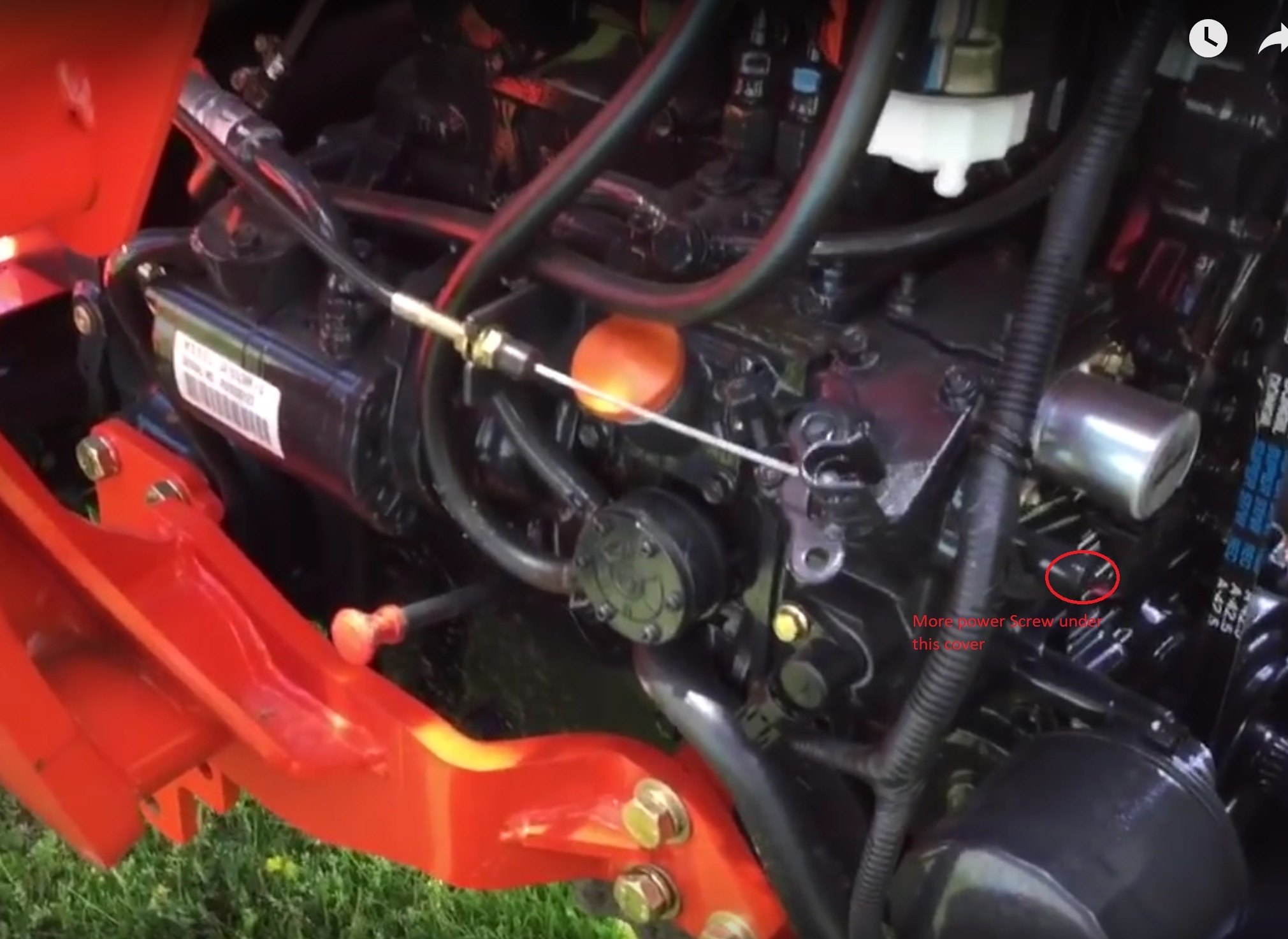

See picture
Remove cover screw in 2 turns test machine and under heavy load look for black smoke, if none turn up more. Once you get to the point where you see black smoke under heavy load back off the screw 1/2 to 1 turn. Best way is to use a dyno for an accurate measurement. Good video on it here.
Turning Up the Fuel on a Diesel Turbo Charged Tractor New Holland TL-90 by Everything Attachments - YouTube
