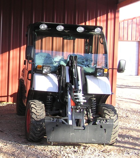

Hello, just askin if there's a kit to change manual locks on a quick change bobcat hookup, front high lift to change from bucket to forks using small cylinders to unlock and lock. Thanks.

I don't know of a kit to change the manual lock levers to a hydraulic lock setup. I could see where that would be handy if one has a disability, handicap or hard time operating the levers by hand. I'm also sure that even if there is no kit available a hydraulic device could be built that could serve that purpose.
As far as I know the Bobcat Advantage system is only available on Bobcat.

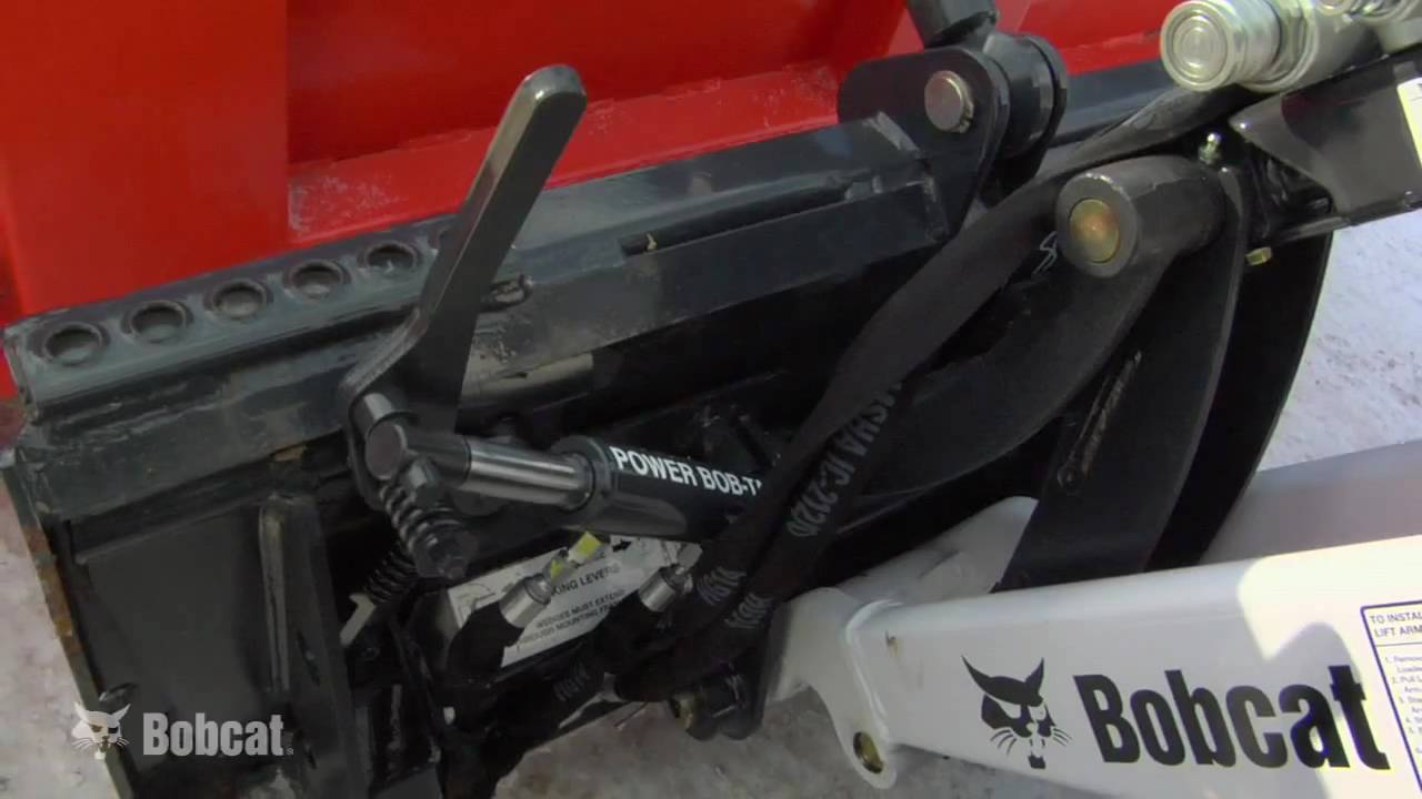

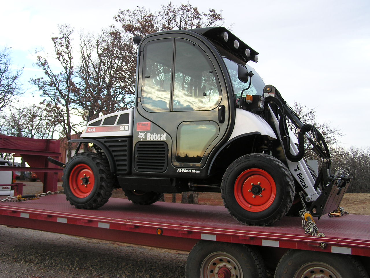

It was an option on Toolcats, think it is standard now. It is called Power Bob-Tach. You might be able to find the parts on eBay or call some Bobcat dealers. They also have a single cylinder version for skid steers.
