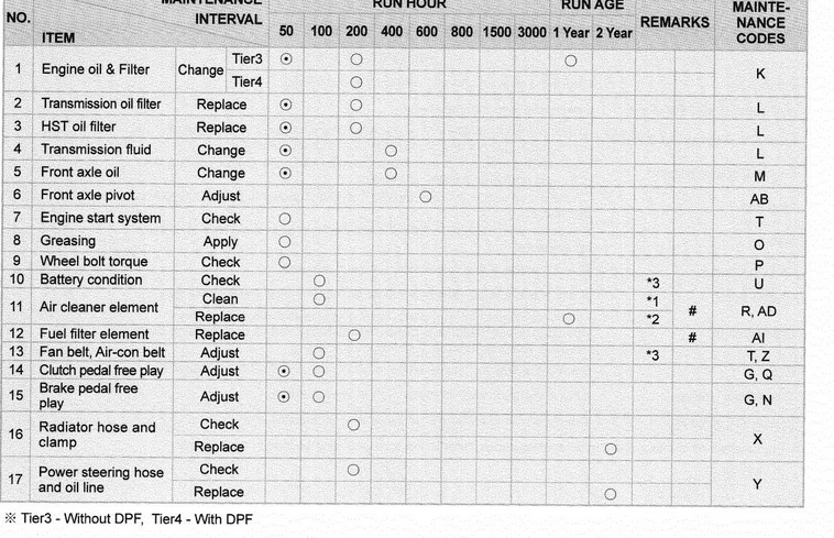

My manual states change the front axle oil at 50 hours. As well as transmission oil filter, HST oil filter, transmission fluid. Then the normal check clutch pedal (doesn't apply to me), and check brake pedal play.
I'm with you that it's odd it does want the oil changed at 50 hours on Tier4 engines, but does for Tier3. I'm currently ~33 hours on my 5010, but I can assure you I'll be changing engine oil/filter when I do the rest at 50 hours.

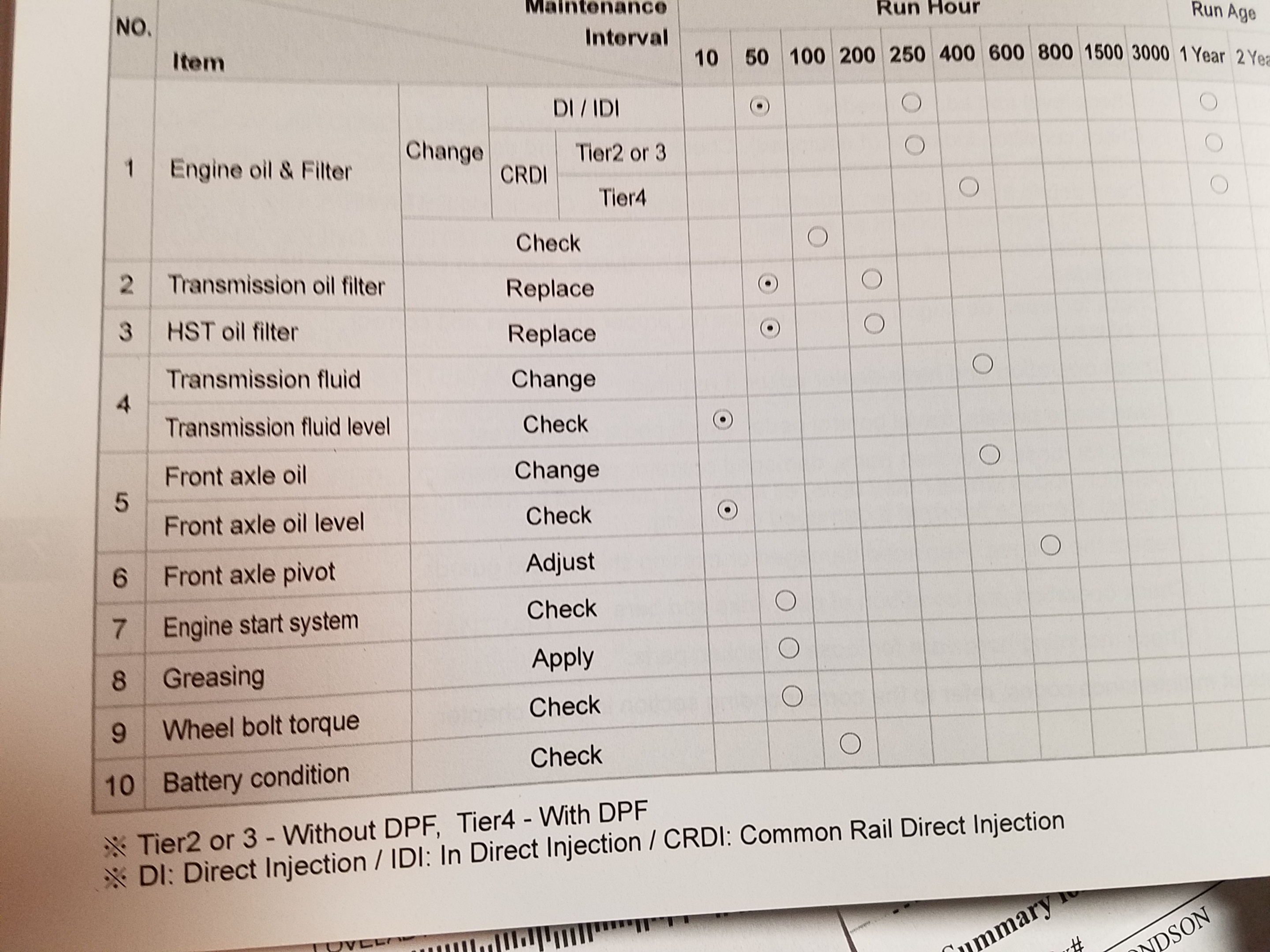

My manual just says to check the front axle and to only change the hydraulic filters, not the fluid. My manual has "Date of editing" on the outside back cover of Jul 2018 (white block with bar code at lower right corner).

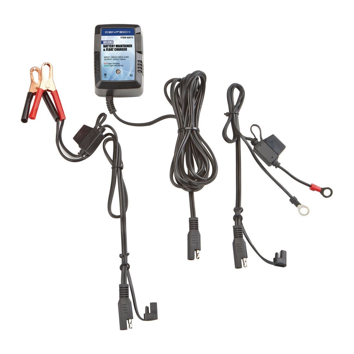

In two months, I'll begin my seventh year with the OEM battery in my 2014 NX4510HST cab. :eek:
I do keep the tractor garaged, so no extremely cold starts, and for the last five years I plug it into a HF "deluxe" trickle charger when not in use.
