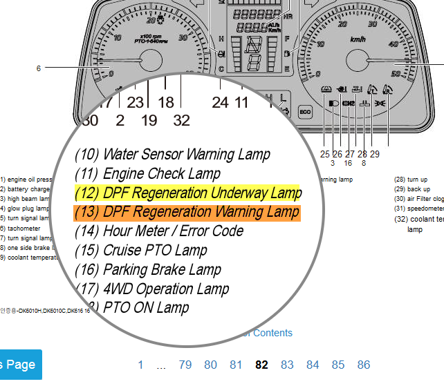

The instructions in the manual are confusing at best, misleading at worse. I originally read that to mean that when the "regen light" came on I was to follow those steps. I was fortunate to see better descriptions of these lamps on this forum. There are actually two "regen" lights... the "underway" lamp and the "warning" lamp. The manual does not clearly instruct you to just keep working with the first which is more of an "FYI" indicator. You are supposed to keep RPMs at ~PTO speed until it is finished. The operator can cancel the passive regen if it is not a good time to do it. I have made the decision to always make time to let it run. That section of the manual does not address the "underway" lamp, it jumps straight to the "warning". The "warning" (as I understand it) would mostly occur if for some reason the passive regens were summarily cancelled or did not keep the DPF clean for some reason.
