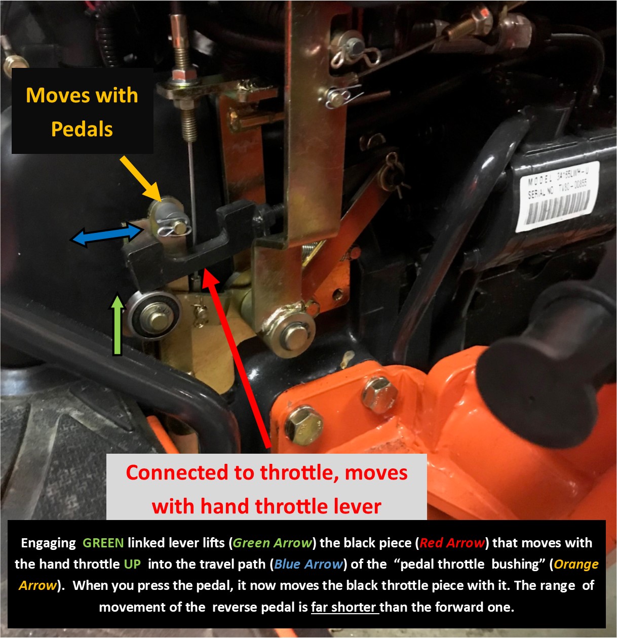

What I do when doing a lot of loader work with the linked pedals I bump the hand throttle up to around 1900 which is close to matching the forward pedal when you use reverse.
/ kioti linked pedal #22
Thanks Nick! That's most likely more help than we would get from the dealer. Do you know what your max RPM's is when using the linked pedals in reverse? My son said his maxes out at 2550 in forward with the linked pedals and using the hand throttle.
I checked tonight, With the hand throttle at idle I get 2600rpm with the forward pedal, and 1800 with reverse.

To Mike Gibson's point, the hand throttle on the 2610 has little effect on the linked pedal since it's completely mechanical. BUT, I think you could adjust the linked setup to operate at higher than idle RPM's. In other words, adjust the black sliding piece to so that it engages at a higher RPM, giving you full travel from the higher RPM setting on up. Downside would be, it would hit the throttle linkage if you tried to engage the linked throttle pedal when the tractor was idling.

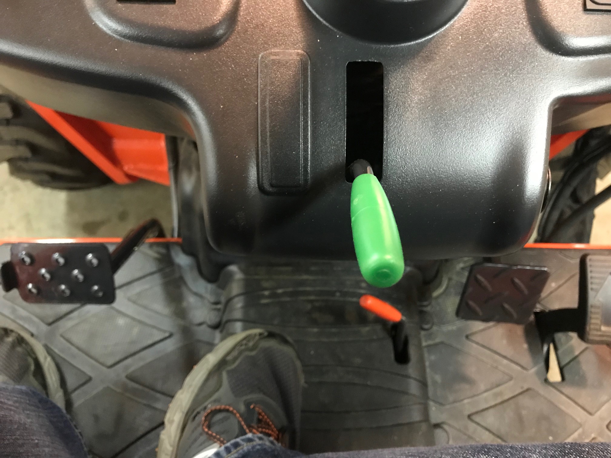

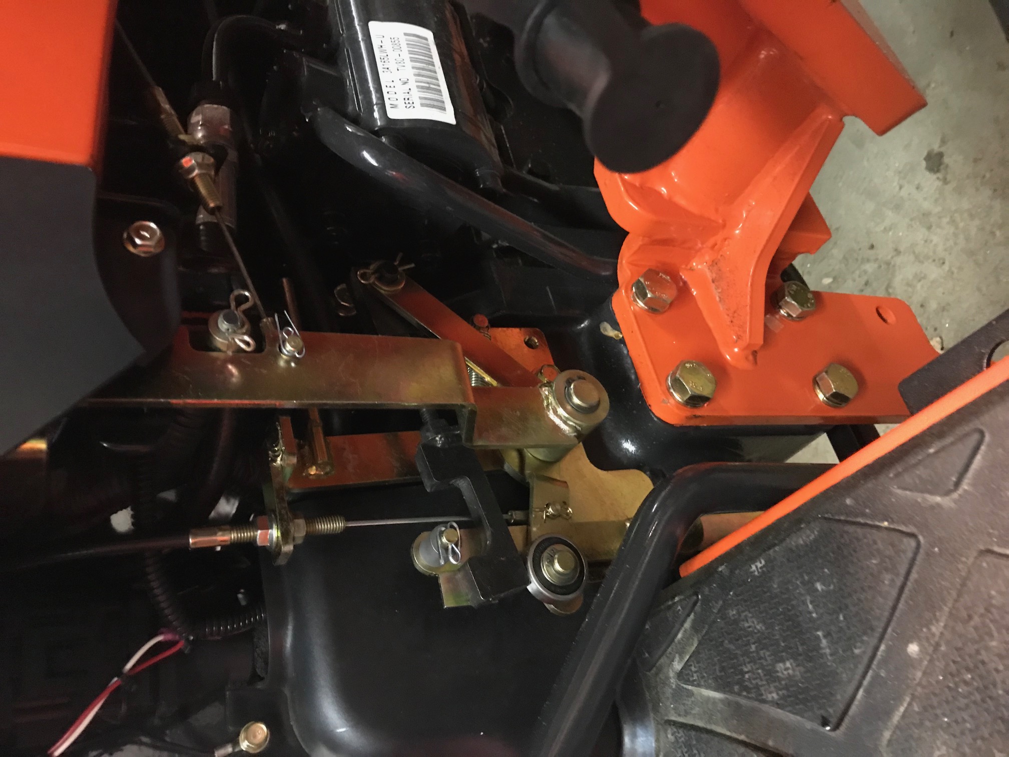

I have the bobcat twin of the ck2610, dealer installed the linked pedal kit but when I flip the lever up it just flops back down, so it won't stay engaged. They came out to look at it again and don't have a clue. Any ideas what they did wrong?

alittle off subject sorry but I bent my throttle linkage ears some , the foward and reverse. I straightened them out best I could from under the tractor, it just seems that I don't have full travel on the linkage now resulting in not having full power, if that makes sense? Thanks 2012 dk40hst

my linked pedal is the brakes. There are brake pedals tied together with a link that can be disconnected so they can be operated separately.
