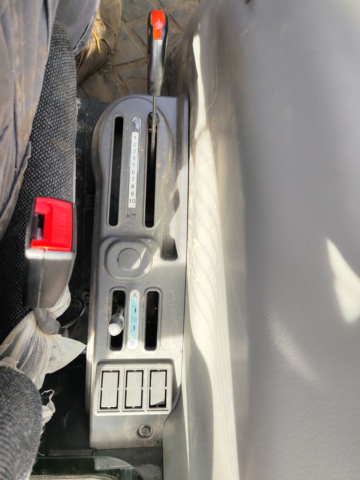

Kioti DK6010 3pt not going up or down.
   / Kioti DK6010 3pt not going up or down. #11
That should be your standard rear remote that comes on that tractor. Make sure the rear remote lever isn’t stuck in the detent position. Work the lever briskly to pop it out of detent and leave it in center neutral position
   / Kioti DK6010 3pt not going up or down. #12
Does Kioti use the remotes to feed the backhoe? That should be an easy fix.
#13
Yes they do. That's where my backhoe hoses were attached
#14

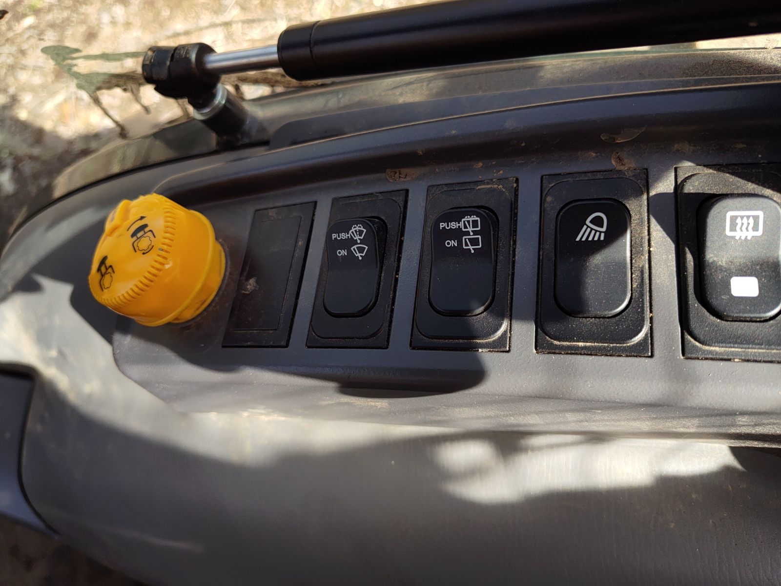

These are my three point hitch controls. The yellow knob is what I use for the PTO
   / Kioti DK6010 3pt not going up or down. #16
That was it. It wasn't in neutral. Thanks so much for all the help everyone!
Ok, that's what I was trying to understand. If they used the remotes or a loop with hoses instead. Either way, easy fix. 👍
