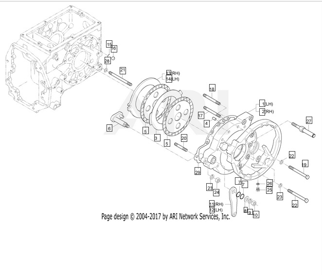

Ran my tractor today and all of the sudden no left brake. Pedal goes to floor with no resistance. WTH?

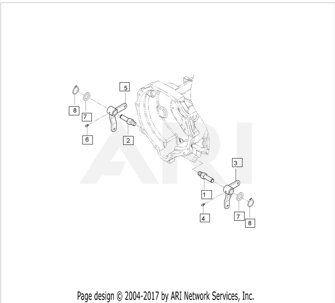

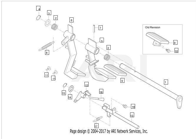

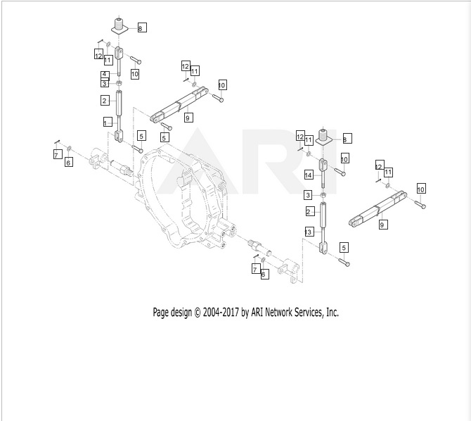

Sorry, got late on me yesterday and didn't respond earlier. So, just to be clear, all the linkages for the left brake are moving nice and free from the left brake pedal up to the arm that then enters into the rear end housing, right?
Took some screenshots of the Michigan Iron parts website. Hopefully it helps a little bit diagnosing this issue.
If the linkage is all moving all the way from the pedals to the arm #11 on the 4th picture, then the issue may be internal and a lot more expensive.

That is correct about linkage. Just don't understand how it was working when i unloaded it from trailer, parked for 5 months and now left brake doesn't work. Might be better to sell at a very discounted price and look for another tractor. Thanks for the info

I would look closely at the nuts holding the lever on the brake actuator shaft. I circled the nuts in red and the shaft in blue.
If the nuts are loose then it is possible for that lever to not engage the square part on the shaft. That would just let the lever rotate on the shaft instead of rotating the shaft.
/ Kioti dk40 No left brake #11
Selling the tractor at a discounted price? No! That's quite an extreme measure and a real gift from the heavens for whoever buys it. You have a great tractor and as far as I know, emissions free as well.
Even if the problem is internal, it's still not an huge job. It's basically pulling the left axle housing but that's just if we can't find the problem. Check what K5 said first. The lever could indeed be just spinning on top of the shaft instead of actually rotating it.

Fixed it guys!!! Turned out to be the linkage out of wack.Thanks for all of yall's input and knowledge.
