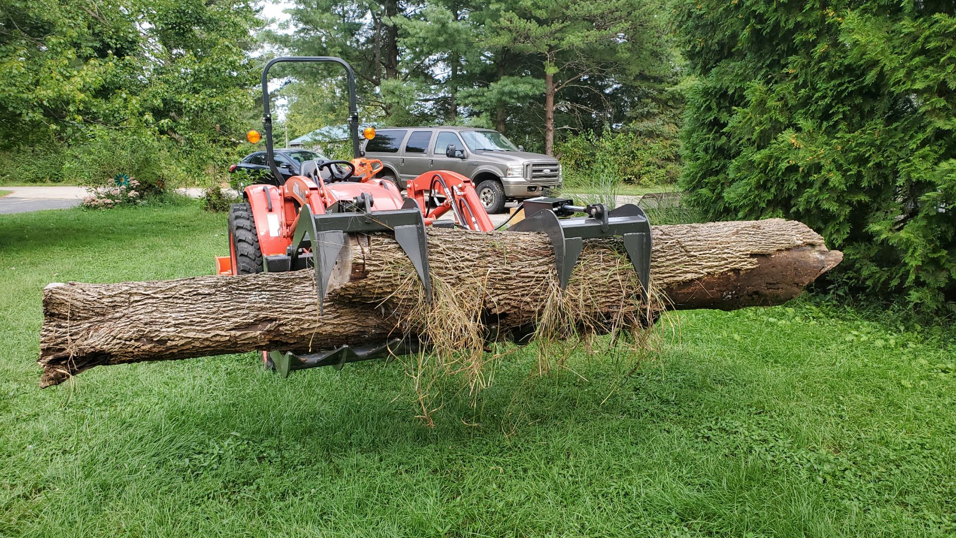

Dk4710SE grappling an ash deadfall
/ Kioti DK model Comparisons #15
I need another 500 lbs of ballast then in could pick up more.
