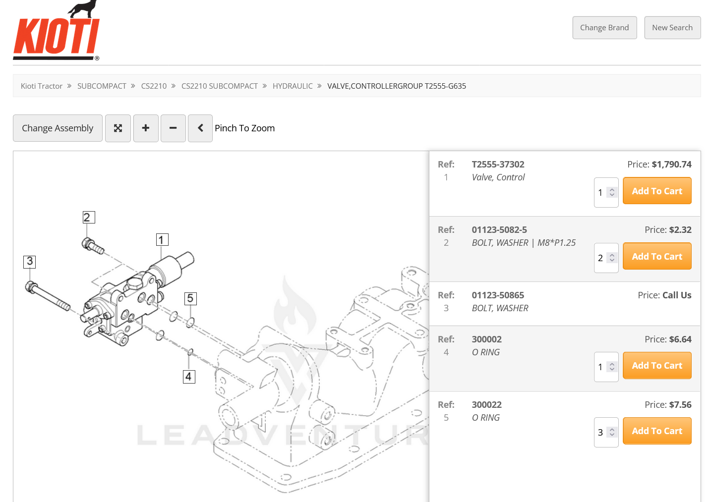

Priority valve is acting up. It screws in the side of the hydraulic block.
That would be my guess too, unless you have a kinked hose to the steering valve (4 hoses go to it I believe).
When steering is stiff and noisy, how do the FEL hydraulics behave? One pump integrated into the transaxle is shared by all the hydraulics on the machine.
/ Kioti CS2220 Steering #6
Based on the price tag for a new valve, plus installation........I hope, for your sake, that it is something simpler.
We all know nothing is cheap in terms of OEM tractor parts, but if you totalled up the priority valve, the control valve, hoses, cylinder and other associated bits and pieces, it would probably add up to half the price of the tractor! It really is discouraging.
