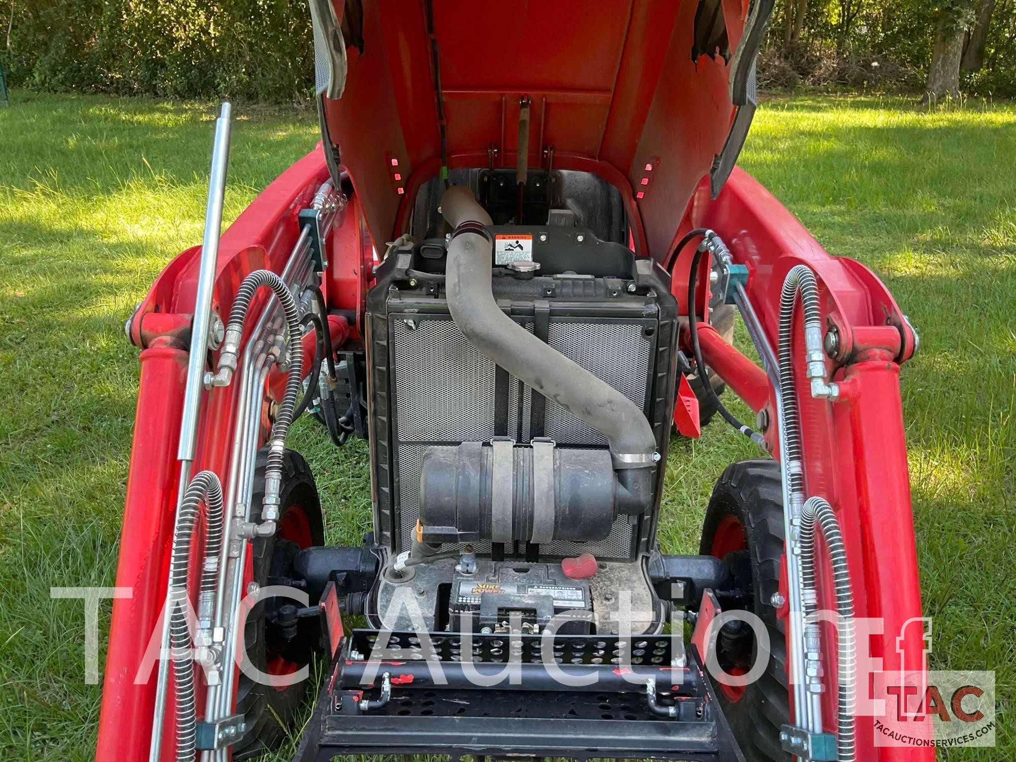

I believe this is the style your tractor has, right? Leaving this picture for reference.
Does the yellow piece pull out? Have you tried pull it out and rotate the black cover left or right?
   / Kioti CK2610HST
Yes that's it!! I did try pulling on it but not too hard cause I wasn't sure it was the right thing to do. I just went out again and pulled real hard towards the right side of the tractor and was able to open it! Unfortunately I was sold the wrong air filter so I'll have to order a new one, but it will be easy next time. Thank you so much for your help!
