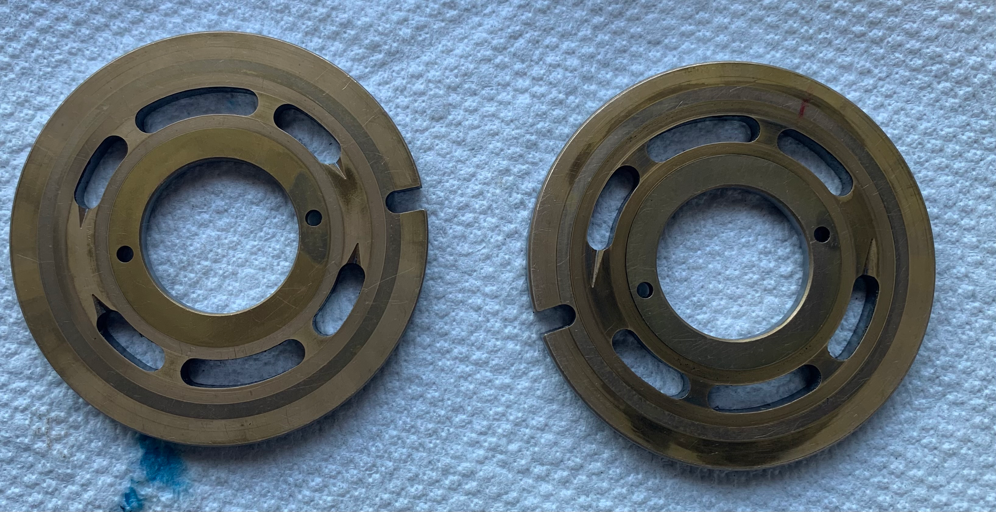

RE: Transmission Pump/Motor Plates.
Can someone tell me which is the Pump plate? Both look the same except one has 2 fluid passages and the other has 4
Any help would be appreciated
Rick

Did you try michiganiron site. Look up parts diagram. Than try and get photo of both parts.

I purchased the same service exploded view/parts list manual as what they have on their parts finder. I also bought a service manual and neither one give the identification or orientation of the valve plates. I did text, emailed Michigan Iron and waiting for a reply. This tractor has so many serial number part breaks that when you order one part, you have to order another part to make it work. Then order another to make the second part work. I’m replacing the main shaft, pump shaft, main coupler, bearings, prongs, e and c clips in the transmission this time around. Previously I have rebuilt/replaced the front differential, clutch pressure plate/disc (2), glow plugs, multiple relays to name a few.

I looked at parts breakdown that I have for Rexroth hydrostatic pump and motor. it showed having two fishtails per side on the port plate for the pump and one per side on the motor.
I am not positive Kioti is the same design though.
