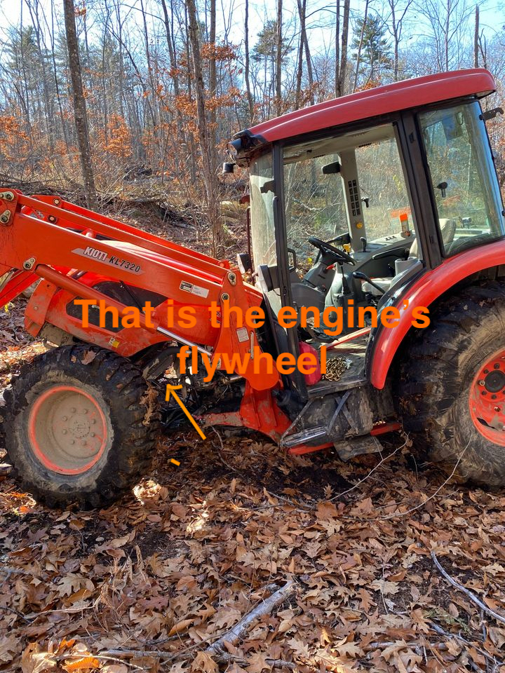

Did the transmission bell housing break? I can't tell from the pics but the loader appears to still be in place. Looks Iike just the front frame section broke taking the front end with it.

When I looked at the photos the other night, it looked like the bell housing sheering off the rear of the engine as/after the lower subframe front axle mount failed at the bend that holds the plate that bolts the front axle. With better photos, we may see that the actual failure is at the bolt line similar to the rear, lower-link stays on my tractor in the video I posted.
The only breakage i can see appears to be the frame forward of the engine, why do you think there is a failure behind the engine/bell housing area?

Every warranty department is itching for ways to deny warranties, but if we carefully examined the steering knuckles, pivot, and wheel bearings on the front axle and found everything to be in spec and tight, with only the frame broken, it would be tough to claim the user abused the tractor. Especially if we examine the cracked frame and find that it had been failing over a period of time like what I showed in the broken lower link stays on my tractor where at least five distinct layers of cracks happened before it let loose.

Look at the rear of the engine just below the loader lift arm. That appears to be the flywheel. From this, I conclude the bell housing sheered off after as/with the frame failure.
That said it'd be great to have better photos—especially detailing the actual cracks and any other failure points.

If you look ahead of that were the daylight is shining thru the front of the engine compartment
that looks like the engine fan in the correct position and angle.
And also under the loader arms there is a cylinder that looks like it could be the starter in the proper orientation.
/ Kioti Broken in Half #271
Not seeing it.
On my 27" iMac I can see the teeth of the ring gear on the flywheel.
Also notice that the owner is so AR, that he has a can of Kioti orange spray paint in the cab suggesting that he is taking care of things.
/ Kioti Broken in Half #274

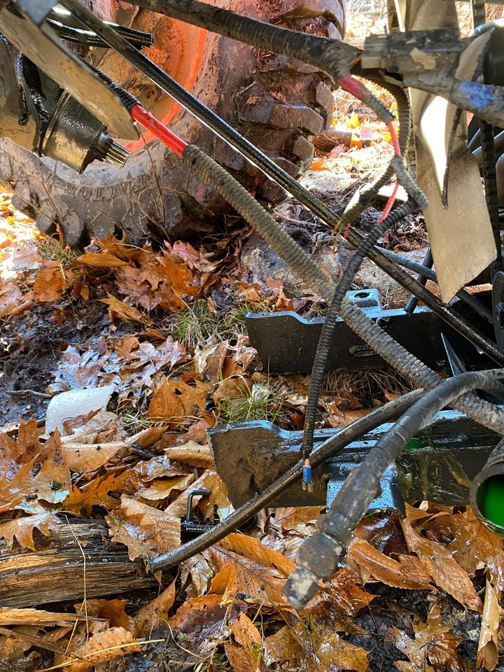

That's the front of the engine. The subframe broke right in front of the engine. Looking at the parts diagram, I suspect it broke right where they put a bent on widen the frame for the battery, radiator, etc.
I tell you what: that sure is the fan so I guess I'm all wet!
I reached out on FakeBook inviting the owner to provide us with better photos here on tractorby.net.

I don't recall much talk about ballast here. If the owner was using that monstrous grapple to the limit, traversing rough ground and had no ballast (or tire ballast which would not help here), the majority of the weight of the tractor and load was on the front axle and transferred through those sections of the frame. While the loader might have lifted the weight, the impact loads of traversing were likely too much. Could proper ballast have helped? I think theoretically, yes.
And if I were a Kioti rep - that's where I would go first.
