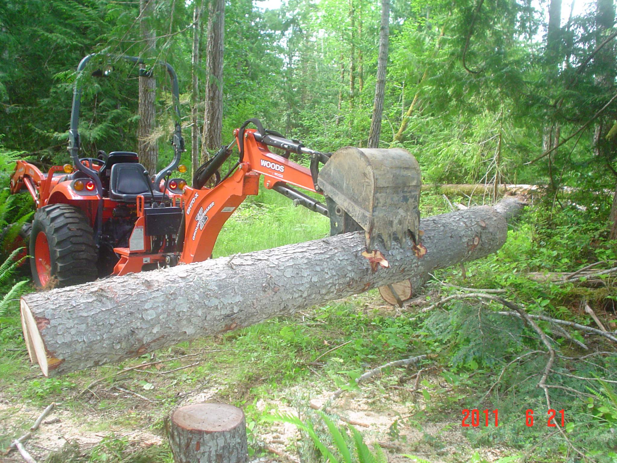

I have a Woods BH70-X backhoe on my Kioti CK35 and have been very happy with it. Liked it more than the Kioti backhoe due to it's factory 7 position thumb. :)

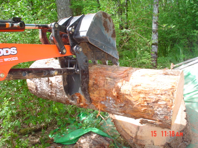

Good looking rig! On the thumb is it much trouble to adjust? When not in use how is it kept out of the way? I never gave one a thought but it sure looks very useful. :thumbsup:

It's easy to use and lifts all the way up when you are just digging. There are 7 positions on it so if not need the thumb basically will be parallel to the boom. In the pis you can see the holes and the pin, if you need more or less thumb that's how you adjust it. :)
