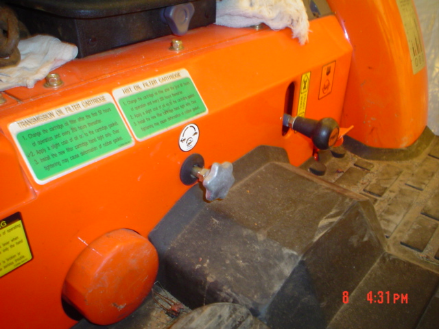

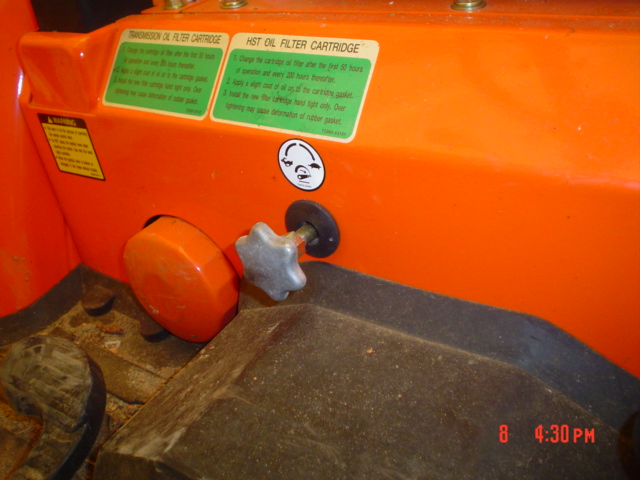

You've probably already done this, but check the 3-pt speed control knob. It could be turned all the way off.

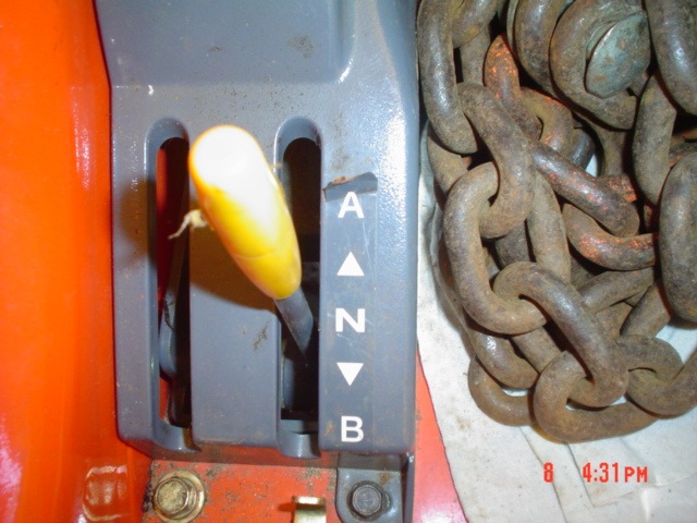

On my 2008 Kioti CK35 I have to move the lever from either A or B (backhoe) position to neutral (3pt) after removing my backhoe. As earlier mentioned you may have a turn knob that controls the speed of the 3 pt or it can be shut totally off. On mine this knob is located below the seat near were you would put your feet. Not sure of your setup but just took a few pics to help you.

I found this also, that the rear remote (which supplies pressure to the backhoe lines) must be in neutral for the 3 pt to raise.
